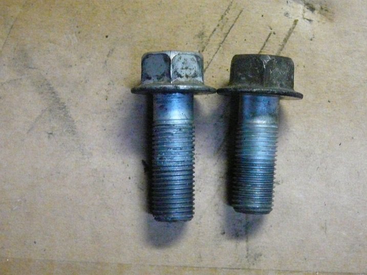

    The stock Tundra mounting bolts are definitely shorter than the Tacoma caliper bolts. I read that one guy had a problem with the Tacoma bolts bottoming out. Not everyone has this problem, though, not sure why. To be on the safe side, I used the Tundra caliper bolts that I got with the used calipers that I got from the wreckers.

    Spongy brake lines are a result of the 231mm calipers instead of the 199mm. The stock master cylinder can't handle that much fluid movement so it takes a little more pedal to get the brakes to work. I went with the 231mm and got used to the pedal after a week or so. I did wheelers synthetic lines and had to stack two thick copper washers on the nut (caliper side) along with a thin one (bolt head side) to make it so they worked with the powerstop brakes.
