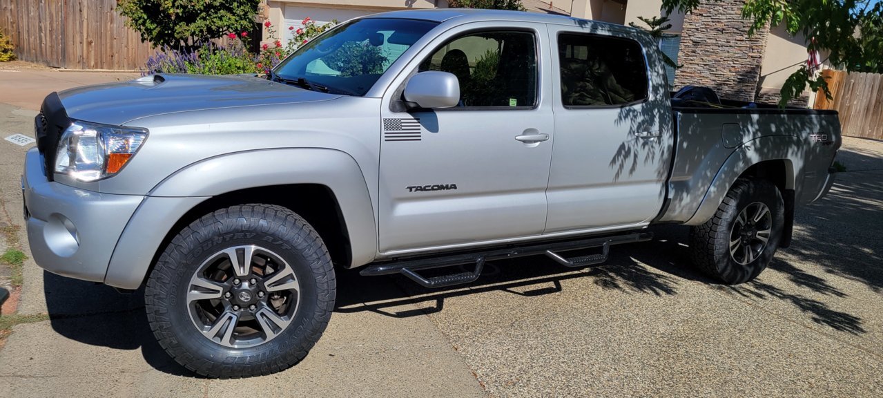

    Lift will have to wait but put my new Toyo at3 tires on today
