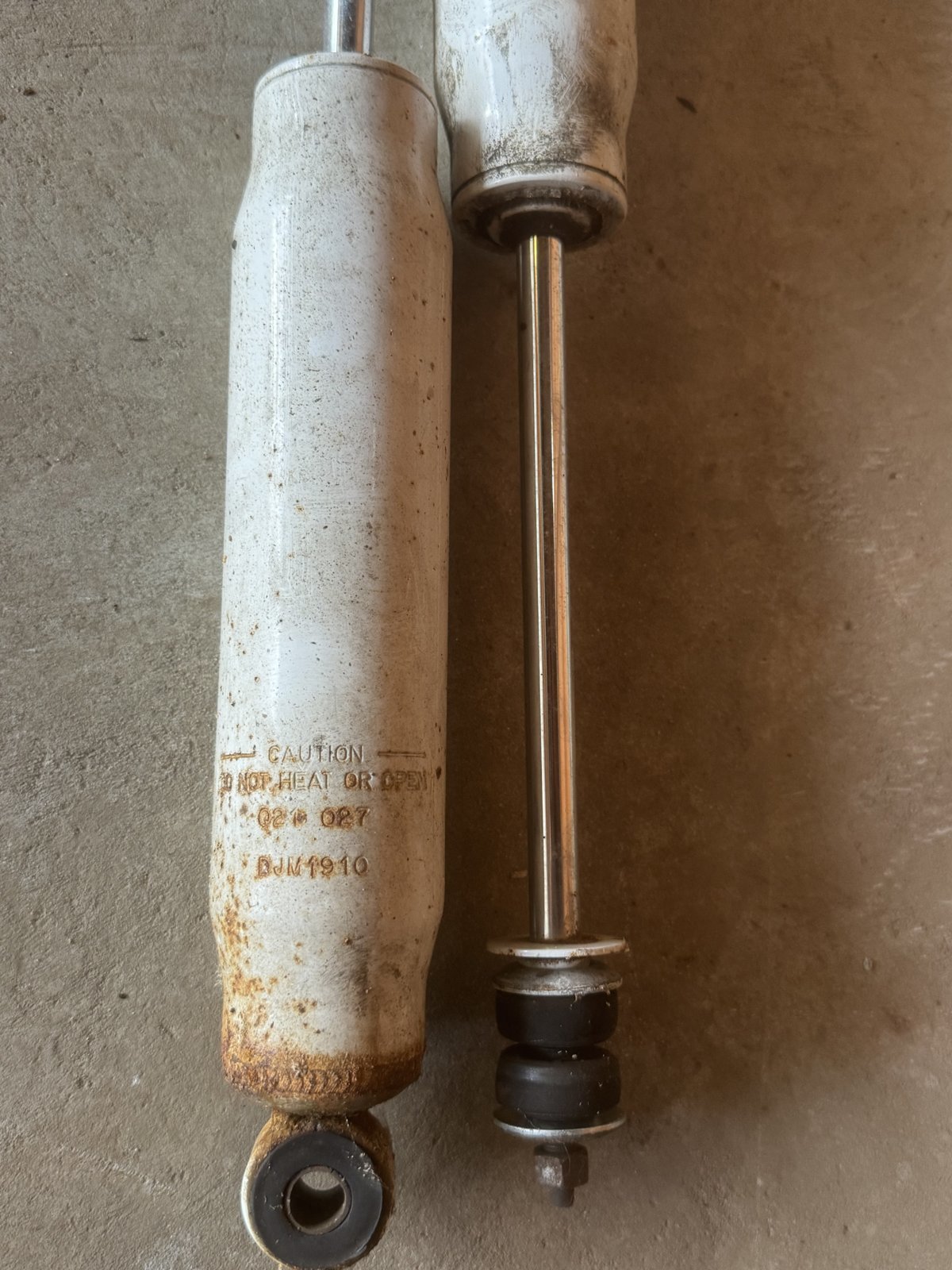

  7. Feb 24, 2024 at 8:24 AM
    nightcrawler
    nightcrawler Well-Known Member
    Apr 8, 2009
    #15733
    368
    ‘17pro
    Yes 2013 base model regular cab 2.7. What year is yours?
    The pic is the shocks that came with djm for the rear
    Fronts can stay stock, I might go back to that setup just to test out ride quality, I really can’t remember the difference

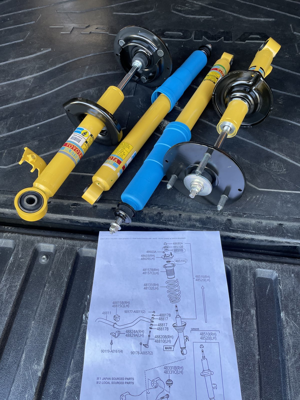

    nightcrawler
    Apr 8, 2009
    #15733
    368
    ‘17pro

  14. Mar 6, 2024 at 7:57 AM
    nightcrawler
    Apr 8, 2009
    #15733
    368
    ‘17pro
    I think you’re right, I’m now rethinking my setup. My ride is pretty stiff, like zero body roll. I also have the xbrace. So I just ordered 4600 bilsteins for the front and putting the djm shocks back on the rear.
    I’ll report back after install.
