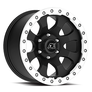

    The wheels i like are the Eagle 023, 17x9, 4.75 BS and -5 offset. But tire shop says it will rub on stock UCA's coz of the -5 offset. Is this true? I have a 3" lift.

    Uhhh, ask 'em how much backspacing and offset they think the stock wheels have?
    Or just try a more knowledgeable tire dealer.
