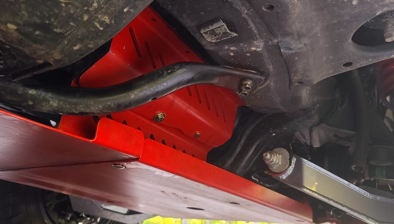

    If you already have skid plates (I have budbuilt) then you can fashion something up like I did. I used rci cat wings and used the long skid plate bolts for mine (connected the two pieces together for the angle shape). Not perfect but it looks factory and it covers the entire gap. Can't reach the bolt unless you put your entire arm in from behind the frame. Like others said....slowing them down maybe enough deterrent.
    This let's me continue to use my skid plates and have some protection to the cats.
