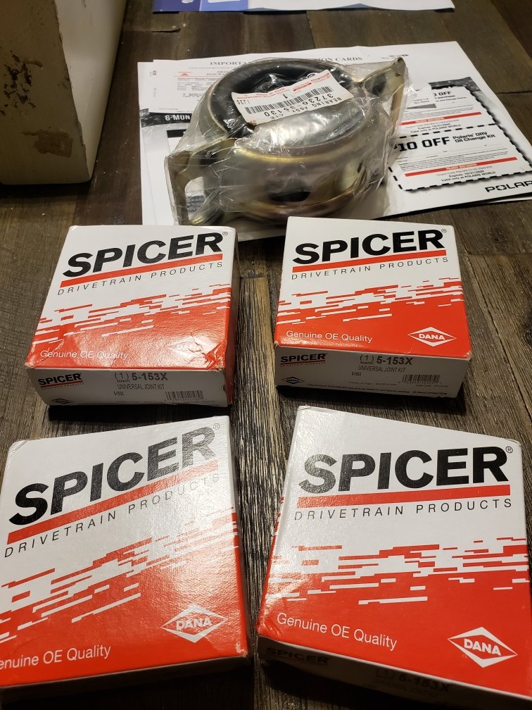

  16. Oct 27, 2020 at 2:17 PM
    #36
    Amandavei82
    Amandavei82 [OP] Member
    Mar 29, 2019
    #288382
    23
    Amanda
    2002 Toyota Tacoma TRD
    None - but hoping!
    I just wanted to thank everyone for their comments. I read them all and will not be changing anything out without the support of someone who has worked on cars. I was able to actually find an OEM part from a dealer in Miami for $113 bucks. I'll also be changing out the U joints made by Spicer, just to be safe. She is 18 years old. Again thank you for all of the input.
