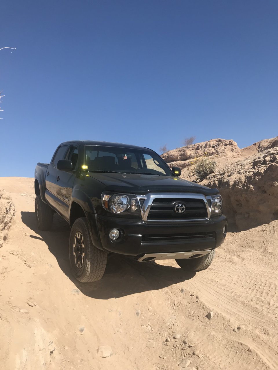

    Gonna resurrect an old thread here. Just ordered my Memorial Day 15% off $103 out the door priced Retrofit kit with the SUPER ACME H1. I went with some upgraded Morimoto h1 bulbs (my cart does not include ballasts, I have some laying around I’ll use for now). I cannot WAIT to get these AWFUL but brand new crystal clear $95 headlights of mine retrofitted. Going to be a very straightforward retrofit as the H1 should pnp into the h4 housing relatively well and easily.

    Would like to see them when you're done.
