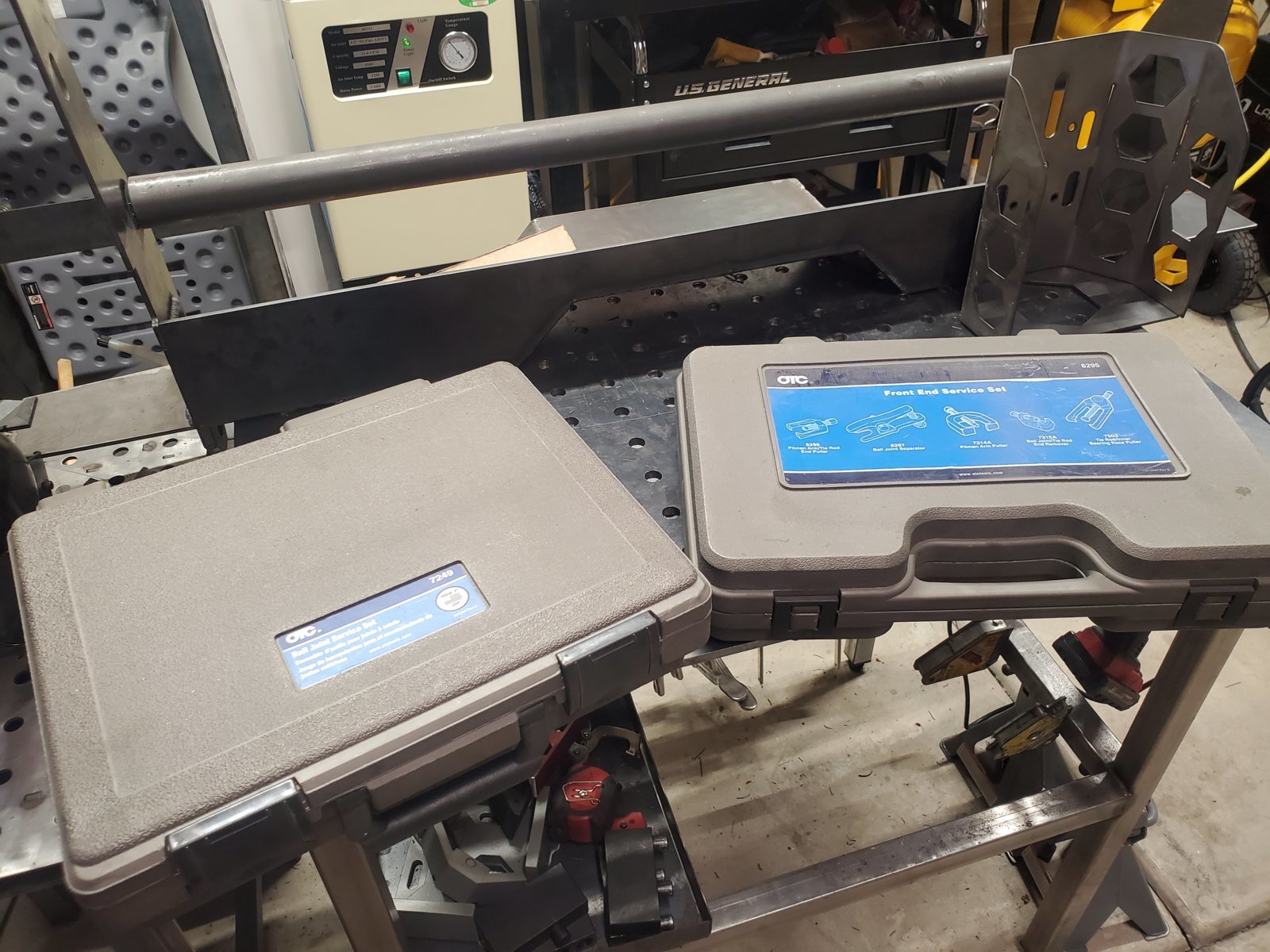

    If you're a DIYer, there's no reason to not own these sets
