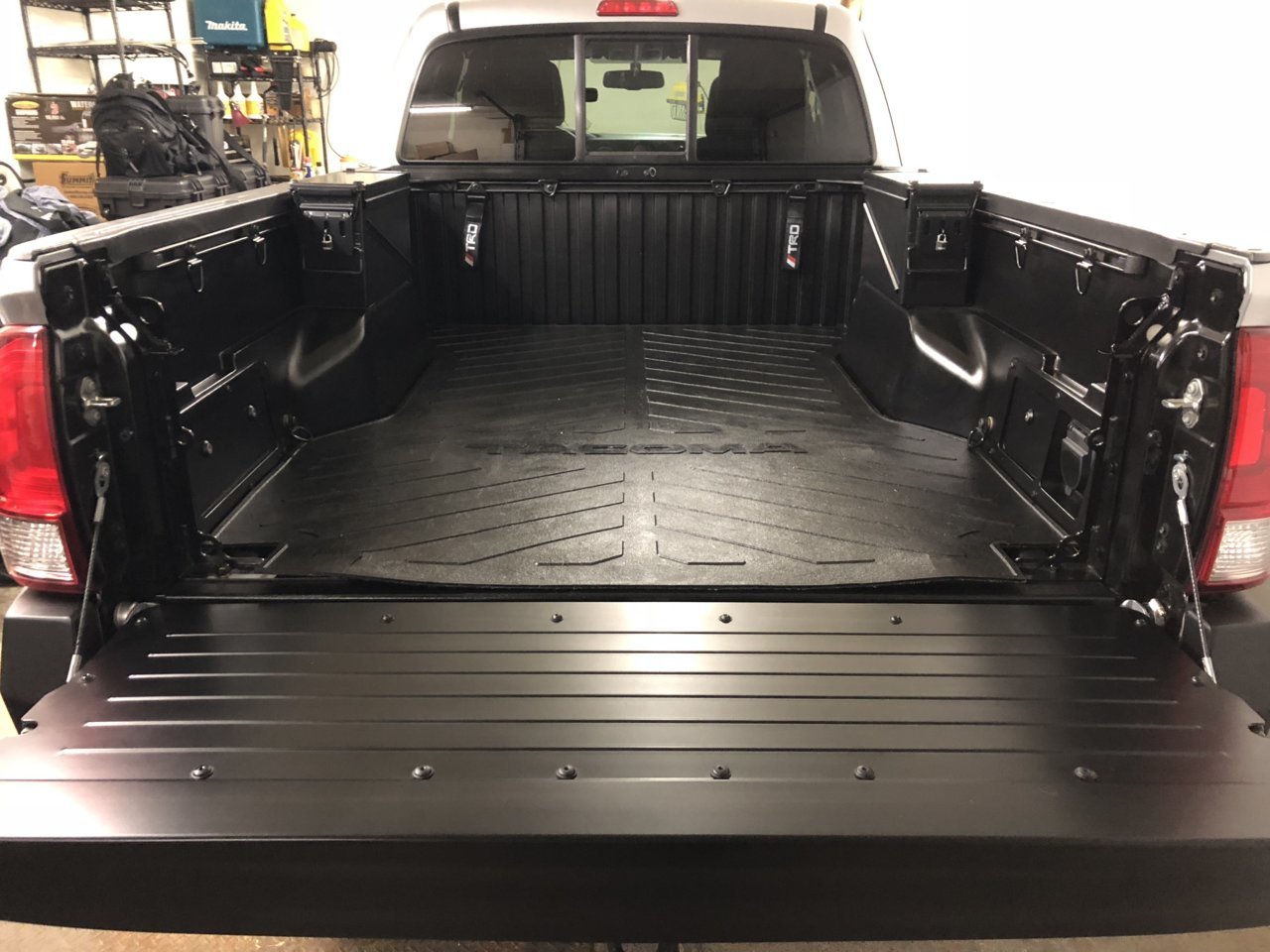

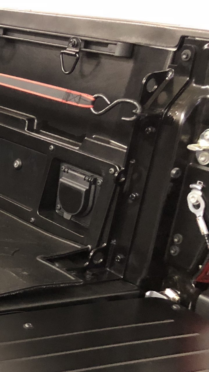

    Here are the TOTAL CHAOS Bed Stiffeners for your Tacoma
    US Patent #D820,180 S
    Toyota Tacoma - Bed Stiffeners
    • 3/16 mild steel laser cut brackets use existing factory holes. Drilling is required for installation.
    • Rear sheet metal channels crack over time. Reinforce factory rear bed channels at the tail gate that are known to tear with added camper shell weight, bed racks and off road use.
    • Ideal for any Tacoma that wants to prevent bed flex.
    • Includes all grade 8 mounting hardware and install instructions and powder coated brackets.
    • 6 eyelet tabs are designed to offer additional cargo strapping points to secure your gear during transit. An additional flat tab is also supplied to both sides to install a Buggy Whip / CB Antenna / Collision or Cargo Light.
    • No load ratings are implied.
    • US Patent #D820,180 S
    Let us know if you have any questions!

    Judging by the pics it looks like the TC ones are more flush and less likely to get in the way of sliding things in and out.
    Might have to look into these.
    Not sure there necessary but doesn't hurt to be proactive.
