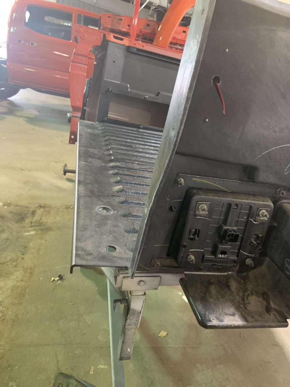

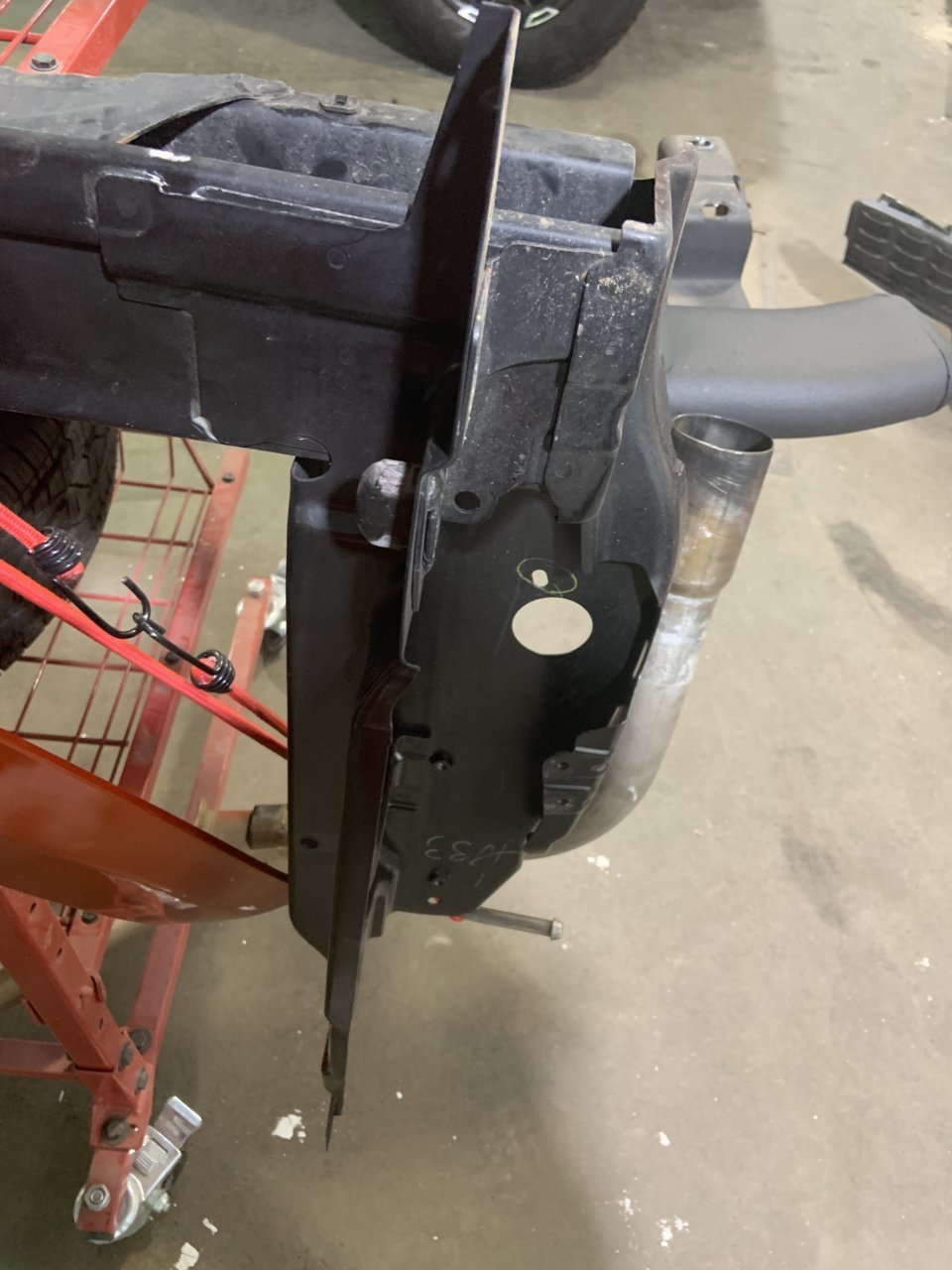

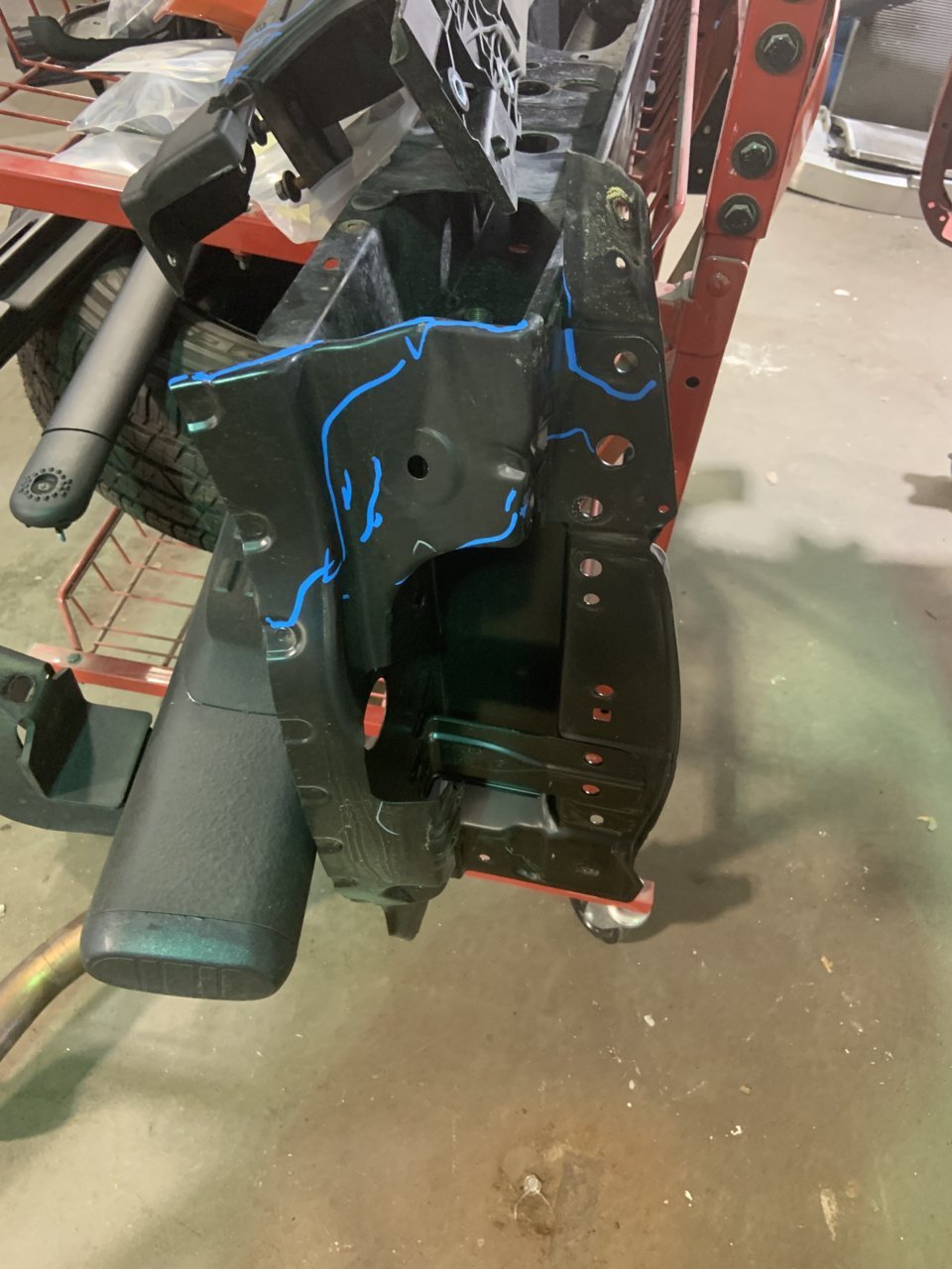

    That web outlined is 1/16" sheet metal. All it does is provide a curved, lightweight mount for the bedwall. The inside portion is only thick enough to prevent the cable and latch points from tearing through. The gusseted brackets tie that slightly thicker portion to the frame in a way the 1/16" web can't since there's no frame out there for it to grab, just more tin.

    I was rear ended while stopped on the interstate by some doing 45 and it barely bent . The reinforcement is very heavy. And the stiffener is still just sandwiching the back of the composite bed to the bed reinforcement not reinforcing the bed preventing cracks. See the below image showing just the lip of the composite bed.

    The composite bed is excellent, but the rear corners are just a shitty design.
    No matter what the stiffeners go into, it is wayy better than stock. Zero regrets here.
    Sorry to hear about your collision. It looks like the parts stood up well.

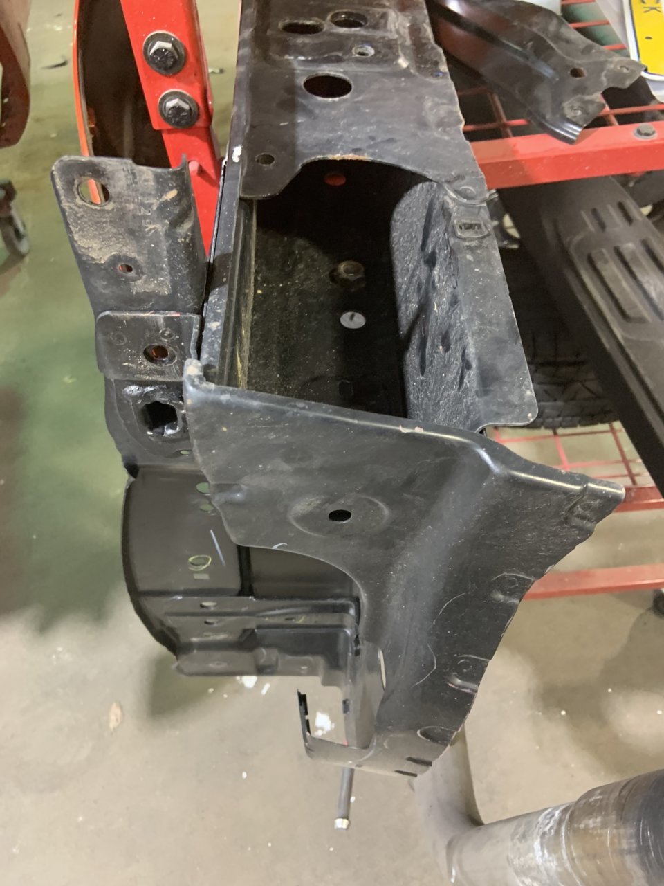

    There is no reason for these aftermarket stiffeners they don’t reinforce anything except the factory rear reinforcement which is not going anywhere. It is multiple layers of heavy gauge High strength steel spot welded together with stamping a designed to make it even more ridged.
