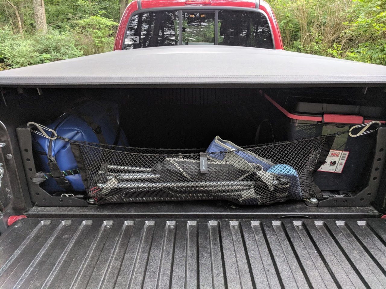

    Open the tailgate and take a look at how the stanchion on either side is attached to the composite bed. That stress relief undercut at the bottom may start to crack. You can see the undercut on the bottom left side of my pic below. Folks have seen the bed spread from either heavy offroad use or from a canopy.
    The extra tiedown locations are also a big positive:

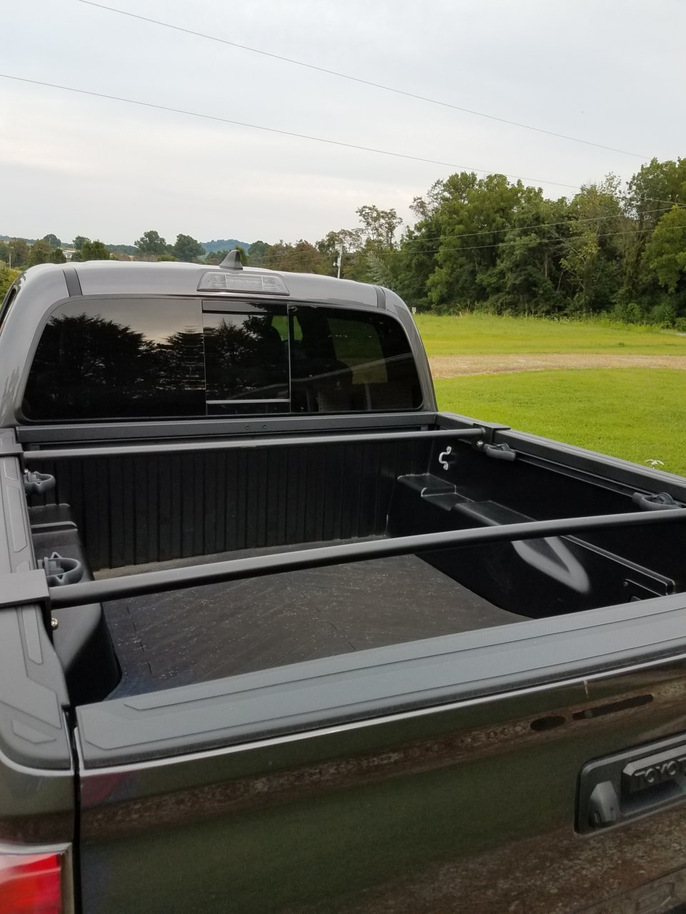

    I made my own version of those.

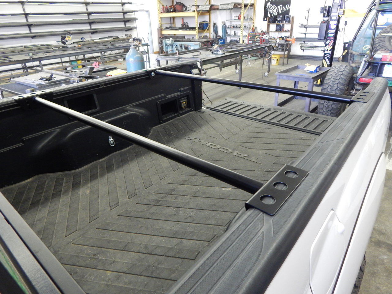

    Those look nice. I wouldnt mind some without the bracket over the top because my cap overhangs down on the inside. Right to the bed rails would be nice

    Thank you, the reason I put the angle brackets on was to allow for them to hold heavier weight and I obviously do not have a Cap either.
