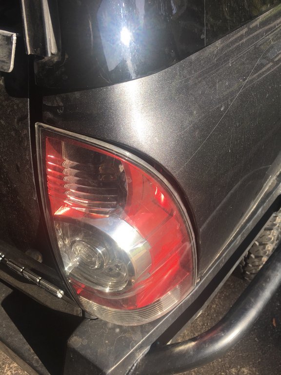

    Yeah, imo it's just not worth taking the risk to not do it. It's what, a 50k truck (in canada, at least). I'll take the couple of little holes in the bed to know it isn't gonna tear and rip open. And I've seen it first hand, so it's very real to me.

    Found pictures of his. And a self described testimony of his driving :rofl:

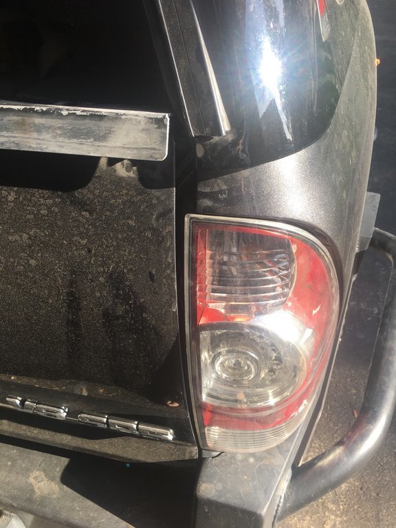

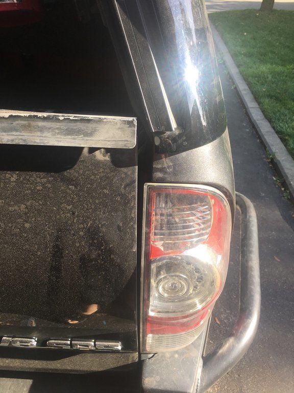

    I never had an issue with the composite bed but on my 2nd Gen the metal yoke wrapping the back of the bed at the tailgate broke twice. Once Toyota Canada replaced it under warranty, the second time no. I pulled the metal yoke out and had someone weld a strap around the outside of the yoke. I didn't have any issue after that. Toyota radius's the inside of the 90 degree bend to relieve stress but that doesn't really help. I noticed it because the gap at the top closer of the tailgate was weirdly wide.

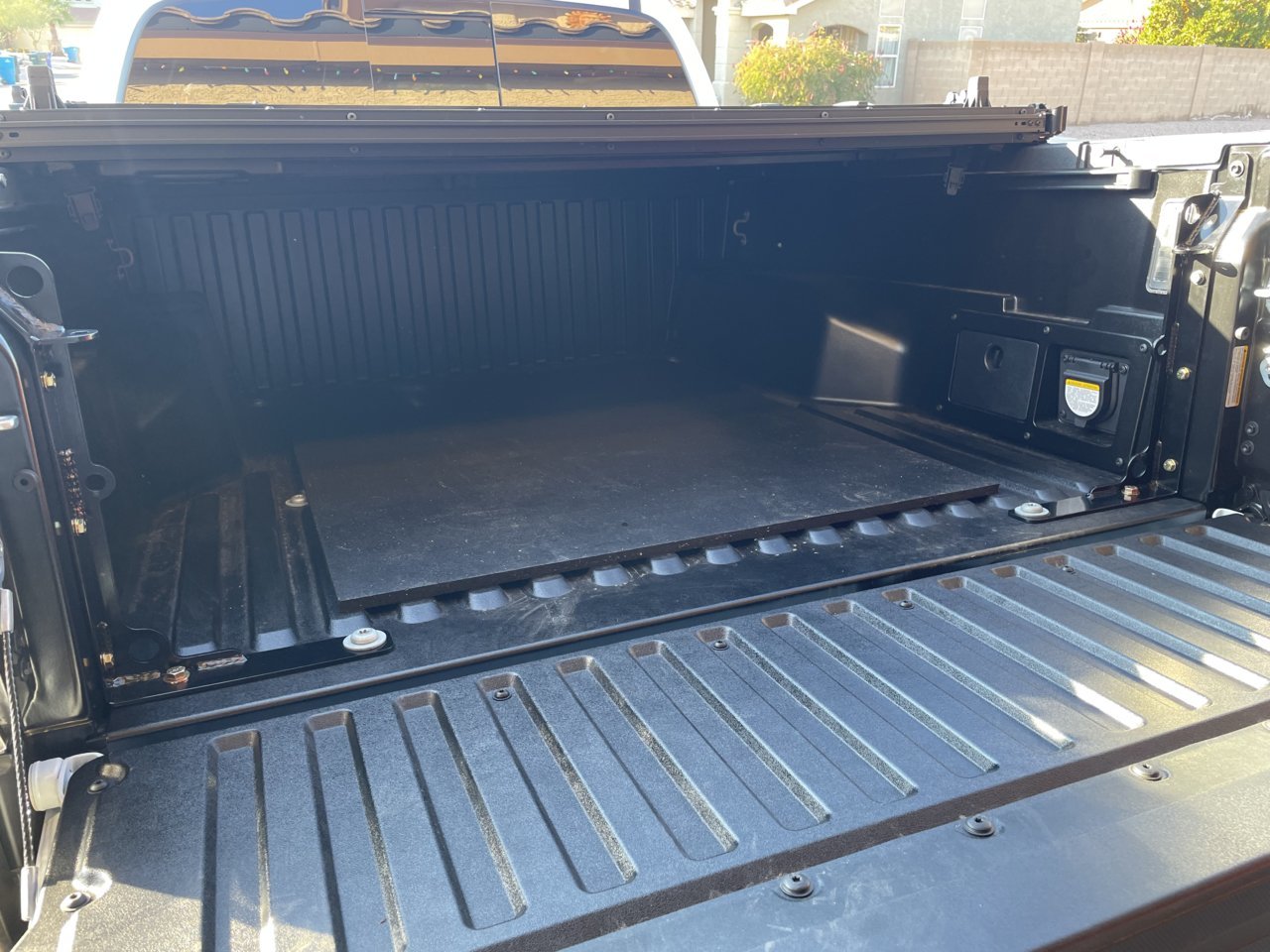

    Nice side bed storage
    Where can I get them?
  16. Apr 2, 2023 at 8:25 AM
    #436
    Grossomotto
    Grossomotto Complete 3rd Member
    Mar 13, 2018
    #247175
    8,446
    39.9526° N, 75.1652° W
    2017 4WDV6LB6MT
    They're Mobtown Fab covers and unfortunately they don't make them anymore :(
