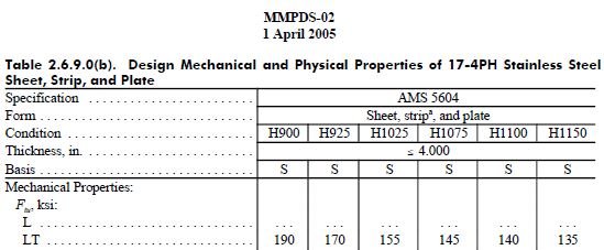

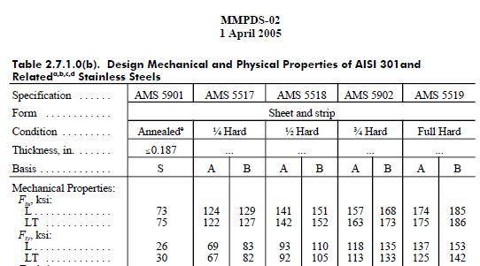

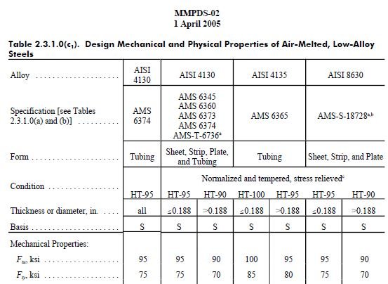

    Steel:
    Stainless Steel:
    Add some ChroMoly to the bunch:
    It really depends on heat treat, but they are generally equivalent other than cost, if you have the ability to spec it out.
    :cheers:

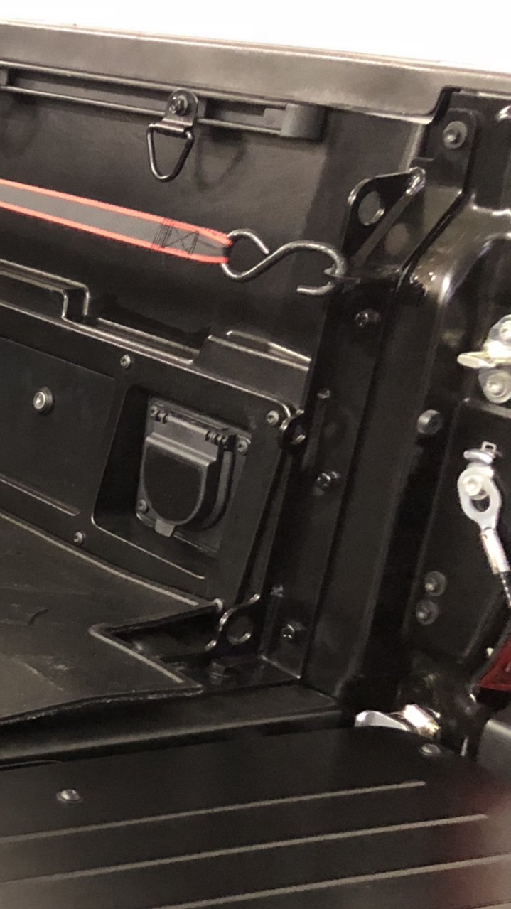

    I installed Total Chaos bed stiffeners. These seem like the best design and more reputable.

    They're stout and almost look oem. The reason I bought them is for more tie downs.

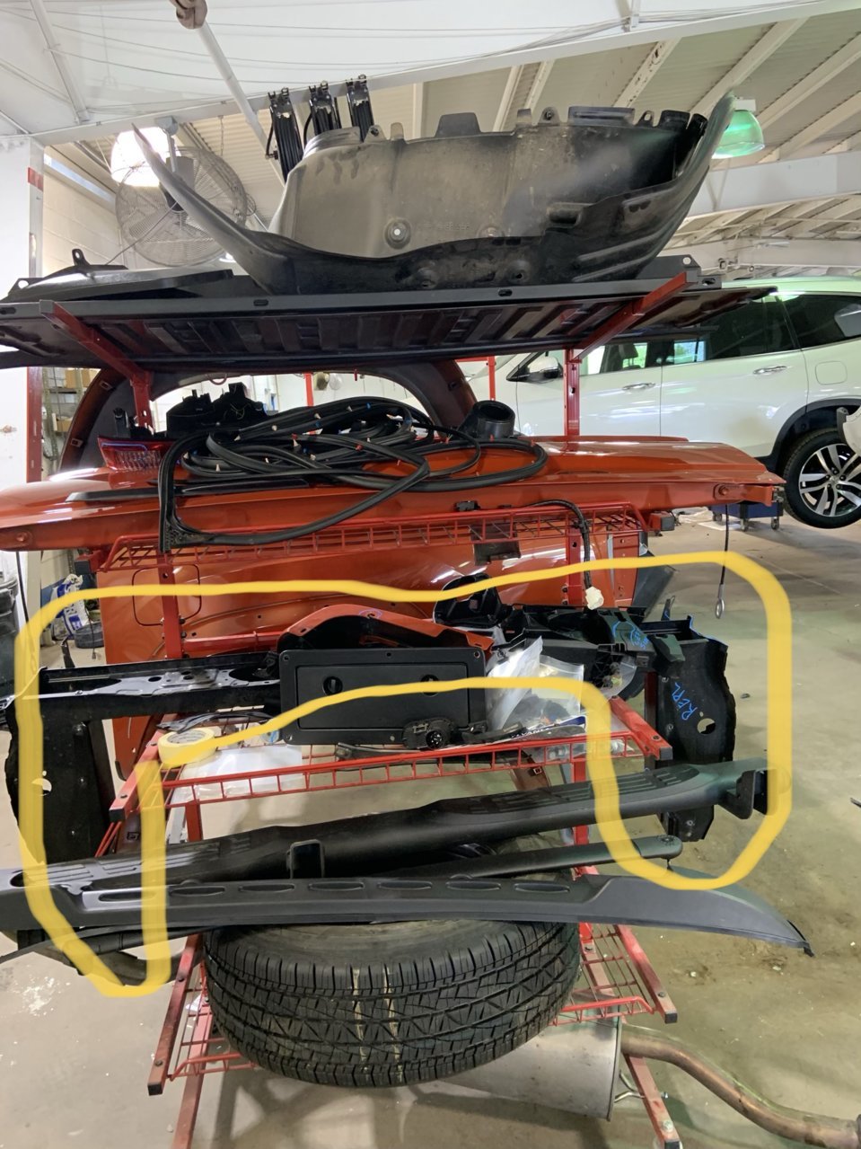

    All these do is pinch the bottom rear lip of the composite bed to the rear bed stiffener(heavy u shaped steel highlighted in yellow this is what the back of your bed is resting on) The stiffener on your truck is a lot heavier and stronger than these little brackets. The composite bed has a flange molded into it (highlighted in yellow)that bolts it to the front side of the vertical rear bed stiffener. These are a waste of money.
