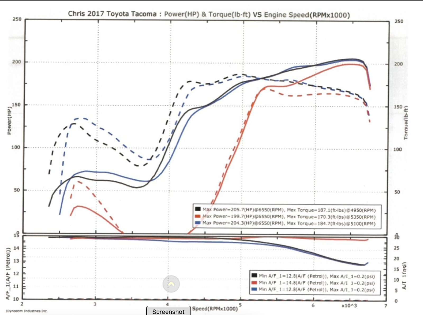

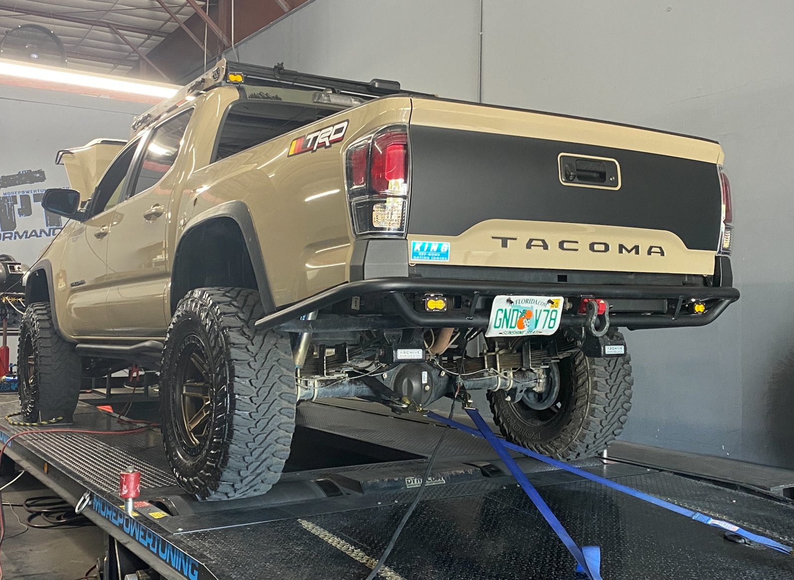

    For engine sound the HPS tube is going to make the biggest difference. I actually tested mine on a dyno before and after. 5 pulls with it installed were all between 5-7 hrspers over the stock resonator. So you can always argue that with data from one random dude on the internet. Dyno sheet below that I had to screen shot from an old post. I tried to find some pics or a video for you but I must have already moved those to an external Hard Drive.
    I did not produce a video as the overall numbers for power and torque were abysmal and embarrassing. Ah ha, I found a pic.
