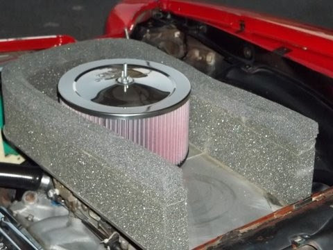

    Some people quote that the CAI airbox doesn't seal that well against the hood and allows hot engine heat to get to the filter
    Now I know this isn't a Toyota , but is my Camaro and this is a custom built cold air box . The foam sealing the air box to the pan is custom fire proof foam . And when the hood is on it completely seals up only allowing cold air into the carb
    You can use this same foam to seal the airbox on the Tacoma . To go even further you can use fireproof sleeving over the CAI tube to further reduce AIT's

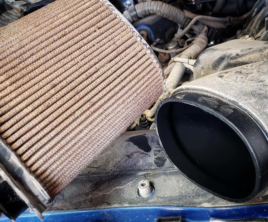

    I've been running the AFE CAI with their add on air scoop for a year or so now. Pro-GUARD 7 filter. I think it sounds great, I no longer deal with snow getting packed in the factory airbox, and the washable filter is nice. Horsepower and added fuel economy, probably no :confused:
    This was after one trip in the desert following other rigs. Spotless inside the air tube. I assume that there are more free-flowing filter options from AFE and other manufacturers, but I'm more interested in clean air.
