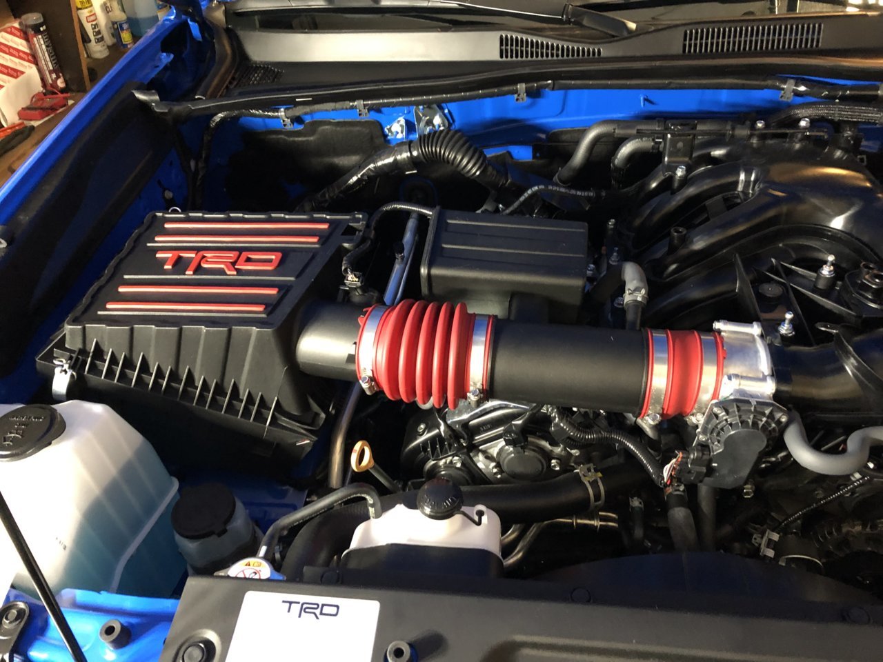

    TRD Performance Air Intake

    It still has the resonator though, i dont get why.
    It is bigger, though! You know what they say...

    Nice box?

    That too, sure is Purdy!
