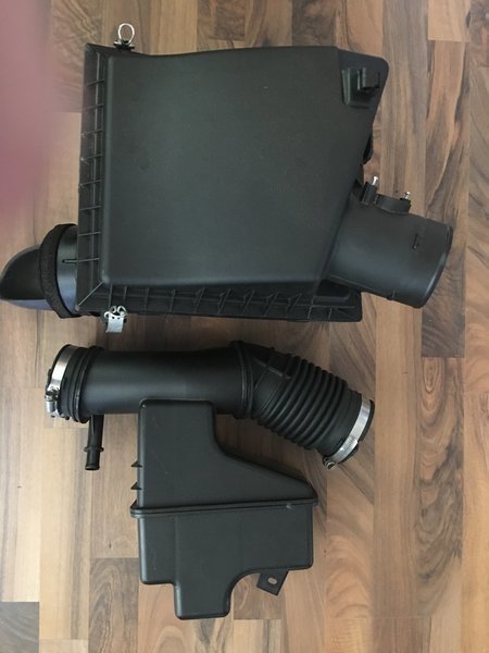

    IMHO the stock airbox is well designed in this truck. Its the same airbox as 5.7 tundra. Also, the stock intake gets cold air from the fender, so its already a CAI. Most vehicles come stock with CAI. If you want more noise and maybe a bit better throttle response, get an air flow accelerator, remove the charcoal filter, install trd filter and get HPS tube.
    Volant makes good intakes, so does trd. If you do get aftermarket dont get the open style filter so you dont suck warm air from the engine bay.

    I did it first with the trd filter and removed the charcoal filter. Definetily added some noise and felt like the throttle response inproved a bit? The stock intake tube has a huuge resonator, which i always hated. Im really happy i added the HPS recently, great noise maker and the engine bay looks cleaner.

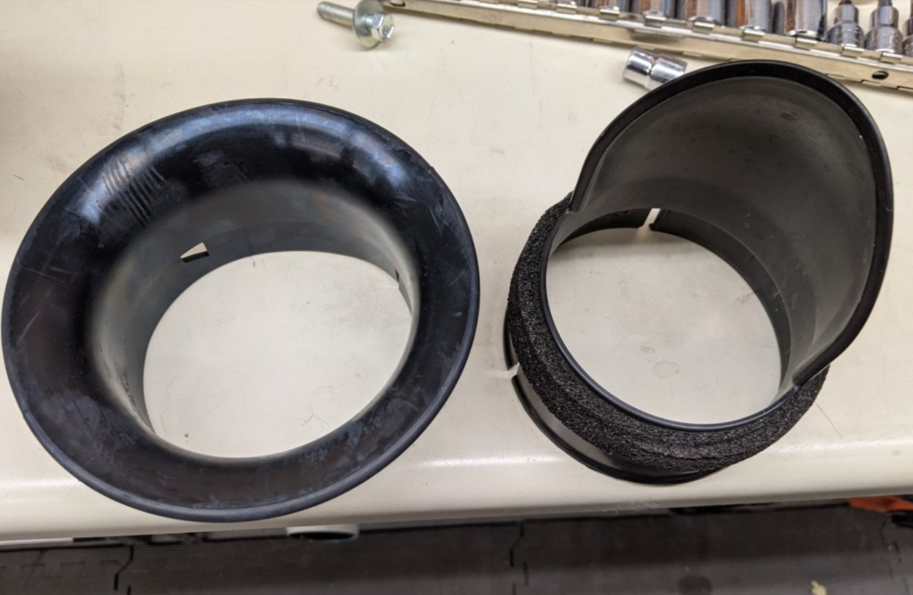

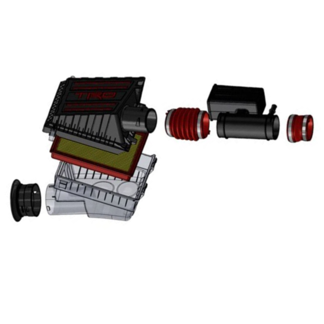

    Despite what everyone says a high-flow CAI will add some hp. Not all CAI's are created equal. Just because it's sucking air from the fender doesn't mean it can't be improved upon. A free-flow CAI improvement can be measured on a Dyno. The TRD one from Toyota replaces the little quarter-cut can with a nice open velocity stack in the fender...
    [​IMG][​IMG]
    Does that mean they are worth the $500? Probably not. My truck, oddly, came from the factory with the TRD intake, but I promptly removed the free-flow air filter and put in a nice restrictive paper filter because engine life is more important to me than the slight bump in power.

    You’re right, and that velocity stack does a lot to increase flow. Combine that with a less restrictive intake tube and filter, and remove the carbon trap if it’s legal in your area and it will make more power. The trick is calibrating the intake tube so the maf still works correctly on the stock tune, or getting a tune to work with the new intake.
