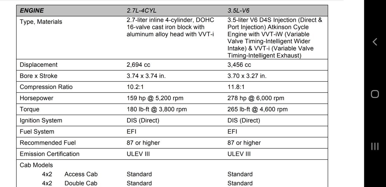

    My post was incorrect and edited to prevent misleading information.

    The TRD Pro does not come with the TRD intake. Mine did, which was totally unexpected by the dealership, the salesman and me.

    Well then, my misunderstanding on that detail. Please ignore my post.

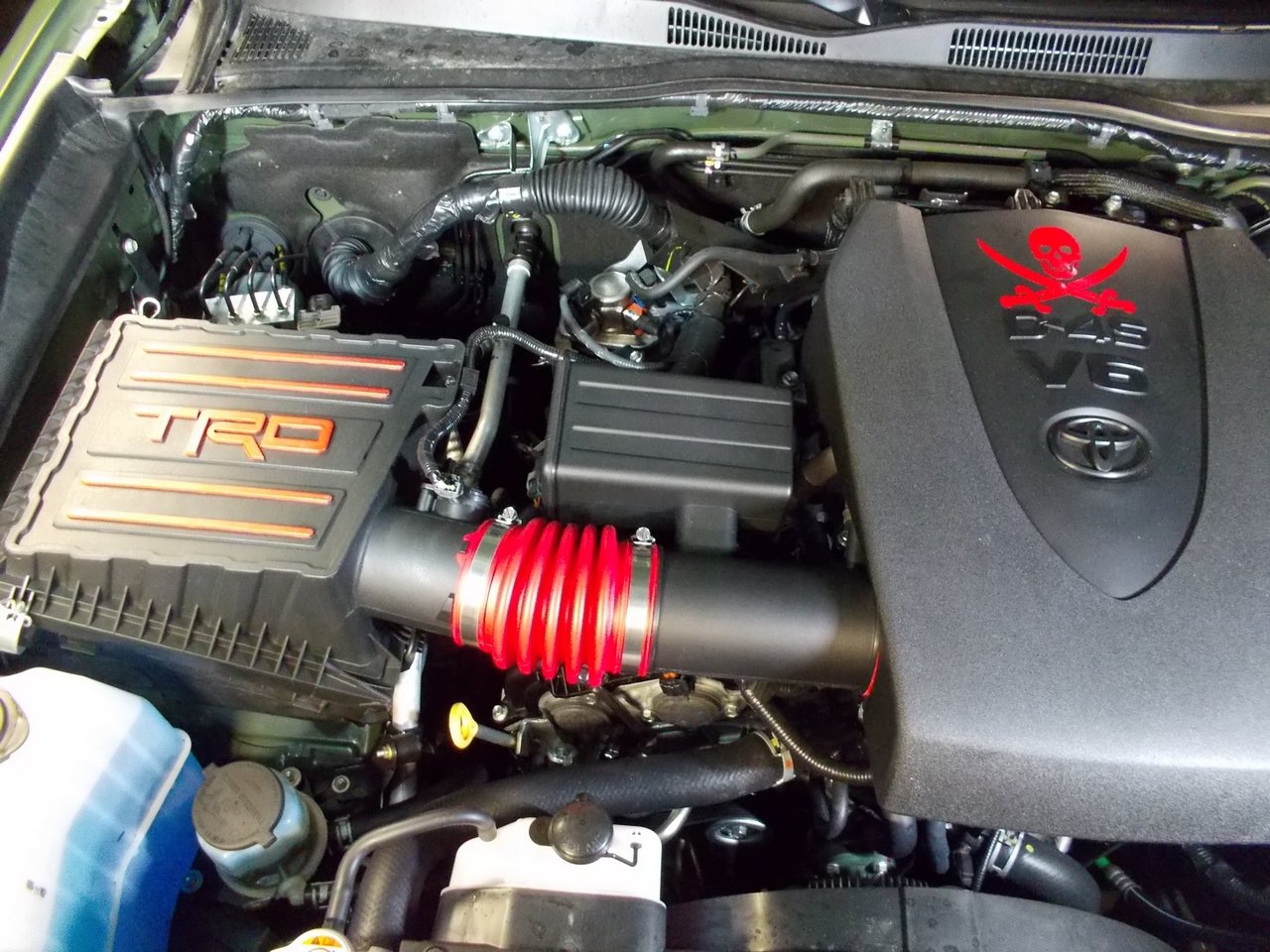

    TRD lift, Exhaust & CAI

    The TRD kit is what I’m running.
    But, I run a Denso or Wix filter

    Agree, when the oiled one gets dirty I'm switching it to a good paper filter.
