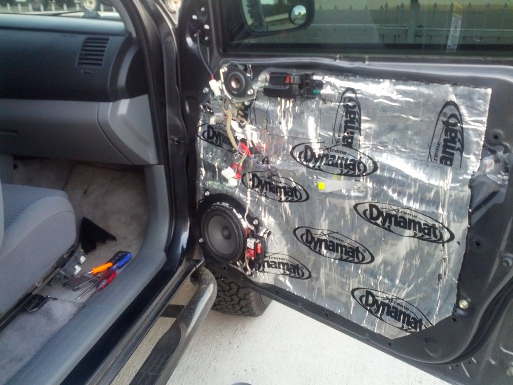

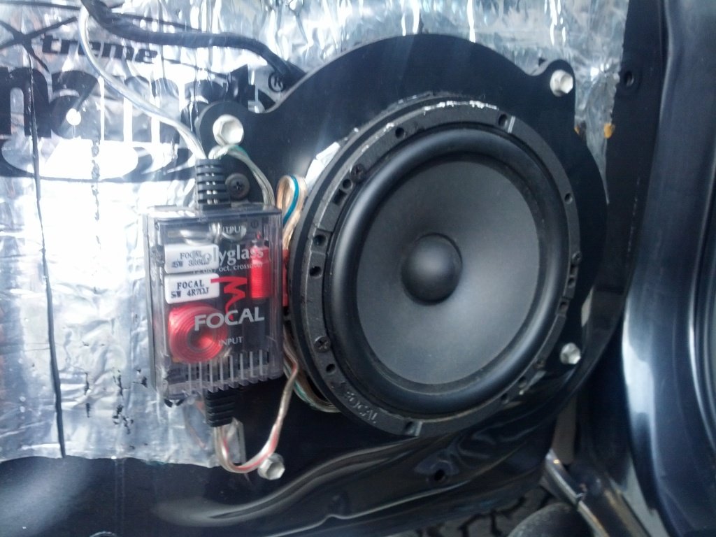

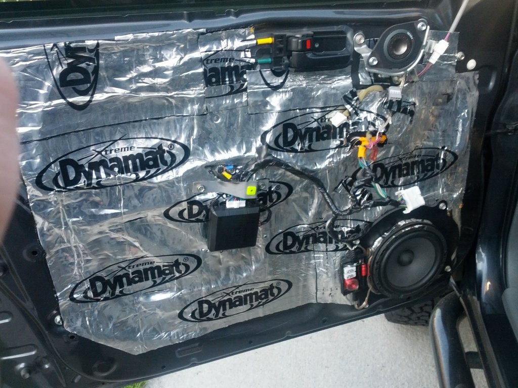

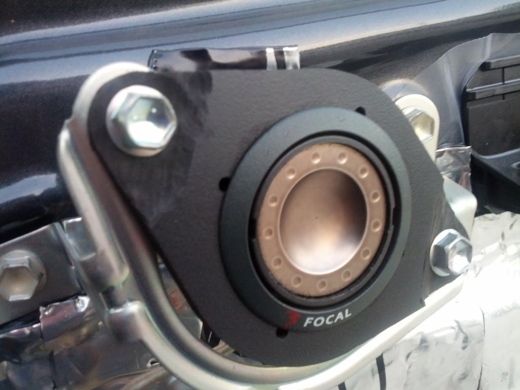

    If you want an amazing speaker with great highs and bass, then the Alpine Type-R will certainly do it for you. It is pretty mainstream but that doesnt take away from quality by any means. I still say a nice set of Focals are better, but your going to double your starting retail price.
    Type-R = $299 retail
    Focal Polyglass = $649 retail (and thats only level 2 out of 4 in terms of quality line-up)
    Obviously you can find them for much cheaper. But thats just the raw numbers. But to answer your question, I think you will be more than satisfied with the Alpines.
    There is a simple trick to dramatically increase the bass produced by your door speakers... Create a "sealed" enclosure for them by using Dynamat or some other form of sound deadener. See my pic below for details. Creating this semi-sealed enclosure will more than double the bass output of your mid-range drivers and with the added benefit of increased SQ, reduced quality lost through resonating panels (rattle), and a quieter cab.
