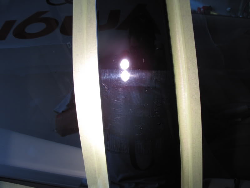

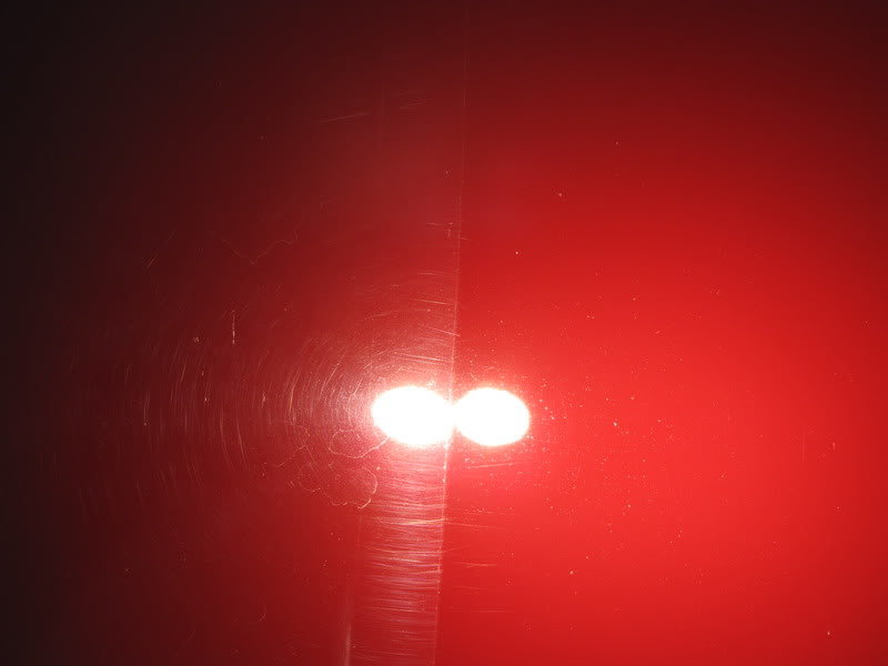

    -Maguire's m205 w/ Lake Country White polishing/finishing pad for light swirls (2 passes)
    -Maguire's m105 w/ Lake Country Orange cutting pad (2 passes) followed by Maguire's 205 w/ Lake Country White polishing/finishing pad (2 passes) for heavy swirls.
    50/50's of this process

    If you like the M105 for serious correction, you're going to absolutely love their M101. All of the cut of M105 with virtually zero dusting - which was my big gripe with M105. And yes, M205 is a great follow up.
