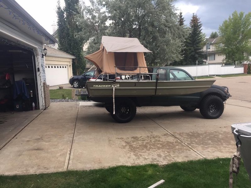

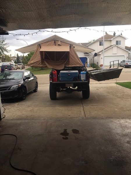

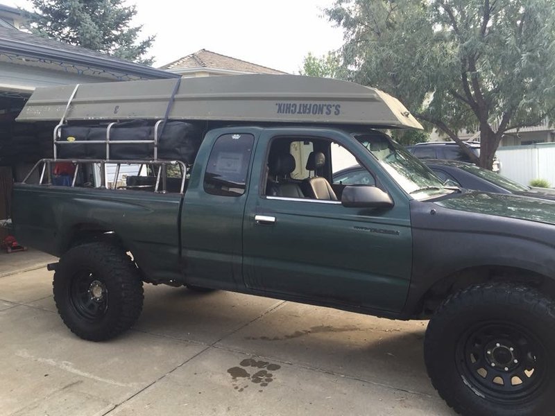

    A couple days ago I saw a guy who built a 2 level rack with the lower level holding the rtt and the second holding his Jon boat underneath and able to flip to the side to load/unload the boat. I'll try to find the post.
    Edit: found the pics

    Good god.

    I know. I'm planning to do the same when I build my rack now.

    that's freaking ingenious rt there kudos to him for being that creative

    My lord. That's genius.

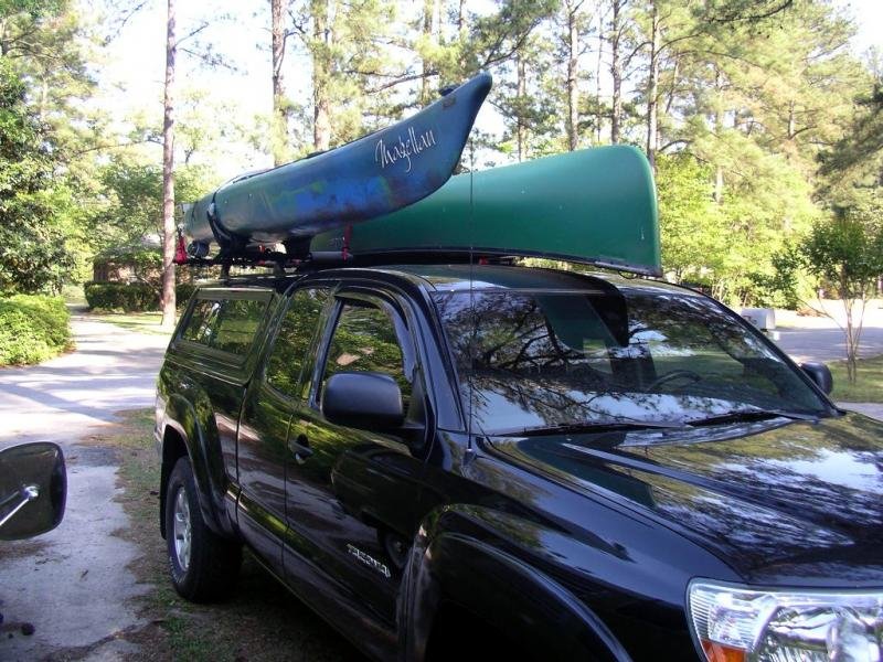

    Are you planning on putting a camper shell* on the truck? If so, simple, just use longer bars on top. I do'n't have a tent but I use the 66" bars to give me room for a bike, a sea kayak and a cargo box or some combination of boats, etc. When I don't have all of that crap on top it's nice to have the bars extending out enough to hang stuff off of such as a solar shower. My bars are in need of replacement (over time the vinyl coating cracks) and I'll probably buy the 78" and cut them to a size I like.
    If you aren't adding a shell you could do basically the same thing with a bed rack, just have some bars that extend enough to carry your boat.

    Hard to see in this crappy picture but I'm not in the US right now so it'll have to do. You can see the Yakima saddles on the passenger side and the bike rack on the driver's. There's room for my canoe or another boat in the middle or I can slide the saddles to the middle and put the box on the passenger side (older Space Booster; it opens on the passenger side only). With the wider bars I think you'd be good to go with a tent and a boat but I'd definitely measure before ordering. Yakima has out some newer more aerodynamic bars that are supposedly a little stronger than the old round bars as well. Make sure that whatever shell you order is rated for the weight or you may need to install some sort of bracing inside.
    Yes, that corner pole is actually vertical; optical illusion in the picture.
    Here's an old picture from 2006 with two of my boats on top (I've got a couple of kayaks). You can see the bar overhang a little better; you can barely make out the bike rack under the canoe gunwale.

    That looks great
