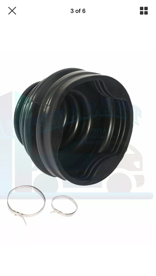

    DP sounds like maybe you ould tell me how to track down an empi outer (part # 86-2321-D) or equivalent? They went from $15 on to $55 overnight on eBay so not an option... So most oem replacements are empis or anything for a 930 should be equal? Already have one just dont want to support the fuckers asking $55 for the 2nd. Empi p/n 86-2321-D

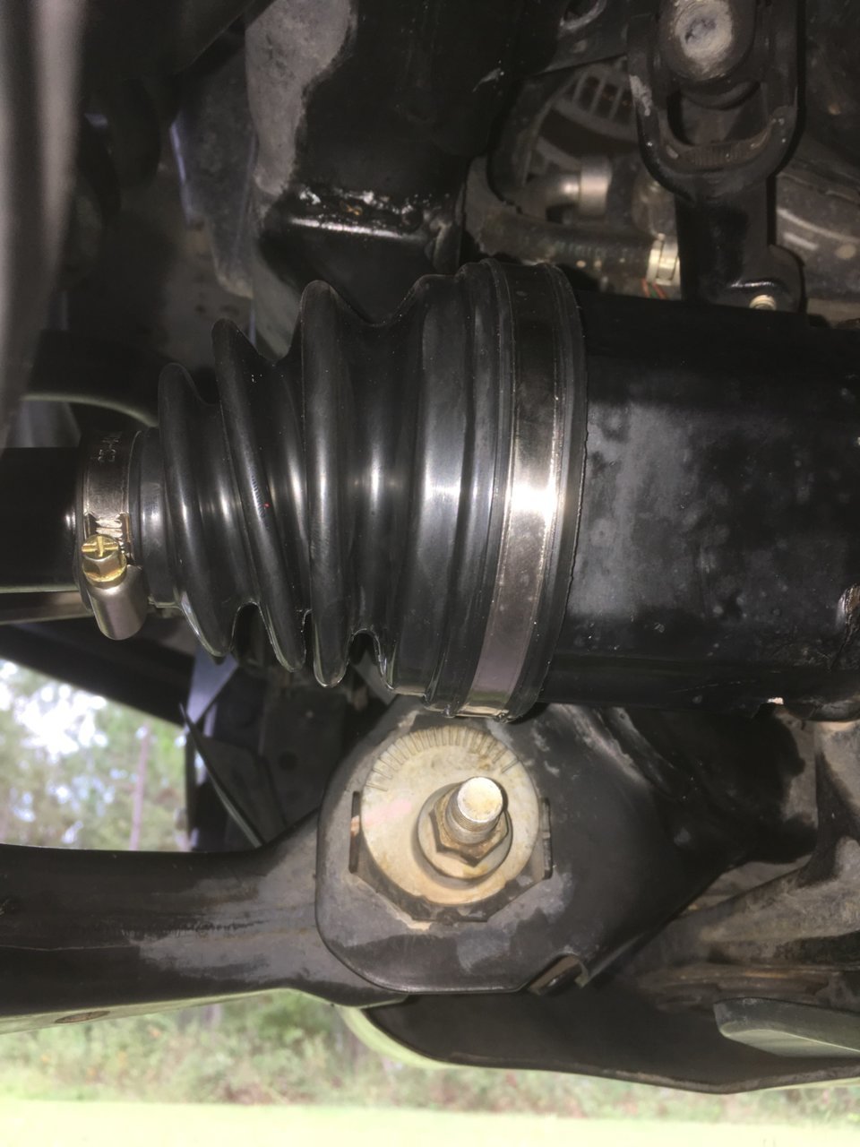

    So I got some EMPI inner boots coming in the mail. Is this the procedure that everyone is doing to make these boots fit correctly ??6C6C3194-3A1E-44C2-8986-79375F684203.jpg F62F27AC-67C0-47E9-836D-E20BA57DD3E4.jpg

    So what did you do? Any follow up?

    They come just like the one pictured here! No cutting or anything. A lot simpler than expected 8A4DC3E8-AFCE-4BEA-BB3C-D67837989069.jpg
