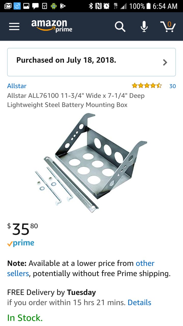

    Not to get off topic, but real quick... what battery tray are you running for the passenger side?

    I kind of customized one off Amazon.

    Thanks for that, I made room on my PAX side a long time ago knowing I would eventually stuff a battery there. I was just going to fab up my own mount out of some angle iron, but for $30 and a little grinding I like your solution. Are those Gp 31's?

    Mine are 34/78. I think the tray actually fits a Group 31.
    I wanted the same battery in both locations. A 31 would have fit in my stock location but 34 was the biggest I could get in the second location.

    Thats the reason im looking at a single battery set up. Too much work for me and I don't own a welder. Looks nice and secure.

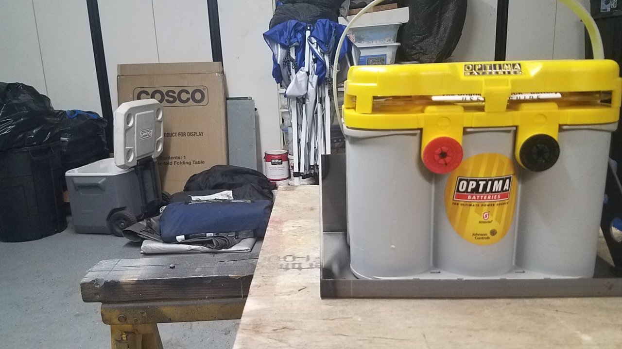

    Does the Yellow top fit into the battery tray without modifications? The vendors are mentioning it is not a direct OEM fit.
