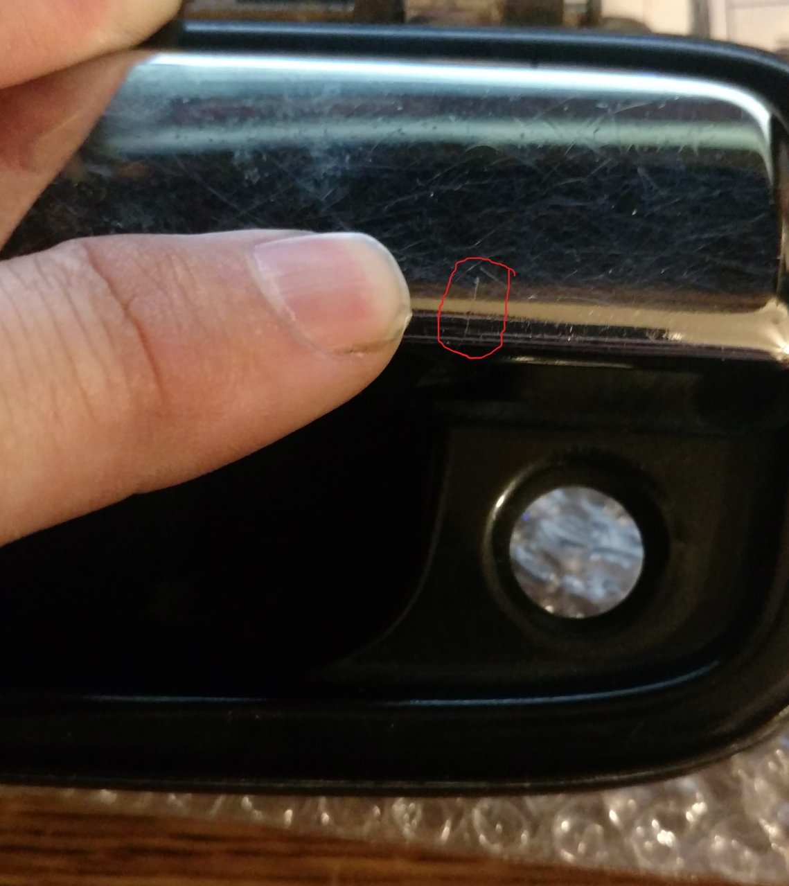

    I avoided a smug reply to this thread that I always open my door carefully and don't yank on the handles and mine have lasted 20 years. Well, last week I noticed a hairline crack on my handle, which is really hard to see because of the reflective chrome coating.
    So I purchased a new OEM replacement and installed it today. It really isn't too difficult if you take your time. I bought some replacement plastic clips for the door panel since I figured I would break some. Sure enough my first one I was too rough with it and it snapped. I had no problem with the remaining clips because I gently pried them with a screw driver.
    I suspect what others in this thread have said about proper lubrication is correct. I'm including a photo of the mechanism on my old handle where the grease had dried out and then gummed up the works, making operation difficult and putting undue strain on the plastic handle. If anyone from the future is reading this thread I highly recommend you take apart your doors and clean and re-grease your handles if they become difficult to operate rather than waiting for them to break like I did.
