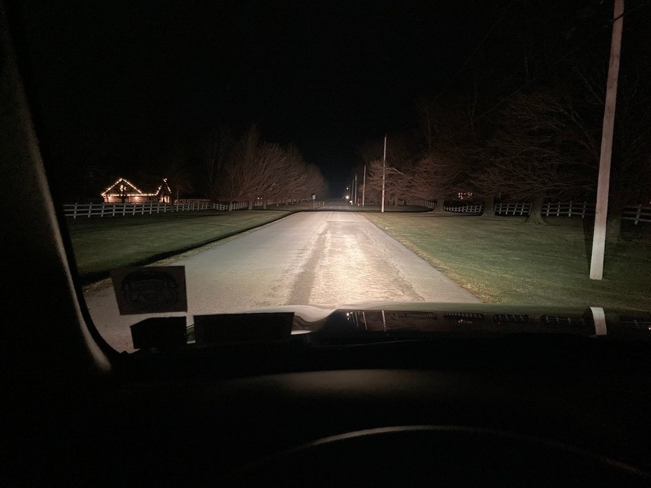

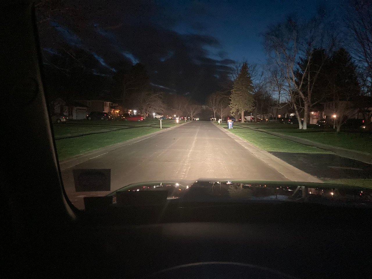

    I'd agree that the LED Super Oscars are a good choice due to their beam width. The issue with spotting critters off to the sides of the road is just how wide of a beam do you want and can you get that with just one pair of lights. Fog beam pattern lights do a great job of illuminating off to the sides of the road, but they don't have much reach - by design. Spot beams have all the reach in the world, but not much spread. Driving pattern lights would probably be the best option for you given the above.
    I happen to have some pics - unfortunately not taken at the same place - of a pair of Diode Dynamics SS5 LED pods behind the grill on my 2021 4Runner. Here's a picture of the Driving pattern I started with:
    As you can see, very good distance with a decent spread, but I wanted more pure distance, so I swapped in the Spot lenses and got this:
    Hope that helps!
