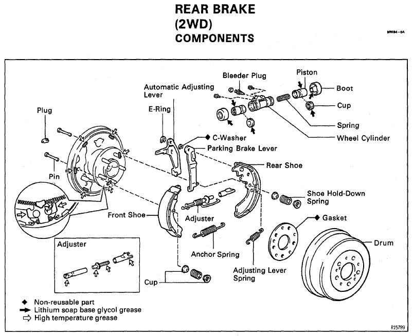

    I did not know that and I have not seen it in my breaks when I opened it, but I just found in FSM there is a "gasket"

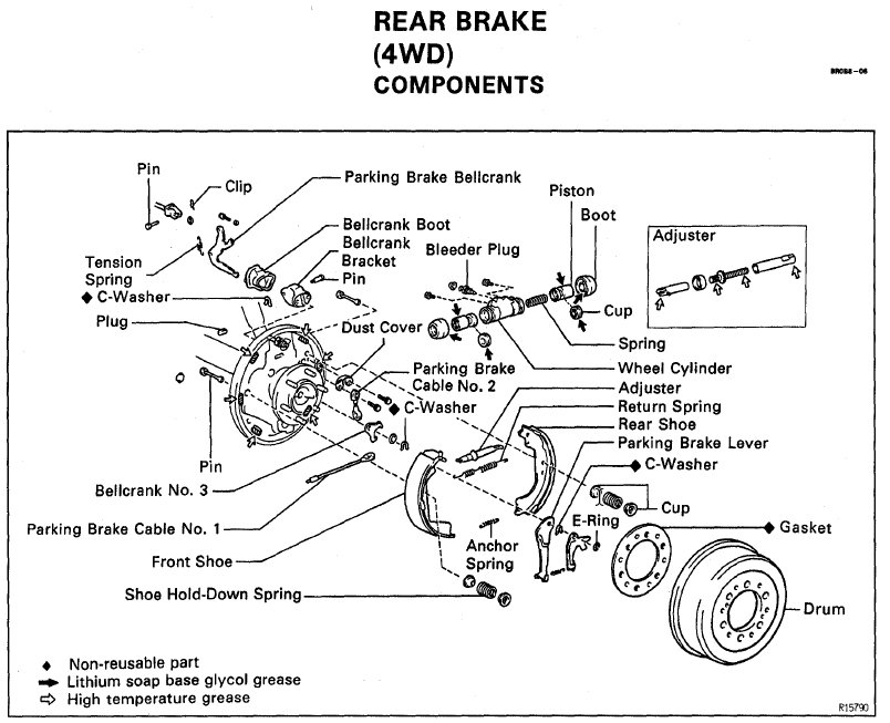

    Sole purpose of that gasket would be to eliminate the 'bond' corrosion will create between the drum and the flange at the end of the axle. A light film of grease or anti-seize would also do the trick. It's not like that gasket is assisting in preventing any fluid leakage...
    FWIW - that 'gasket' is also pictured in the FSM under the 'Rear Axle Shaft - Components'

    I think I do remember seeing that gasket on a 5 lug. It looks familiar and if no one remembers it on their 4WD or PreRunner, seems pretty plausible.
    Unless OP is in the salt belt I wouldn't worry much about it.
    Not a bad idea, just prob. not going to 'save your bacon' either.

    Nope, it in 4WD too. I see it in FSM for all years.
    But like I wrote, I have not seen it under my factory installed drum.
