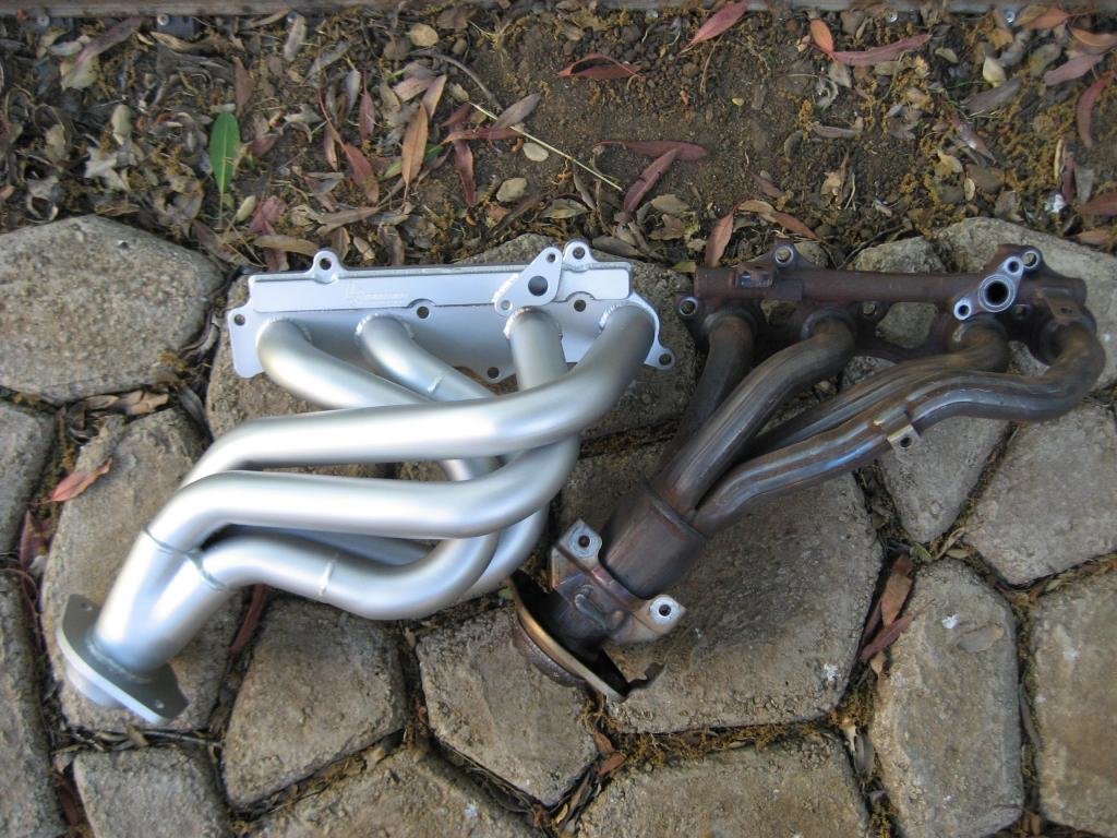

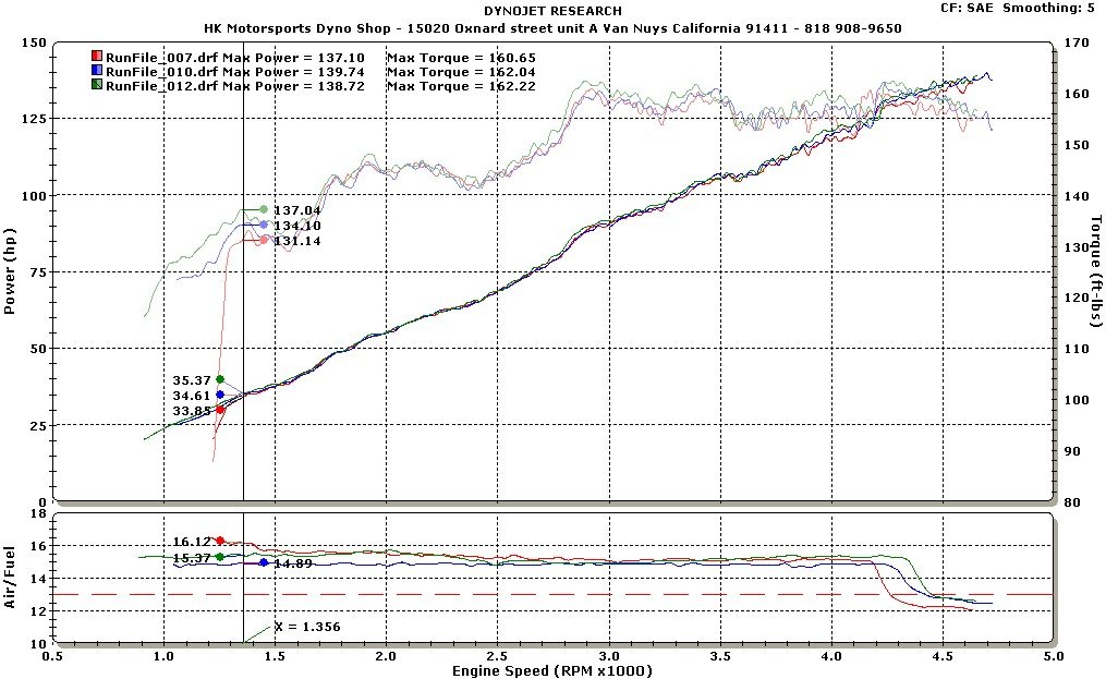

    Hi Dan, :)
    I've done quite a bit of trial and error experimenting, including dyno testing, to find out which exhaust system would work the best on my 2.7.
    If you only get one single product, the very best bang for your buck is to replace your stock exhaust manifold with an LCE long tube header, and just keep the rest of your exhaust stock. The stock muffler is actually a very good design and is well matched to the engine.
    On the dyno, the LCE header produced more torque as well as lowering the torque peak by 650 rpms from 3,800 rpms down to just 3,150 rpms.
    I also dyno tested the stock muffler, a Magnaflow muffler, and a Flowmaster muffler head to head. As you can see, they were all very close...
    RED: stock muffler
    BLUE: Magnaflow muffler, 22 inch straight through
    GREEN: Flowmaster muffler, chambered, Series 50 Delta Flow
    The Flowmaster muffler just slightly edged out the other two by producing a little more torque while generating a torque peak 100 rpms lower than the other two mufflers.
