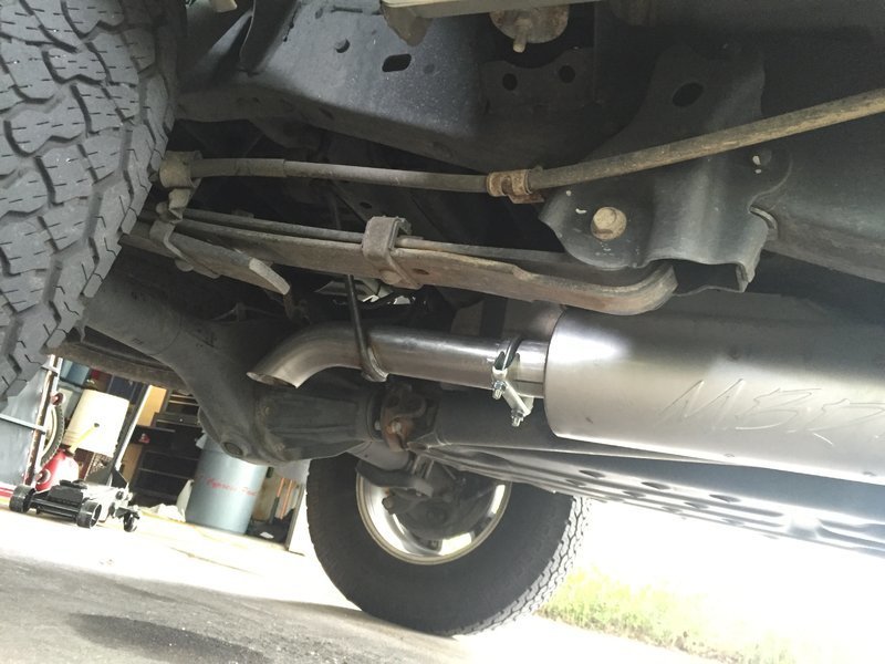

    The MBRP is a nice system, I have one on my Tundra.
    On our 4runners however I have just chopped the stock muffler out, welded in a Magnaflow muffler and then a turn down on the back of the muffler very similar to that of the MBRP style but for all of about $90 and an hour and a half of my time.
    The one thing that would definitely help clearance is a cross over relocate/reroute at an exhaust shop. Just have to make sure you do it to work with whatever skids you run. It'll give you a flatter belly at the trans cross member

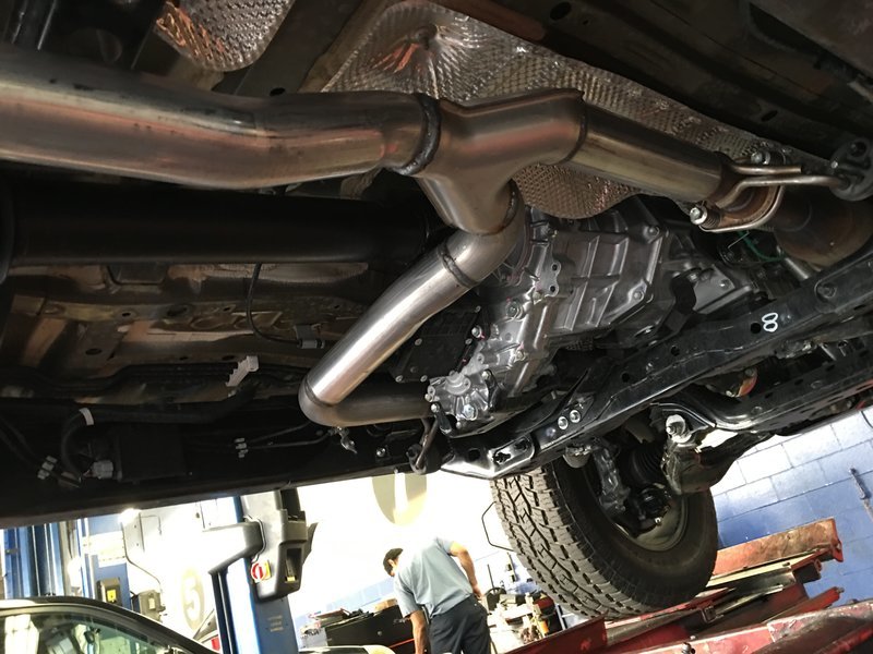

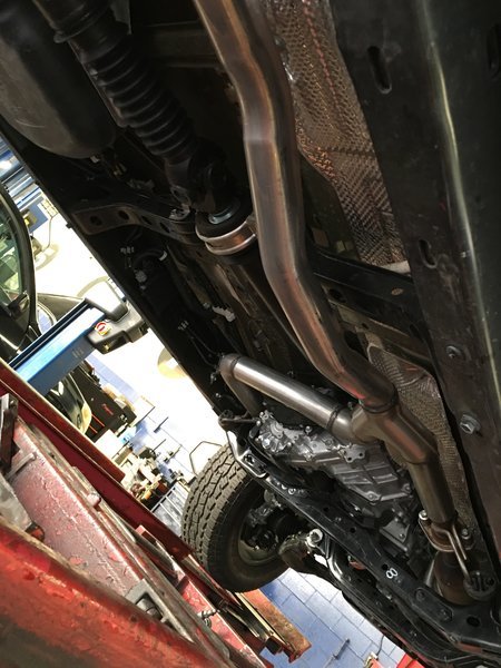

    alex.busta
    alex.busta Mall Crawler
    Apr 4, 2016
    #183272
    1,412
    Alex
    North OC, Cali
    2016 DCSB TRD Sport 4X4
    Trail Paint Job!

    Looks good. Any heat shield added to the cross over?

    Yeah I wrapped it with exhaust wrap.
    I've inspected it a few times and it doesn't seem to be causing any changes in that plastic housing. It looks closer in the pictures than it actually is.

    I'm taking this pick with me to a muffler shop. Did you change the muffler out as well?

    Yeah, I got the Borla Pro XS muffler. It's cutoff just behind the axle and dumps down. Sounds great IMO
