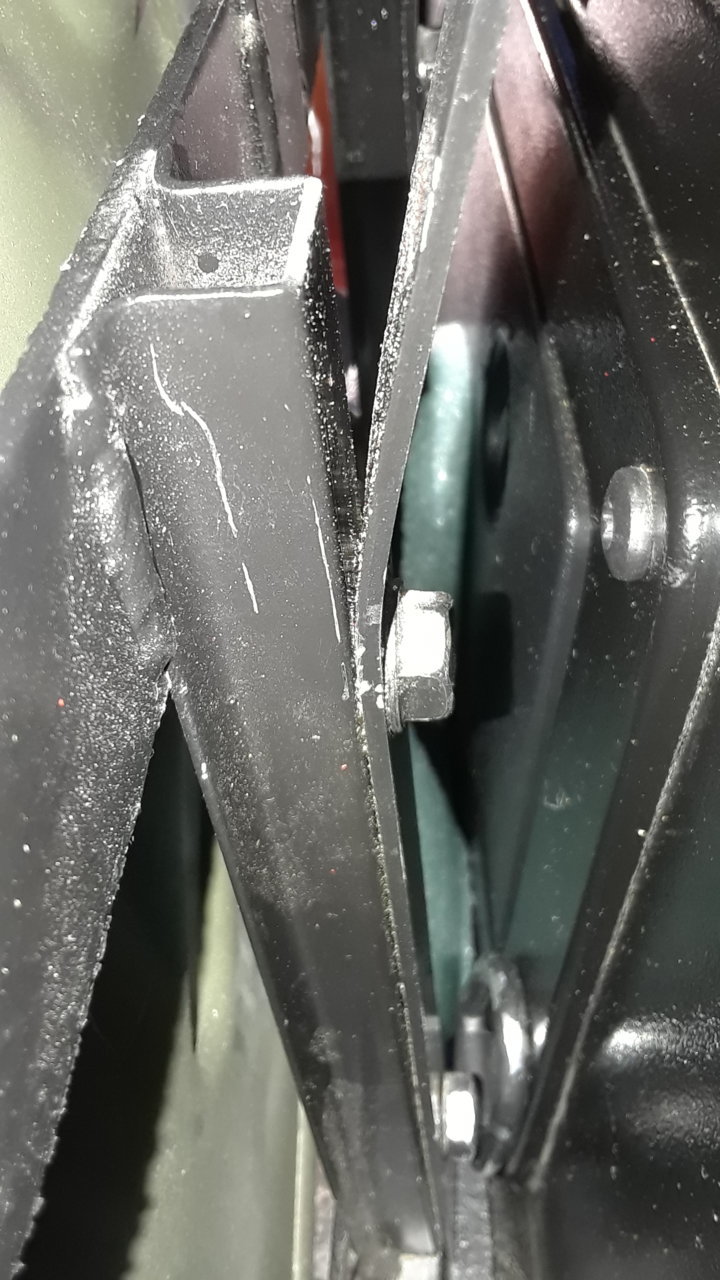

    Simple aluminum strap/bar. I used what I had on-hand and the width is just right, but I wouldn't mind a bit thicker just to be more rigid.
    Bar is available at any hardware store.
    Make sure the bolts (that attach the bar to the can holder) don't puncture the jerry can. Obvious, but still had to say it.
    Use the shortest bolt you can, but ensure full nut engagement. (CheeryMax rivets would be perfect here!)
    The alu strap does allow for shaping. As you can see in the 2nd photo. (Photos suck, my fault, but I had to be somewhere else. I could only take quick shots.)
    Looking down from directly above the jerry can. Truck bed rail at top:
    Behind the can. Alu bar is bent at an angle to keep can away from bed side. May not be necessary if not over the bed-side cubicle: (can see the bed cubbie door & mount screw)
    Easy mount to bed rail. Has held the can in position for about 9,000 miles so far without issue: (The lime green object is really an OD jerry can. ??? Ignore the blk & grn foam at top, it was a cushion for the shovel blade once.))
    The bars were painted five years ago, and are now in need of a touch-up...

    cool, thanks for the pics.
