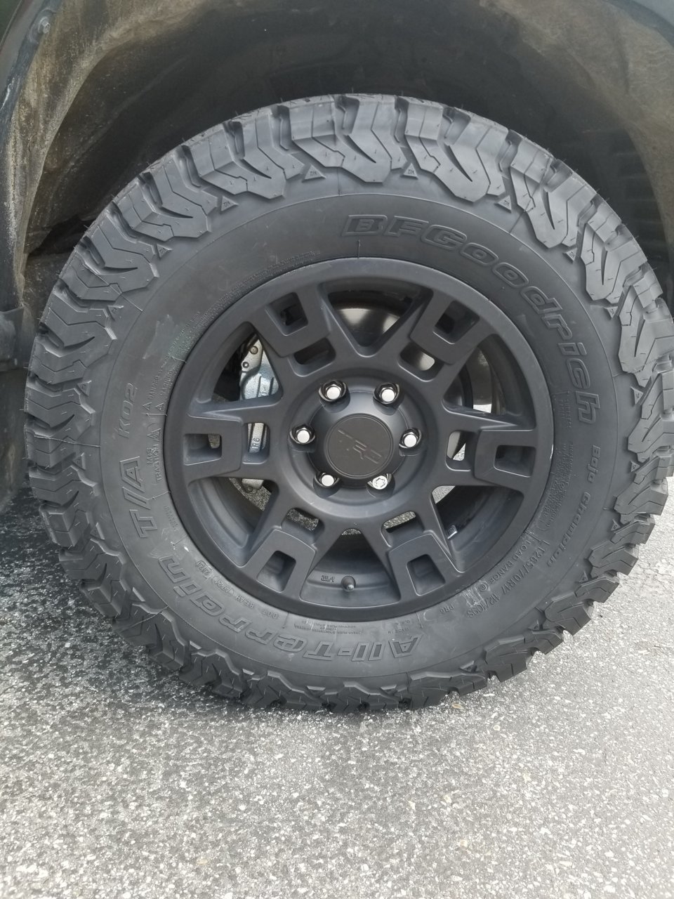

    If you were to get a set of TRD Pro wheels you could run 275/70/17 K02's without having to put a lift on. I think it comes down to the offset but I ran those on my Sport for 2-months while I was waiting to put my lift on. No rubbing whatsoever and I stressed the truck a bit trying to see what my limits were.
    I wonder if you put some spidertrax 1.25 inch spacers on the stock wheels if it would keep bigger tires off the UCA's?

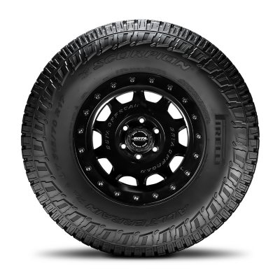

    So this saves me from making a thread and not having another tire post.... but i hope this can help
    2016 sport stock and looking to go with this..
    Pirelli Scorpion All-Terrain Plus - 265/70R17 AT+ 115T Tire $129 per right now.
    Other than the speedo being off by 2.3mph at 60~65
    Is anyone running these ?
    is the 100 rpm lower at highway speed bother anybody?
    i would think that the mpg should be close as these are not a Full A/T tire (they say) 90%street 10% trail and i think snow peak rated
    i live in illinois so not that many mountains to climb, just pot holes and snow.
    :notsure:
    I like the picks with the rims i have also. helps me out (SEMA black)
    and PS: sorry for :threadjacked:.
    Speedo Reading Actual Speed
    20 mph (32.19 km/h) 20.68 mph (33.29 km/h)
    25 mph (40.23 km/h) 25.85 mph (41.61 km/h)
    30 mph (48.28 km/h) 31.02 mph (49.93 km/h)
    35 mph (56.33 km/h) 36.19 mph (58.25 km/h)
    40 mph (64.37 km/h) 41.37 mph (66.57 km/h)
    45 mph (72.42 km/h) 46.54 mph (74.89 km/h)
    50 mph (80.47 km/h) 51.71 mph (83.21 km/h)
    55 mph (88.51 km/h) 56.88 mph (91.54 km/h)
    60 mph (96.56 km/h) 62.05 mph (99.86 km/h)
    65 mph (104.61 km/h) 67.22 mph (108.18 km/h)
    70 mph (112.65 km/h) 72.39 mph (116.5 km/h)
    75 mph (120.7 km/h) 77.56 mph (124.82 km/h)
    80 mph (128.75 km/h) 82.73 mph (133.14 km/h)
    85 mph (136.79 km/h) 87.9 mph (141.46 km/h)
    90 mph (144.84 km/h) 93.07 mph (149.79 km/h)
    95 mph (152.89 km/h) 98.24 mph (158.11 km/h)
    100 mph (160.93 km/h) 103.41 mph (166.43 km/h)
