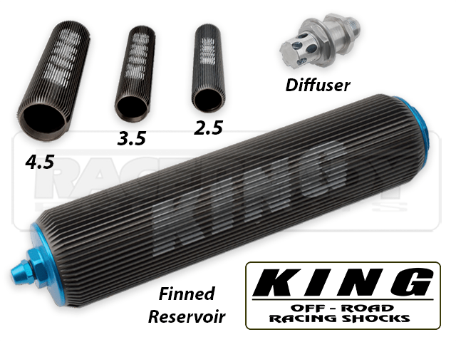

    Tw: “Resi’s don’t help with oil volume and cooling”
    King: “buy these 3.0 finned resi’s for added cooling”
    TW: 65609696-258F-474C-A74F-FA79849C4AD0.jpg

    Reservoirs aren't for cooling. Reservoirs move the nitrogen chamber and IFP outside of the main shock body, allowing for a shorter overall length of the shock as well as permitting a larger volume of nitrogen to lower pressure to aid ride quality.
    Finned reservoirs do aid cooling for those that actually race their junk, for everyone else it's just bling.
    xxTacocaTxx and Blackdawg like this.

    Idk who said anything about reservoirs being for cooling. If cooling is going to be on the list of reservoir benefits it'll be minuscule at best. That's why the King finned resis are such a joke. I'm sure they have a slight benefit for cooling but you have to be performing at such a level where you take what you can get.
    I agree with your statement. I cant speak for the difference in nitrogen volume between IFP and reservoir as I don't have that information but it is an interesting observation.
    If you want cooling capabilities then add something that's designed to do just that.
