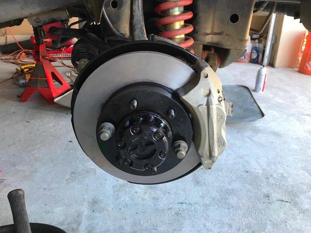

    Did not realize until last week that O'Reilly Auto Parts turns front disc brake rotors and rear drums. Just picked up my original OEM '97 V6 Taco 4x4 set yesterday. We had our own machine shop for decades, so rotors/drums/flywheels/etc. were precision-turned in-house thanks to our master machinist H.G.. O'Reilly's work looks very acceptable to me. Check with O'Reilly in your area if you need this service. Just finishing up refreshing the OEM brakes & other routine MTX on my '97 V6 Taco 4x4. The original OEM rotors are still very serviceable after 26 years/135K miles of off-roading abuse which is a testament to their quality. When these OEM rotors need to be replaced, will either go with another set of OEMs or Brembo rotors/Akebono pads. If the (2) sets of Cooper All Terrain/Buckshot full-lug mud tires I use were not both on the old style 15" Tacoma wheels, I would seriously consider going with the Tundra Brakes upgrade.
