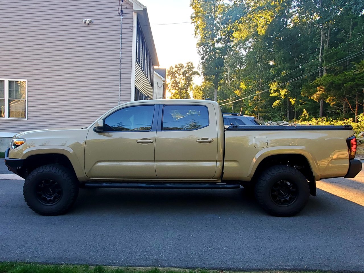

    I got three inches with the 650lb spring and setting 6/5. Going on two weeks and and hasn't settled yet. I installed myself and saved a some money.
    PM me if you have any other questions.
