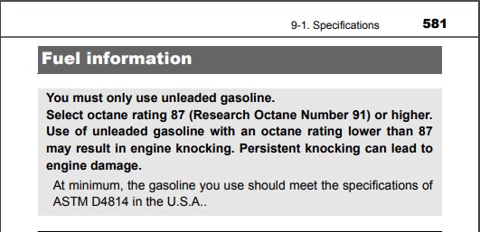

    I believe the manual suggests using 90 or 91 RON fuel, which is Japanese standard regular. There have been debates on what exactly that means as the U.S. measurement is different from the rest of the world (because of course it is). Since our trucks have high compression, dual vvti engines, it adjusts the timing based upon the fuel's octane, generaly the higher the better, allowing it to produce a little more HP and resist knocking. I have tried every fuel octane available to me, including non-ethanol, and my truck runs best in terms of drivability on 90/91 non-ethanol, then followed by premium 91/93 ethanol (any brand). Anything 89 or below causes knocking with the exception of Exxon regular 87 ethanol. I also get the best fuel economy from the Exxon 87. But those are just my results.

    http://www.pencilgeek.org/2009/05/octane-rating-conversions.html
    91 RON is 87 in US octane.

    To split hairs the owner's manual doesn't "recommend" 87 octane, it says to "select 87 octane or higher".
    After attempting to catch up on the OVTune threads it seems apparent that Toyota told the ECU programmers to throw in the kitchen sink and to add every possible data for the ECU to draw on. I have no doubt that 87 octane got the most love in testing and programming by a large margin. Even OVTune admits that there is nothing really left on the programming table to massage out a few more HP on 87 octane. However I would imagine that the stock ECU does have at least a little something extra in it for higher octane as I noticed a change/reduction in hesitation after I started putting in 93 a month ago. Maybe that's why Toyota says "87 or higher" instead of "recommend's 87" as I doubt its making more power is just seems smoother. Maybe it's just the winter gas formula my truck doesnt like. IDK
