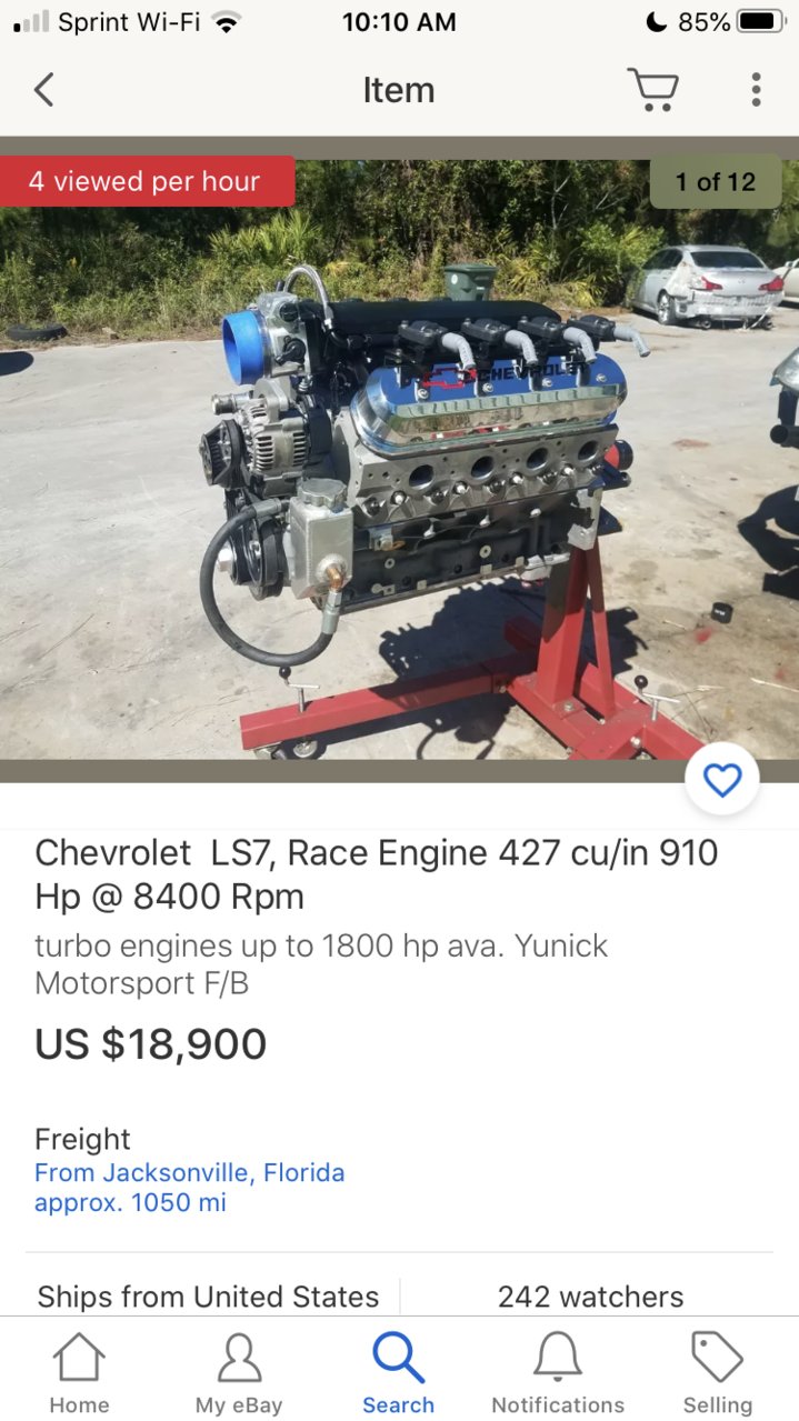

    What size front coils do I need for this motor? I don’t want to regear. Teehee 99590875-65EB-4596-98B8-589662888E6A.jpg
