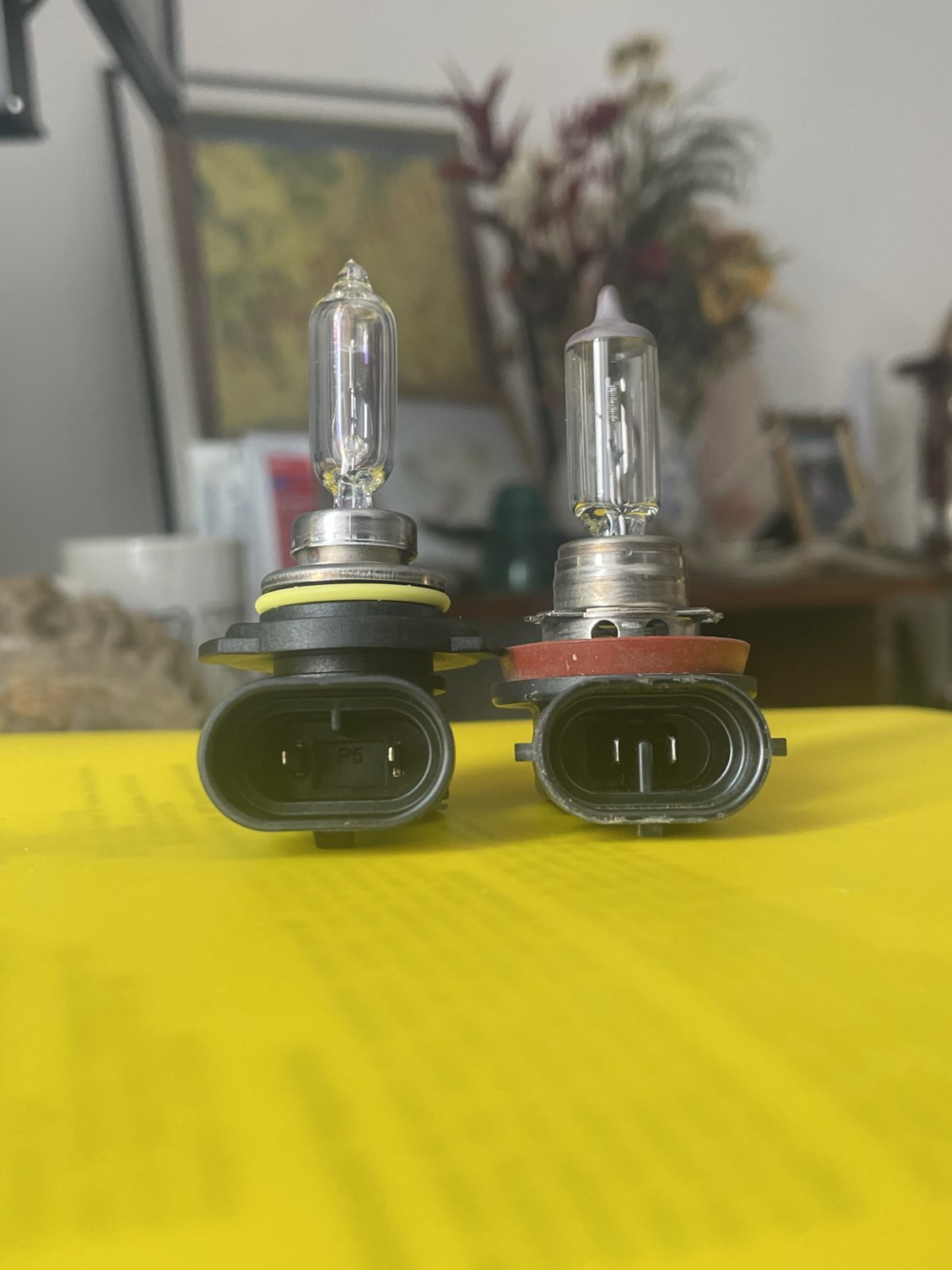

    Alright guys, went to install the h9 today.
    I’ve read on TW that the connector needs to be modified slightly but i don’t see how this would fit…? The prongs are set further apart on the h9 (phillips)
    so new bulb on the left, factory low beam on the right
    help a simple man out lol

    Doesn’t look like an H9. Do you still have the packaging?
  14. Jan 5, 2024 at 12:54 PM
    #54
    Veet-88
    Veet-88 Well-Known Member
    May 21, 2015
    #155792
    1,844
    18 Tacoma DCLB sport
    Those are 2 very different bulbs. The key to lock into the housing looks entirely different.

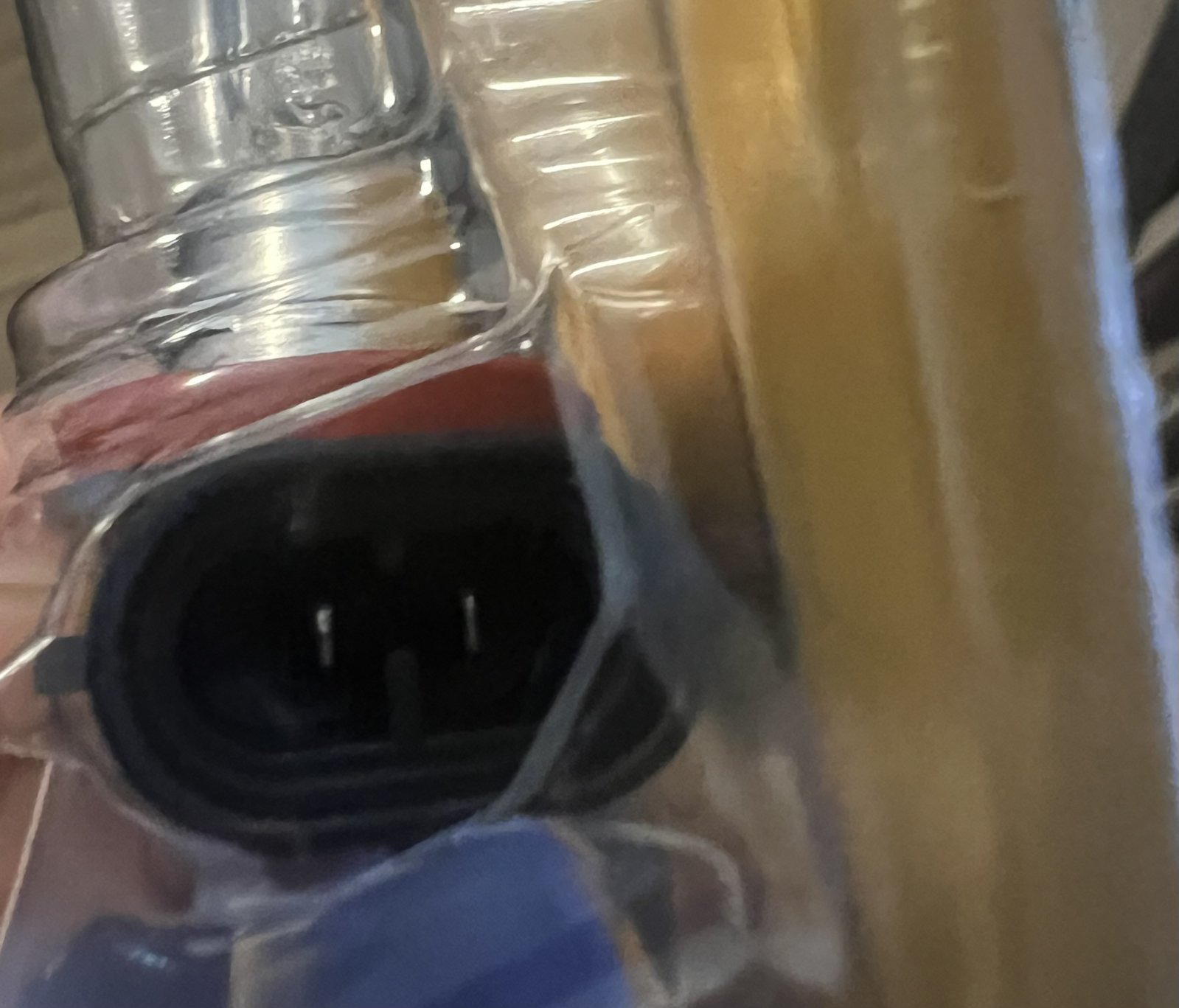

    here’s the Philip H9s I just got off Amazon. The prongs seem to match the oem ones more than the new ones you have
    musicisevil likes this.

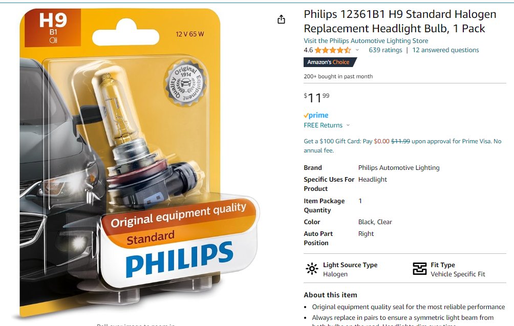

    Thanks for the help guys,
    This is what I ordered but the package I received says "9012" on the top keft corner instead of H9. I didn't check.....assumed they sent the right bulbs.
    Guess I have to make a return now.
    Can someone link me to what worked for them. Like I said in a previous post...we're simple folk lol

    Are you near a Menards? They sell Philips bulbs. I bought my pair from them.
    And you can remove the green endcap on the plug without having to modify the H9.
    musicisevil and boston23 like this.

    It’s also worth noting that the metal fins that lock the bulb into the housing are different than the h11. Some people swear that finagling them in there, in some way that I’m not familiar with, is easier but I just trimmed the metal tab
