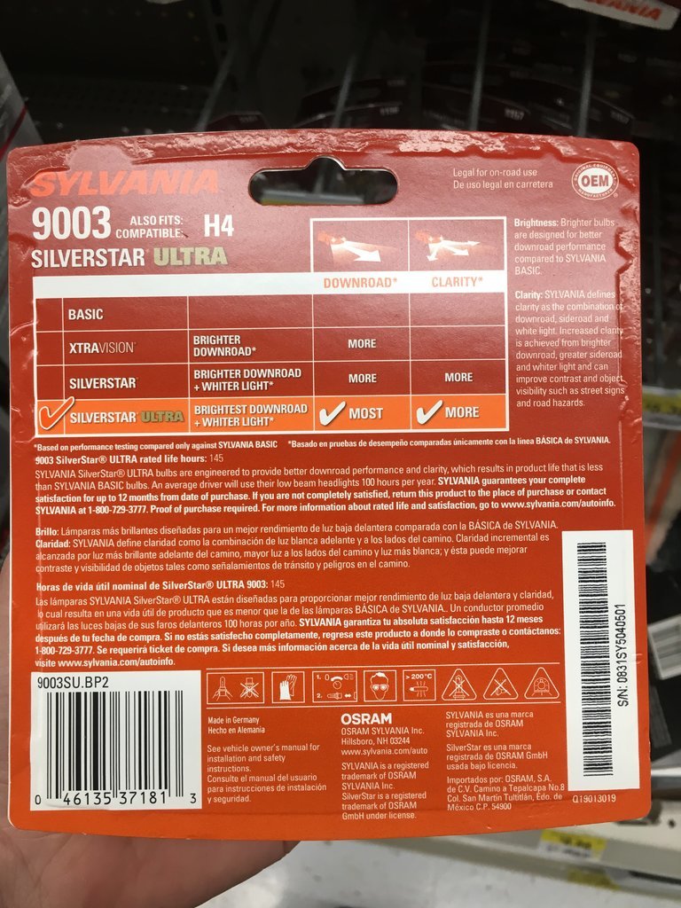

  16. Oct 11, 2017 at 9:13 PM
    #56
    07 sport 4x4
    07 sport 4x4 Well-Known Member
    Dec 24, 2010
    #48165
    1,453
    Blake
    Southeast
    2017 Duramax

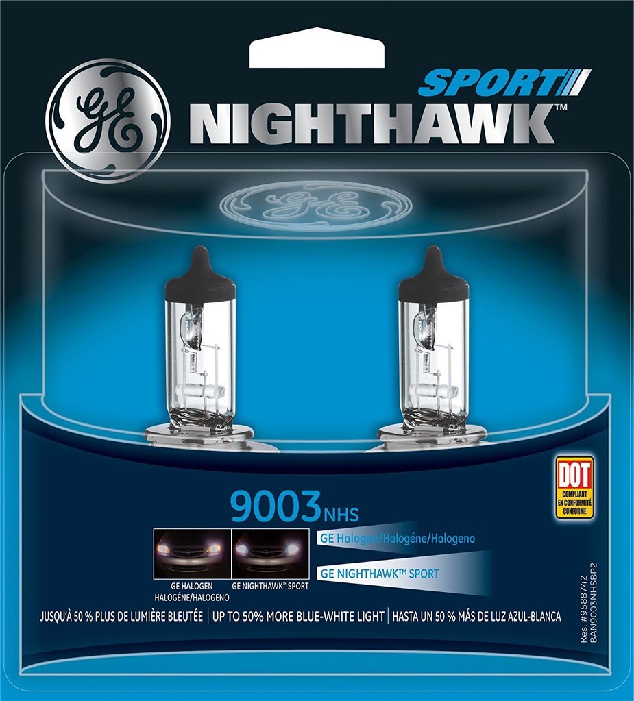

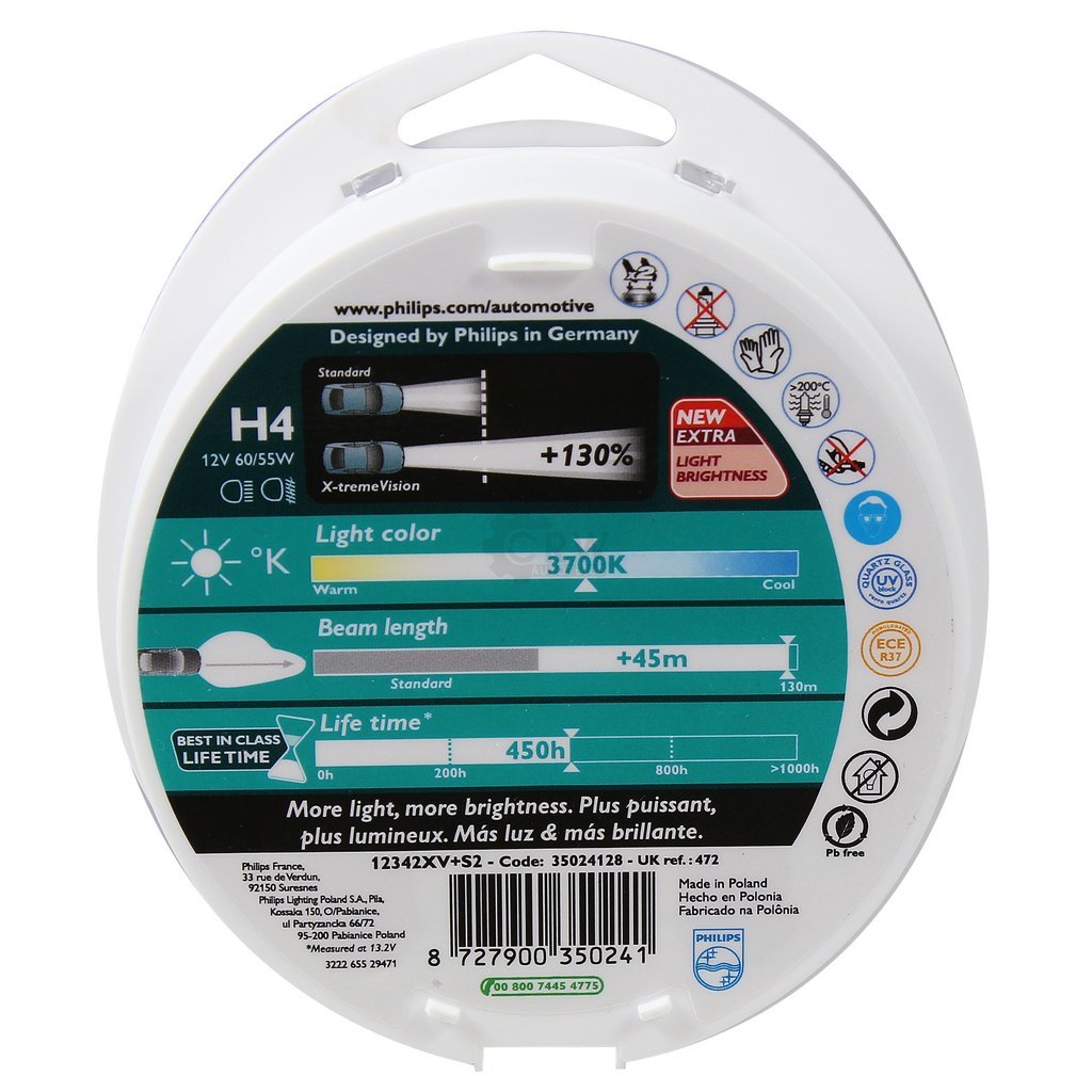

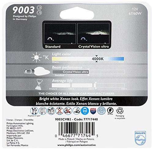

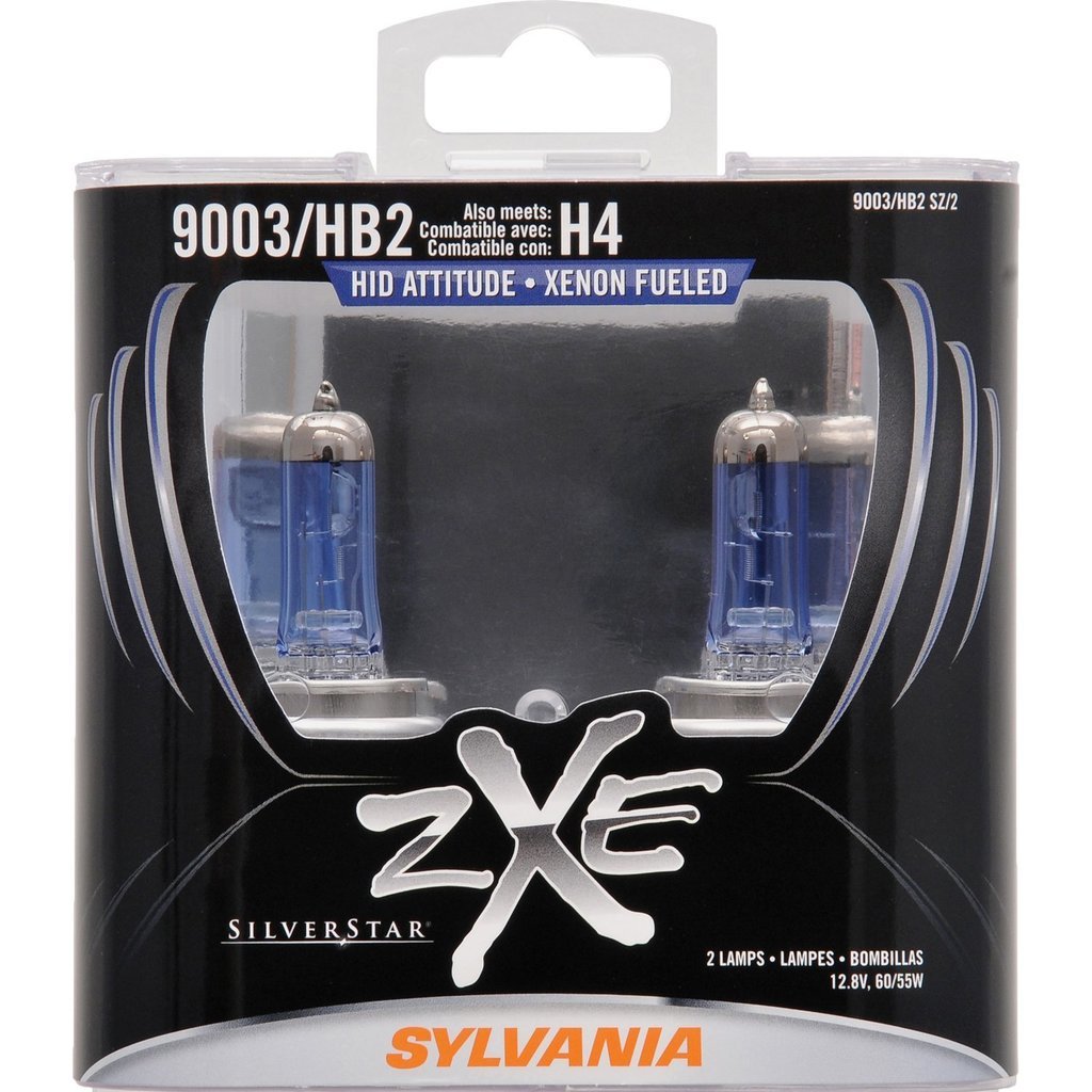

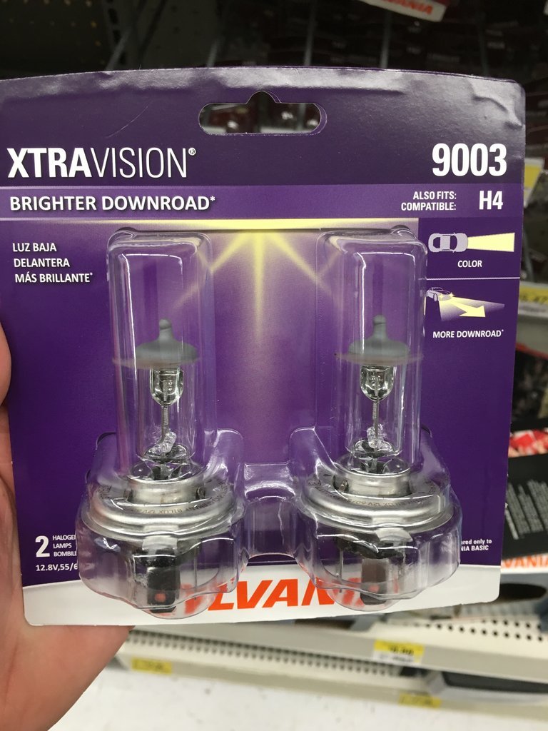

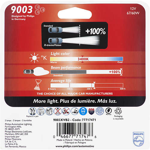

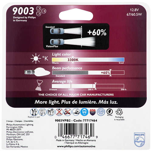

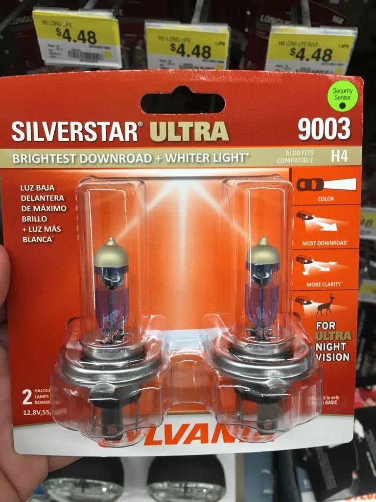

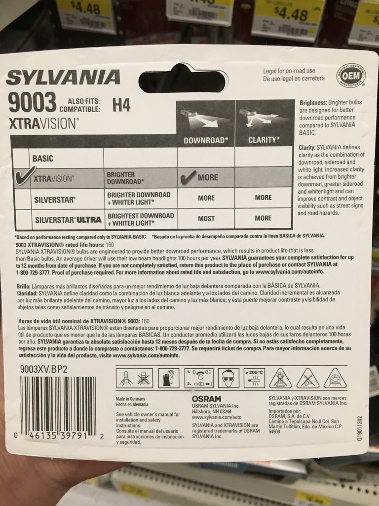

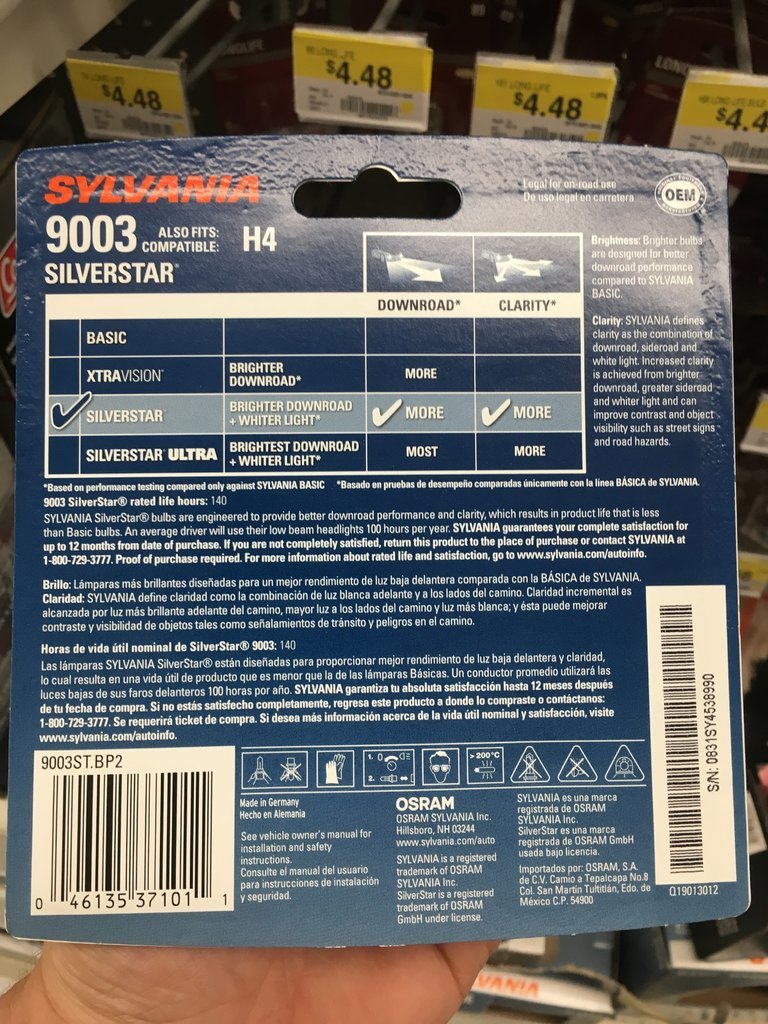

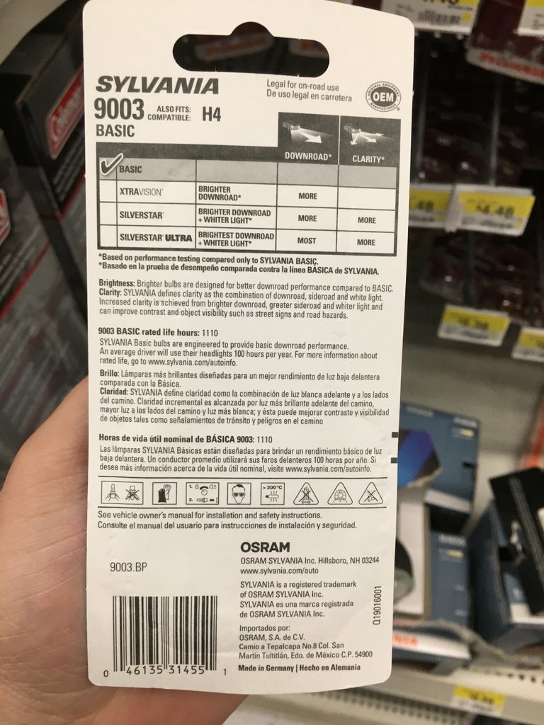

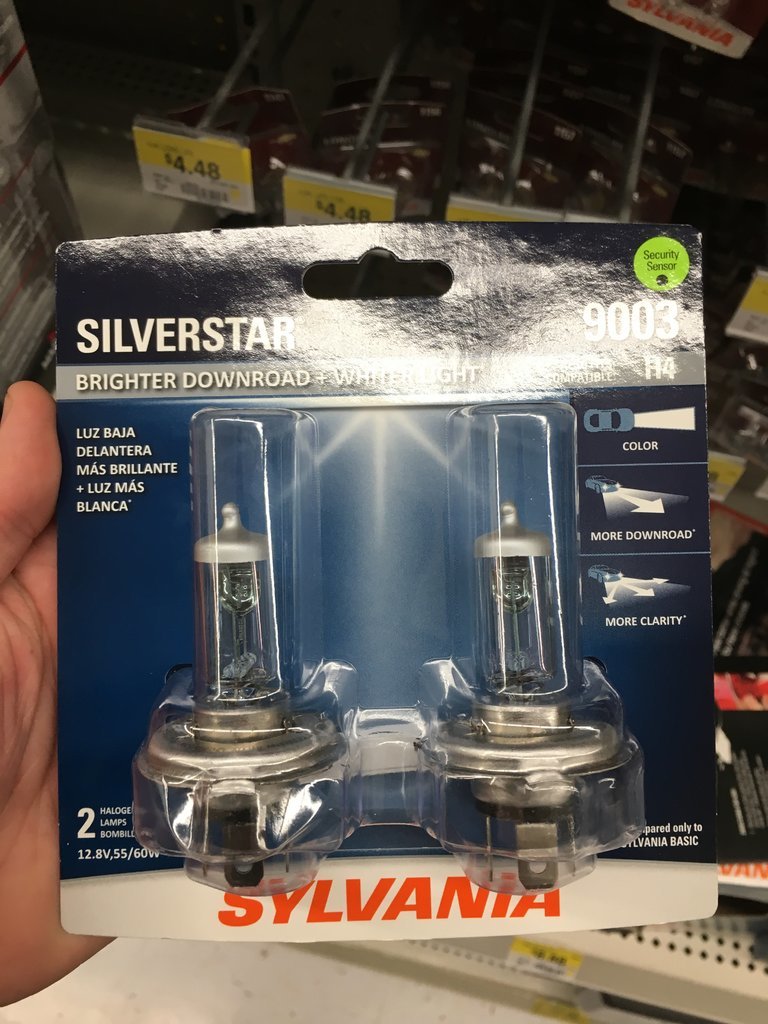

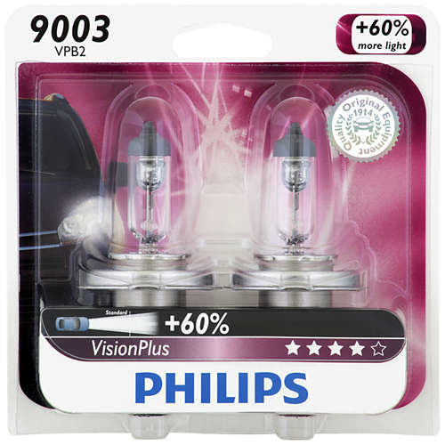

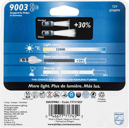

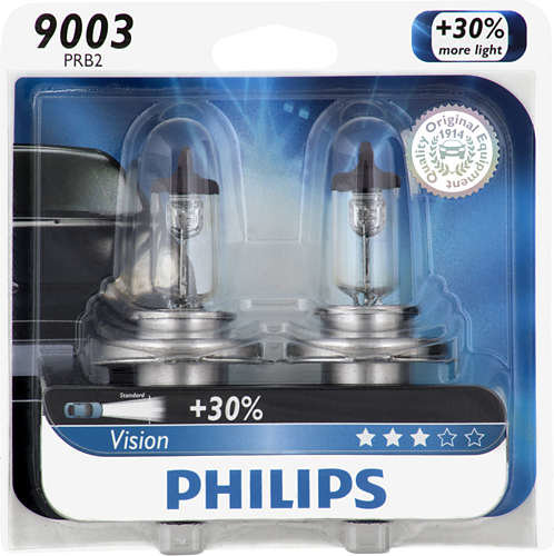

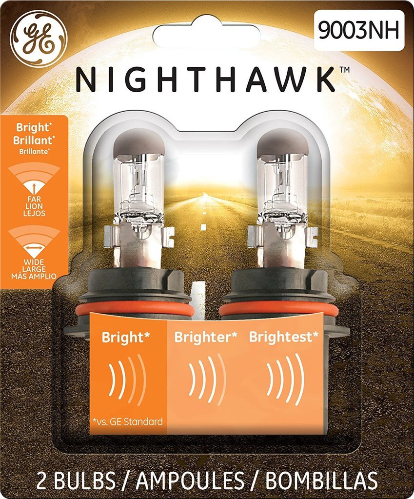

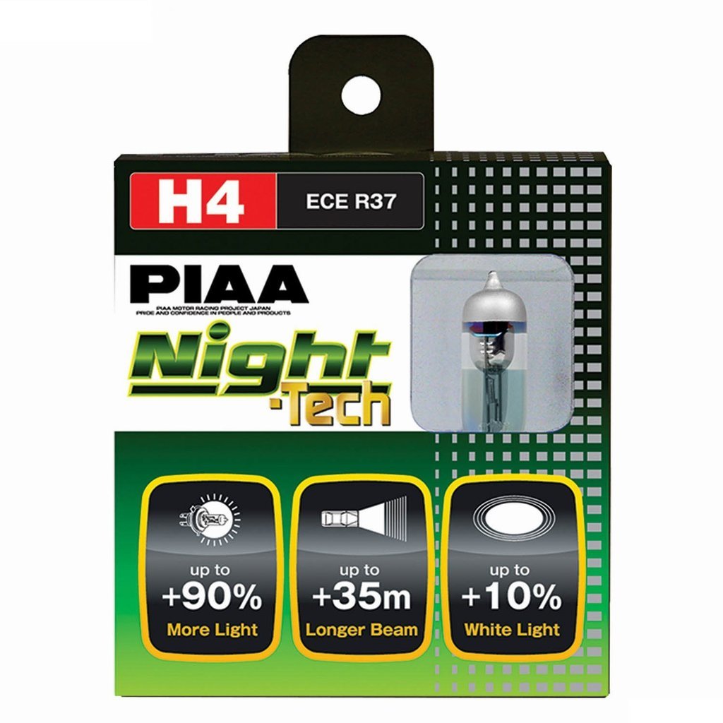

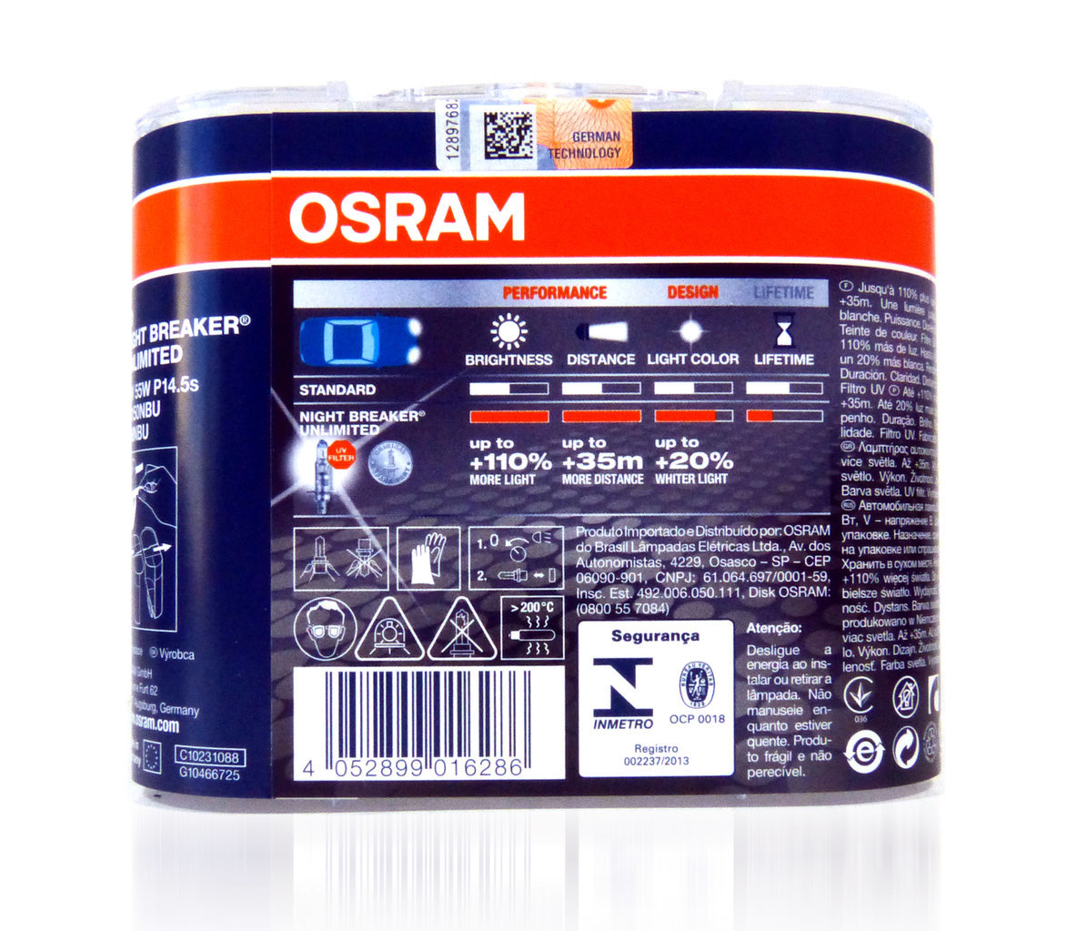

    Bump... I'm looking at the following bulbs. According to the Sylvania packages the average driver will use their low beam headlights for 100 hours per year (that sounds like a conservative estimate, imo), so that should give you some perspective on the expected lifetime of each bulb. I'm thinking that the Sylvania Basic bulbs look pretty good if you are ok with the output of the factory OEM bulbs. Otherwise the Philips bulbs advertise better lifetimes across the board as compared to the Sylvania alternatives. What would you guys and gals buy and why?

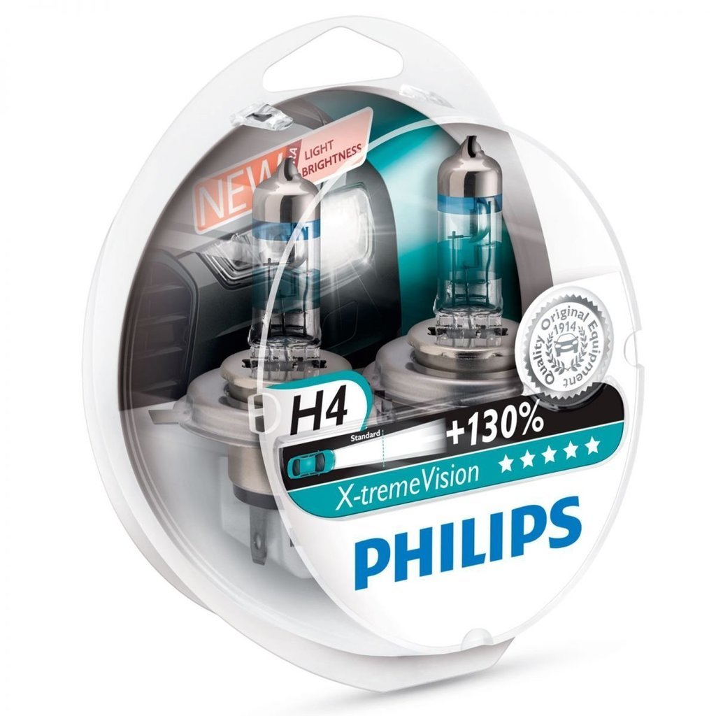

    Philips X-treme Vision +130% Headlight Bulbs (Pack of 2) (H4 60/55W)
    lifetime: 450 hours
    power: 60/55W
    $21.00
    Philips 9003 Vision Upgrade Headlight Bulb, 2 Pack
    lifetime: 400 hours
    power: 67/60W
    $16.08
    Philips 9003 VisionPlus Upgrade Headlight Bulb, Pack of 2
    lifetime: 300+ hours
    power: 67/60.5W
    $15.63
    Philips 9003 X-tremeVision Upgrade Headlight Bulb, 2 Pack
    power: 67/60W
    $26.44

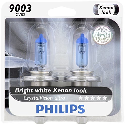

    Philips 9003 CrystalVision Ultra Upgrade Headlight Bulb, 2 Pack
    power: 67/60W
    $26.53
    SYLVANIA 9003 (also fits H4) XtraVision Halogen Headlight Bulb, (Contains 2 Bulbs)
    lifetime: 160 hours
    power: 55/60W
    $19.75
    SYLVANIA 9003/H4 SilverStar Ultra Halogen Headlight Bulb, (Contains 2 Bulbs)
    lifetime: 145 hours
    power: 55/60W
    $43.99
    SYLVANIA 9003 (also fits H4) SilverStar High Performance Halogen Headlight Bulb, (Contains 2 Bulbs)
    lifetime: 140 hours
    power: 55/60W
    $33.75

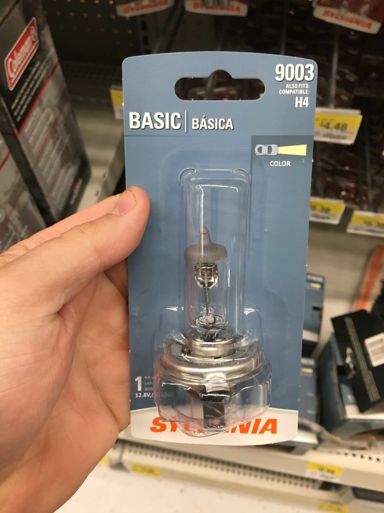

    SYLVANIA 9003 (also fits H4) Basic Halogen Headlight Bulb, (Contains 1 Bulb)
    lifetime: 1110 hours
    power: 55/60W
    $8.75
    SYLVANIA 9003 (also fits H4) SilverStar zXe High Performance Halogen Headlight Bulb, (Contains 2 Bulbs)
    lifetime: ? (not great I'm assuming)
    power: 60W/55W
    $50.83

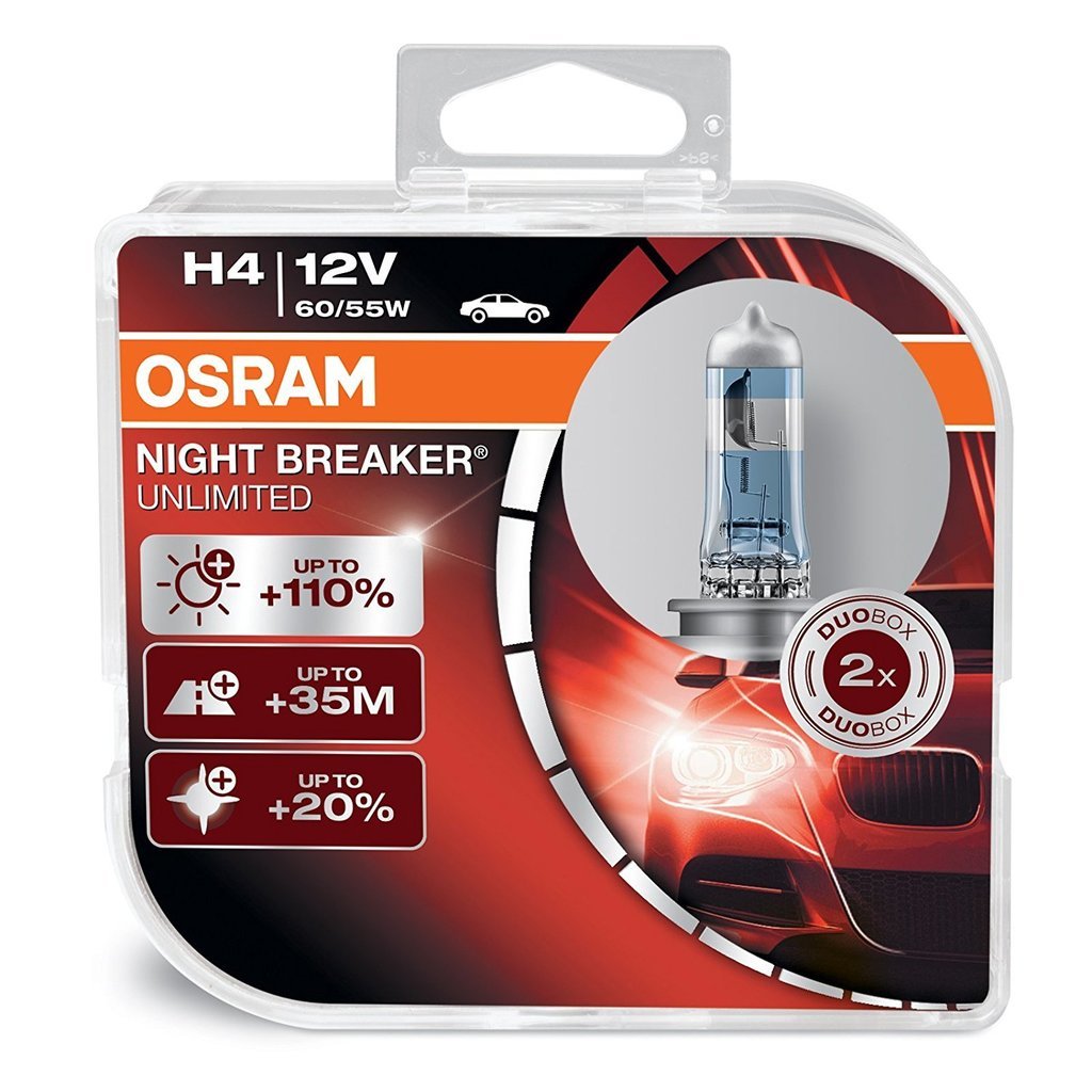

    OSRAM Night Breaker Unlimited H4 (Twin Pack)
    lifetime: ? (~50% less than a standard bulb according to the package)
    power: 60W/55W
    $21.90
    PIAA 10704 H4 (9003 or HB2) Night Tech High Performance Halogen Bulb, (Pack of 2)
    lifetime: ?
    power: 60W
    $45.55

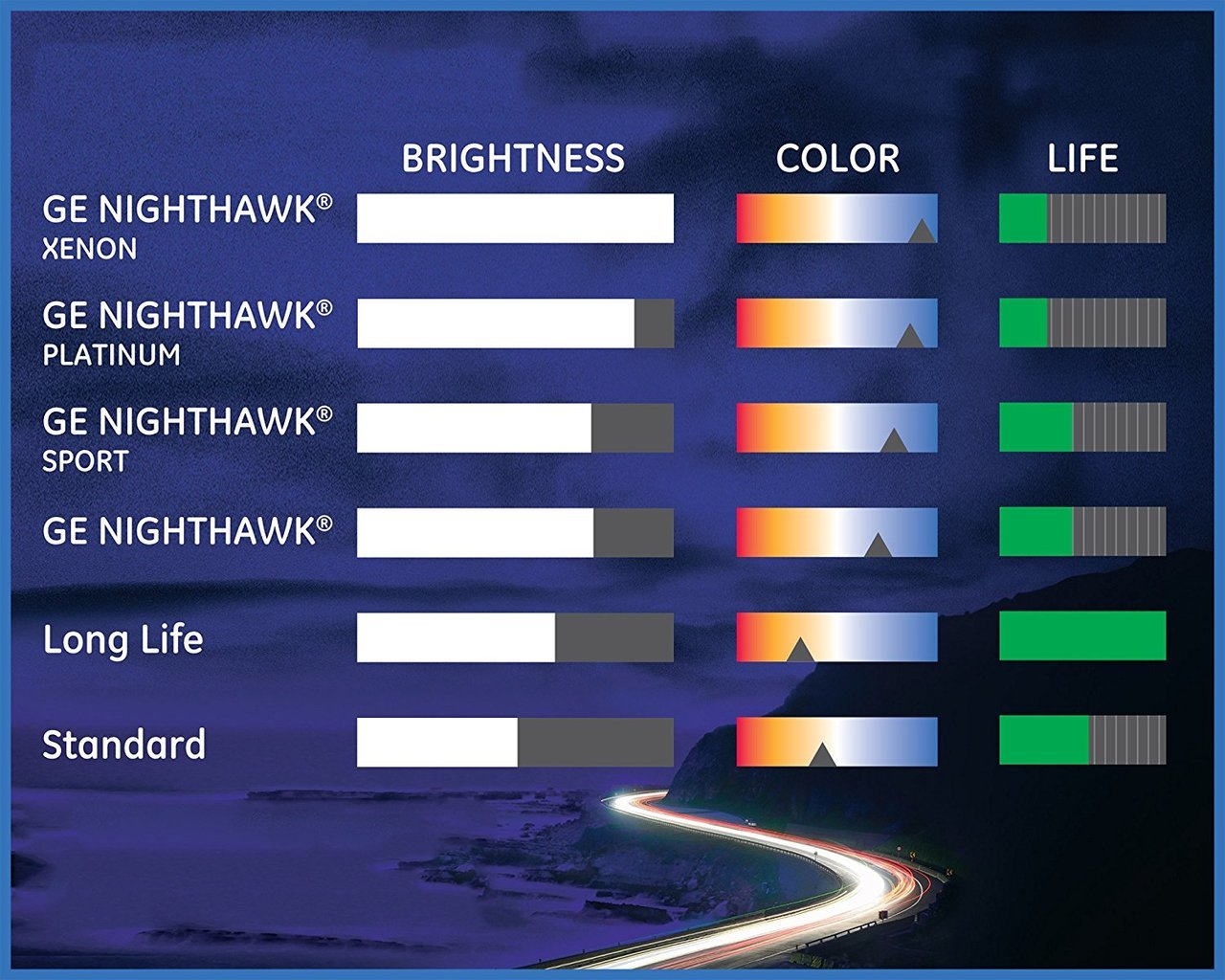

    GE Lighting 9003NH/BP2 Nighthawk Halogen Replacement Bulb, 2-Pack
    lifetime: 150/800 hours (see here)
    power: 67/60W
    $29.71
    GE Lighting 9003 NHS/BP2 Nighthawk Sport Replacement Bulbs, 2-Pack
    lifetime: 200/800 hours (see here)
    power: 67W/60W
    $18.67

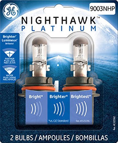

    GE Lighting 9003NHP/BP2 Nighthawk Platinum Halogen Replacement Bulb, 2-Pack
    lifetime: 125 hours (see here)
    power: 67W
    $51.84

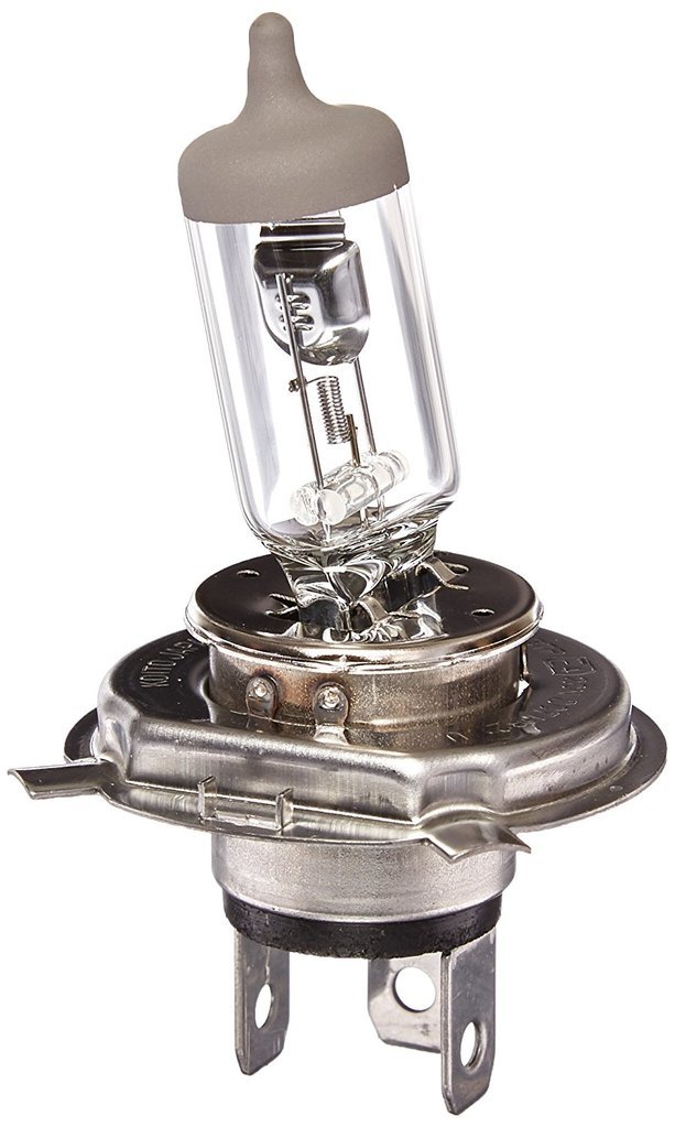

    Genuine Toyota 90084-98033 Bulb
    $28.69
    Just out of curiosity I looked up the bulb from my local Toyota dealers online parts sales site, Part Number 9008498033, $23.44 each plus tax.
