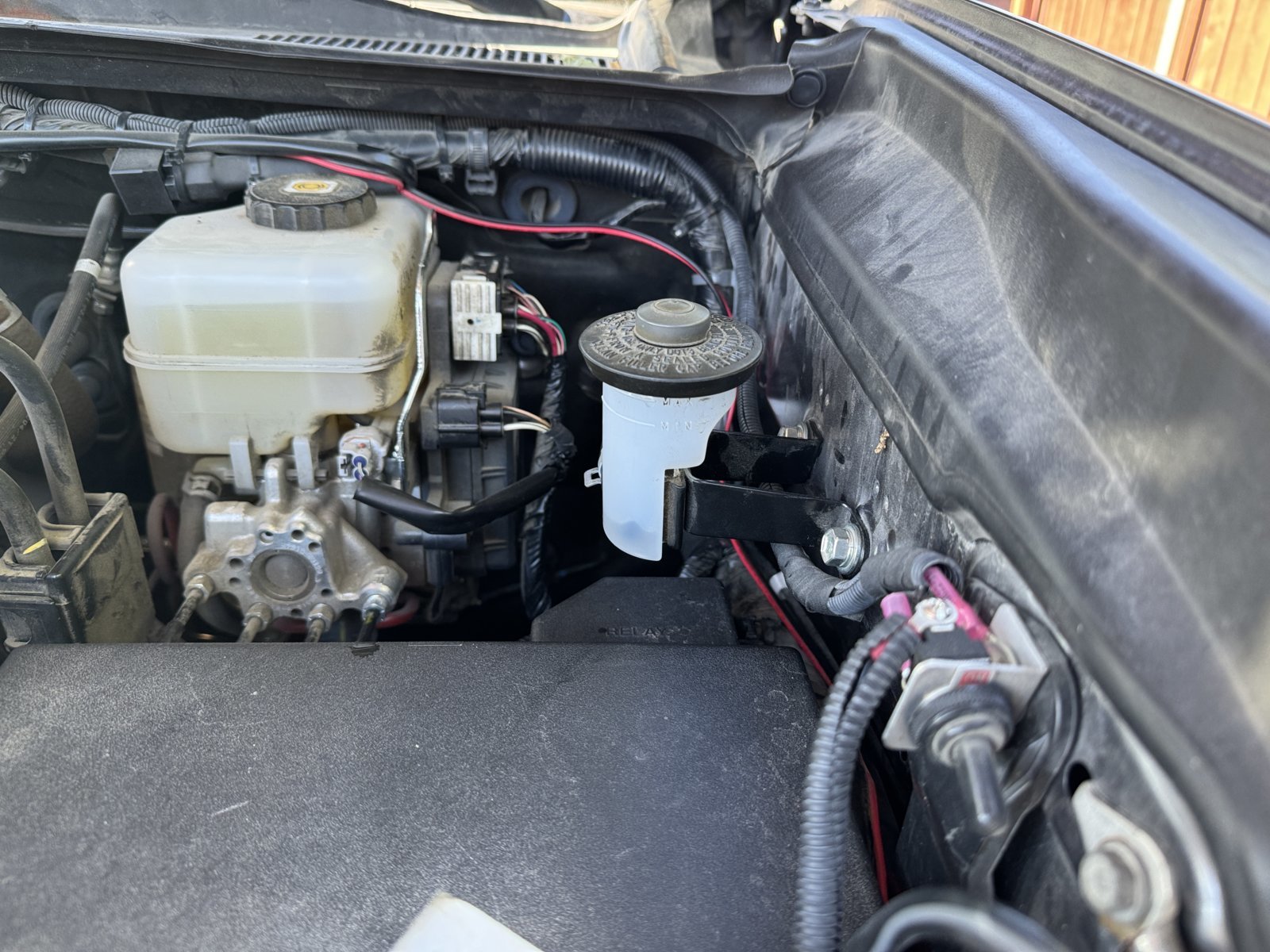

    BLtheP
    BLtheP Constantly Tinkering Member
    Apr 5, 2022
    #394355
    4,644
    Plano, TX
    2021 MGM TRD On-Road DCSB MT
    RC60F Transmission ADD delete with FJ full-time tube FJ Metal Clutch Pedal OEM Mexico-Spec Condenser Fan 265/70R16 Michelin Defender LTX M/S 2 OEM 1-Piece Lug Nuts Custom Built Switch Panel for all Electrical Accessories Rigid Amber Pro D-SS Ditch Lights Rigid 30" SAE High Beam Driving Light Bar Rigid SR-Q Pro Back-Up Light Kit (Recessed) VLEDS Tail Conversion VLEDS Foot Well Light Kit KC HiLites Cyclone V2 Under Hood Lights Operable (Switched) Clutch Safety Bypass
    Your driver side rod is hooked in right where the off-road and pro manual transmission clutch fluid reservoir would be. That’s why there’s been so much discussion on that in this thread. Just thought I’d clarify.

    A picture says a thousand words!
    Reference is always helpful.
    EDIT: I don't believe the reservoir protrudes to the point of crowding the sidewall.

    Is that OEM or did you install that?
    Looks out of place.

    BLtheP
    Apr 5, 2022
    #394355
    4,644
    Plano, TX
    Factory for any manual transmission with the hydraulic booster, aka TRD OR and TRD Pro.
    The manual transmission Sports pull their brake fluid for the clutch from a nipple on the master cylinder reservoir. Hydraulic booster trucks don't have the same master cylinder type of setup.

    Still....doesn't look like it would get in the way of the strut movement.
    But that's just my guess.
    Taking a closer look it looks like your strut is just barely mounted above the holes the reservoir. My first look made it seem like your strut is using one of the reservoir holes. So it would actually possibly work. I dunno, no personal interest in struts, and the OP has a Sport so his will be fine regardless.
