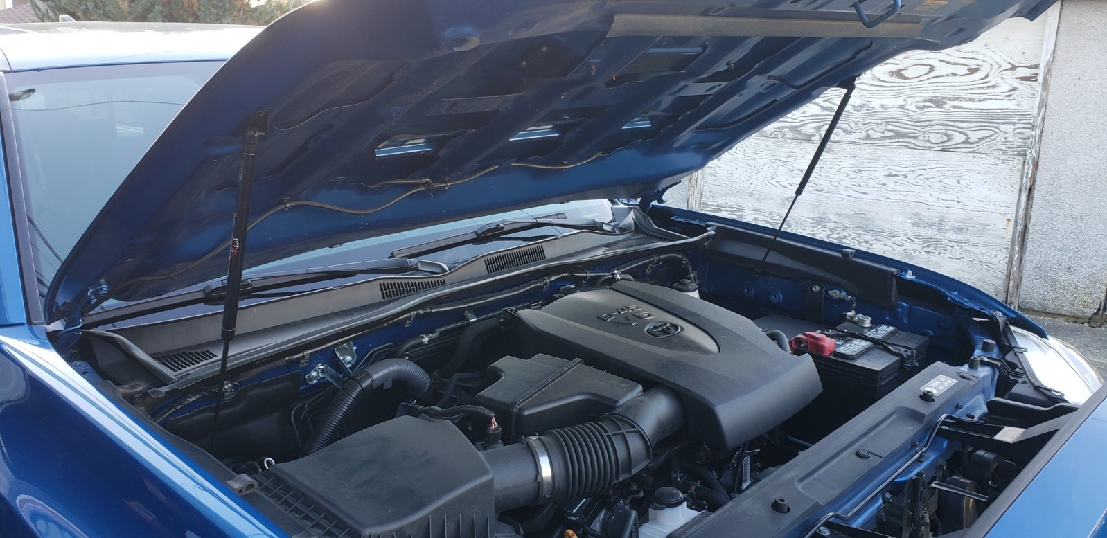

    I have the Redline Tuning struts. I have a 2017 TRD Sport with manual. They fit fine.
    Regardless of style you get, if you have to drill holes to mount them, make sure you treat the holes with some paint or similar sealer to prevent rust. I used a self etching primer and then top coat paint using a cotton swap to apply it.

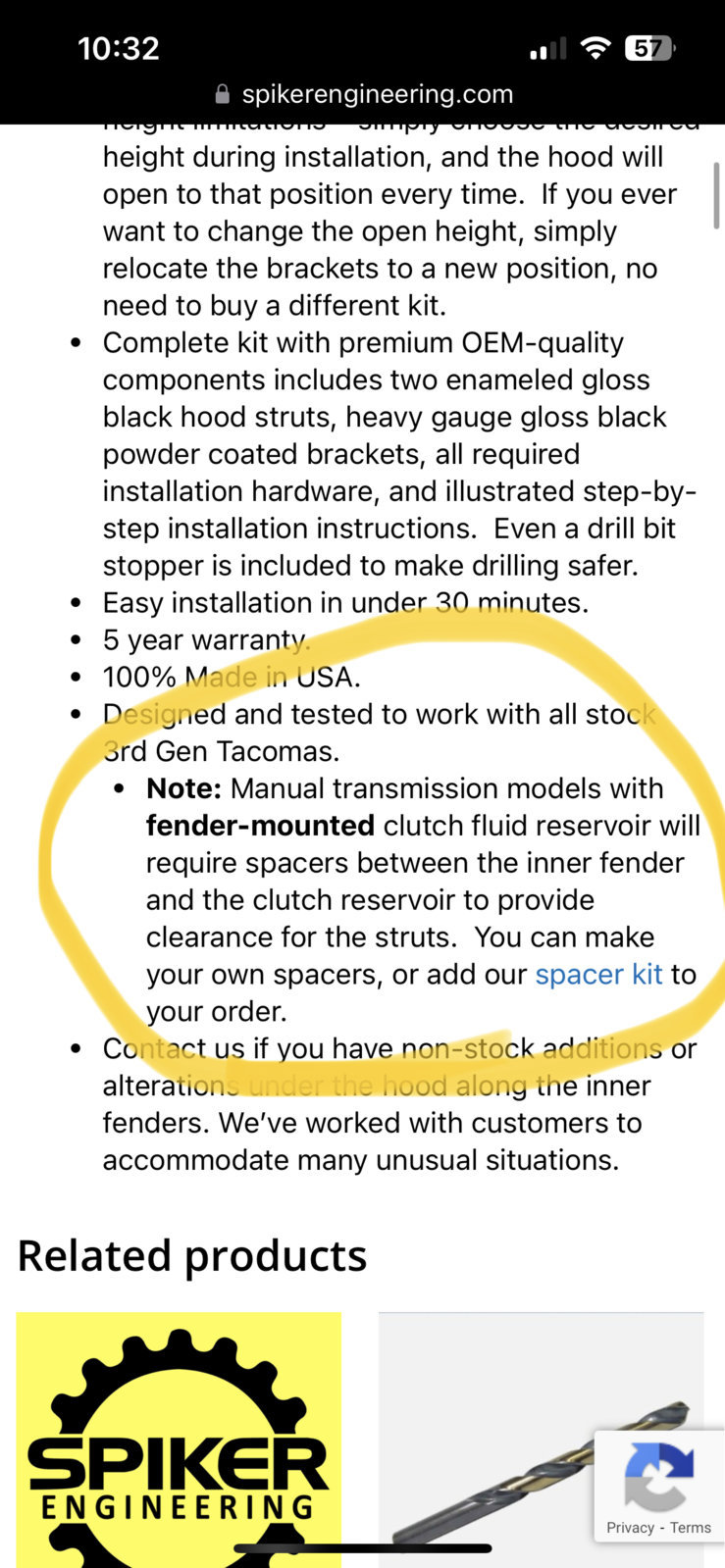

    For the people in this thread commenting without reading replies to OP.
    TRD Off Road 6MT trucks require spacers for the clutch master cylinder reservoir to clear the strut. From Spiker, the spacers are an additional cost.

    I see 2 mounting points for the reservoir on the driver's side; I see it on my engine bay photo too.
    The OR has a different set up Master Cylinder than the Sport.
    Still...it would be nice if someone had a photo with struts installed on an OR, manual.

    As stated by others, the fender mounted clutch reservoir gets in the way of our hood strut kits, so a ~1/2" spacer is required to provide the needed clearance.
