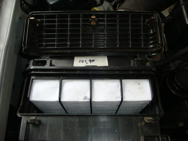

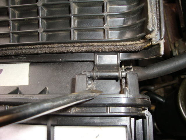

    I know I'm new to this forum, and perhaps ignurnt, but while examining the airbox for the deckplate mod I noticed the topside trap door to remove/insert the air filter. I popped the door off easily at the hinges and presto...a free flowing air supply directly above the air filter. This gave me at least 2 mpgs when I don't stomp on it to get it to make that cool sound. :)

    Post a pics of what you did.

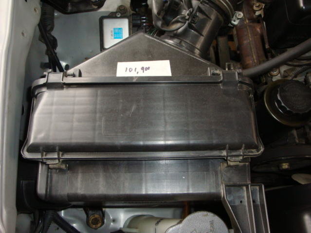

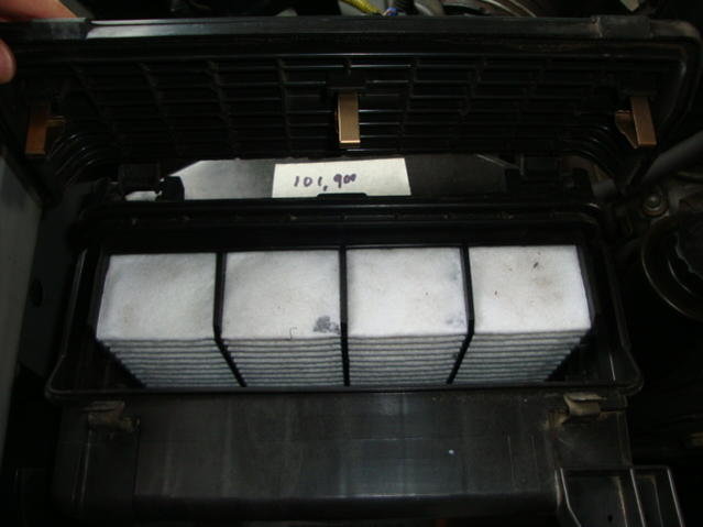

    I think he means simply the OEM access door to R&R the stock filter. It just hinges open at the top. This gives you a 3" by 10.25" opening (30.75 sq. in.). No cutting or mods involved. (see attached pix)
    A deckplate mod using a 4" dia. deckplate gives you about 12.5 sq. in.
    So just opening the top gives you almost 3 times the open space for inflow.
    The only difference is the direction of airflow. Opening the filter access exposes the top pleat of the filter, which fills about half the opening and would take most of the airflow, whereas the deckplate is a nice distance from the filter that gives air a chance to disperse across the entire face of the filter pleats fairly uniformly.
