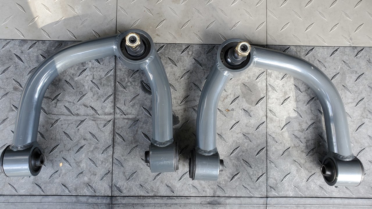

    JD Fab. They make a ton of great stuff. Got them during the group buy. May have been better priced than every other one
    I believe it’s sealed and greasable zerk fitting. So no exposed uniball to squirt oil into. I already have a grease gun with red n tacky I use on other stuff like propshaft etc

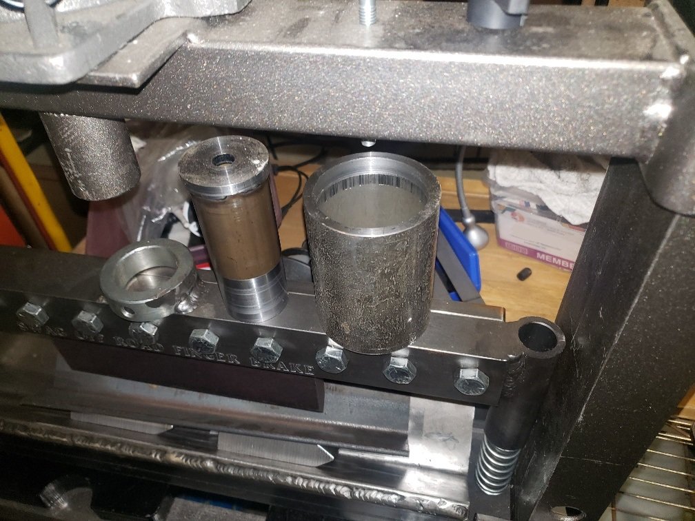

    I rebuilt my LCAs last year, trying to solve front suspension noise, in principle it's not too bad of a job. You can make modest improvements to the stock arms by installing urethane bushings with grease fittings, and welding on reinforcements to weaker areas.
    Here's my suggestion for that route: Unless you are certain your bushings are OEM, go for the Whiteline bushings, not the Energy Suspension. Nothing wrong with ES, but if someone already swapped your OEM bushings out with Moogs or other aftermarket, those have undersized inner sleeves vs. OEM, and won't work with ES. But, if you DO have OEM bushings, then I think the ES ones might be easier to install.
    I encountered this problem last year and have been trying to find some OEM inner sleeves ever since. In fact that reminds me, I should bump that thread...
    I didn't have time to source the correct sleeves (or alternative bushings) so I just smoothed over the jagged parts of the improvised sleeve with a lathe, as best I could, and threw them back together. As for the rest of the rebuild, I tapped in grease fittings for the bushings, bored grease channels into the urethane, welded reinforcements over the bushing eyes, blasted and POR15ed the arms, and pressed in new ball joints.
    So except for this stupid and bizarre problem with aftermarket inner sleeves, it's pretty easy to rebuild the stock LCAs, so long as you have a bottle jack, a torch, and a press with ball joint adapters.
    In fact I'd say the ball joints are the bigger pain in the ass than the bushings. They're an odd size. I bought and returned a couple of "master" ball joint press kits and not a single sleeve fits these control arms. In the end I had to buy a piece of steel tube and bore it to the correct ID in a lathe. You also need heavy-duty snap-ring pliers, the interchangeable-tip ones from Harbor Freight aren't strong enough, or at least mine weren't.
    I'll see if I can find a picture, but so far all I could find is this post from rebuilding the UCAs which was also delayed by needing to machine the press adapter. Similar story with the LCAs, but if I recall, I needed a piece of 2-3/4" OD tube, bored to slightly over 2.5" ID to clear the lower joint. I'll update this if I can find it.
    Edit: Here's what worked for the LBJ, bore the ID to 2.520" A regular ball joint press kit will work for the other side (the basic kit with only a handful of sleeves). The "master" kits were useless for me on this job.
    Note that this is for the 4x4, and also might be specific to my choice of aftermarket ball joints. I bought the most expensive ones you can buy on Rock Auto. OEM ball joints are excellent too, but as far as I know, you can't buy OEM replacements. You have to get the whole control arm. I would not recommend Moog parts here, I chewed one of their ball joints in under 10k miles, and am still pissed about the bushing sleeve thing. I've got about 15k miles on the new ball joints and they are still nice and tight. Mostly off road.
    I recommend either OEM control arms, or rebuilding yours if you are looking for modest improvements including urethane bushings, grease fittings, and whatever reinforcements you want to weld on there. You could even have them powder coated, and still spend less than new arms, and thousands less than the fancy welded steel ones. I'm sure those are great, but if I was spending that much money on lower control arms, I'd want to buy the extended length ones (and the rest of the kit) for a more tangible benefit.
