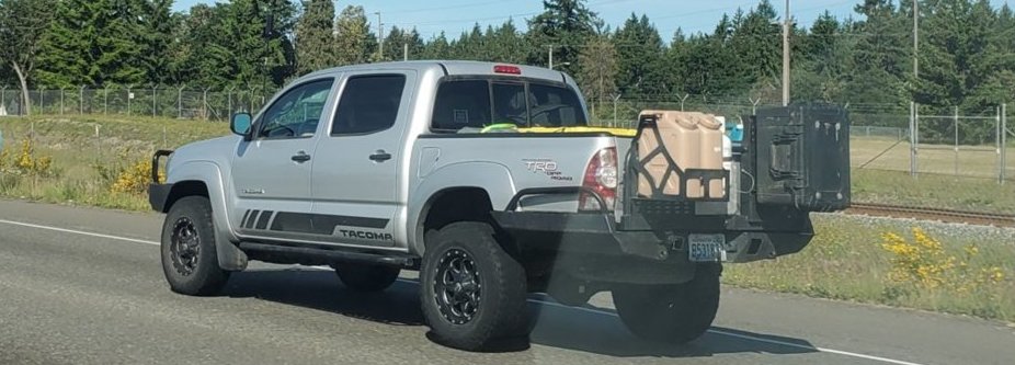

    Deaver U402 Expedition Stage 3 is what I'm running. Love them. I originally had an AT Habitat plus swingout, etc. You can see in the first pic below I had a lot of rake, and that was fully loaded for camping, including 150lbs of water in the bed near tailgate or on the swingout.

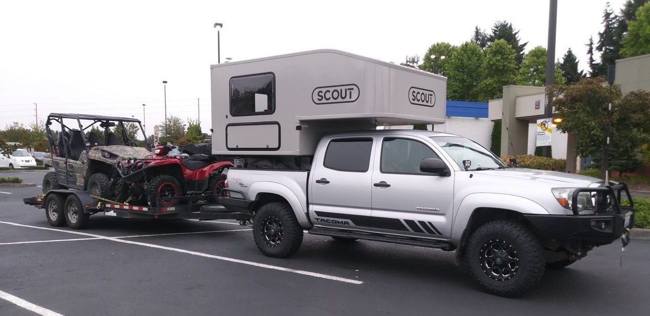

    Here I am loaded with... lets just say a LOT of weight ;), and it sits level. I'd add up what you plan on running normally and figure out your load and decide on Stage 2 or Stage 3.

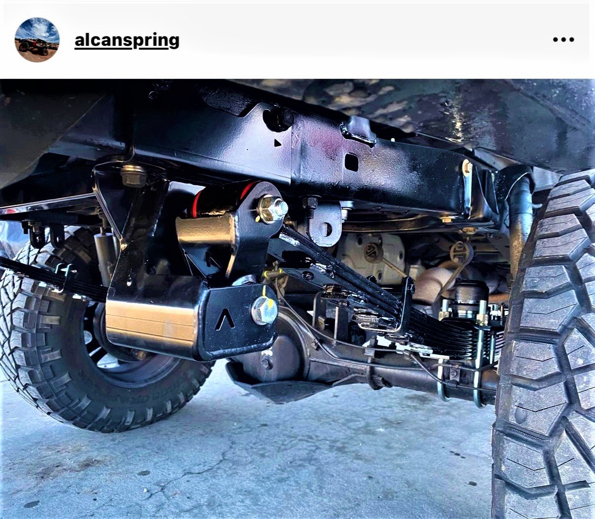

    Highly recommend a custom built set of ALCAN Leaf springs - love mine -

    What kinda pricing for Alcan? I've heard good things, but don't seem to find any off the shelf items listed anywhere. Obviously you said custom, but unless there is an odd use case, custom isn't necessarily worth the extra cost.
  8. Jun 14, 2022 at 10:53 AM
    dpf88101
    dpf88101 Well-Known Member
    Sep 21, 2020
    #341518
    359
    I will have to go back and look at my invoice - install was $400 at their shop, but they also installed all my Archive garage hammer hangers, cross bar, ubolt flip kit etc. Was about 5 hours of labor involved.
    their price was comparable to Deavers etc. If someone is interested I would call and speak with Lew (owner) and tell him what you need/want. I required (based on Weigh Scale ticket) 1000lbs over stock (I am 920lbs constant in the rear) plus he built 5" lift/arch for my lift. I drove up to Grand Junction Colorado from New Mexico and had them complete the install to save on shipping charges and any possible reshipping charges if something wasn't correct since I was dealing with lift and weight issues/concerns and having them do it at their shop allowed/enabled them to make adjustments/corrections on the fly etc.

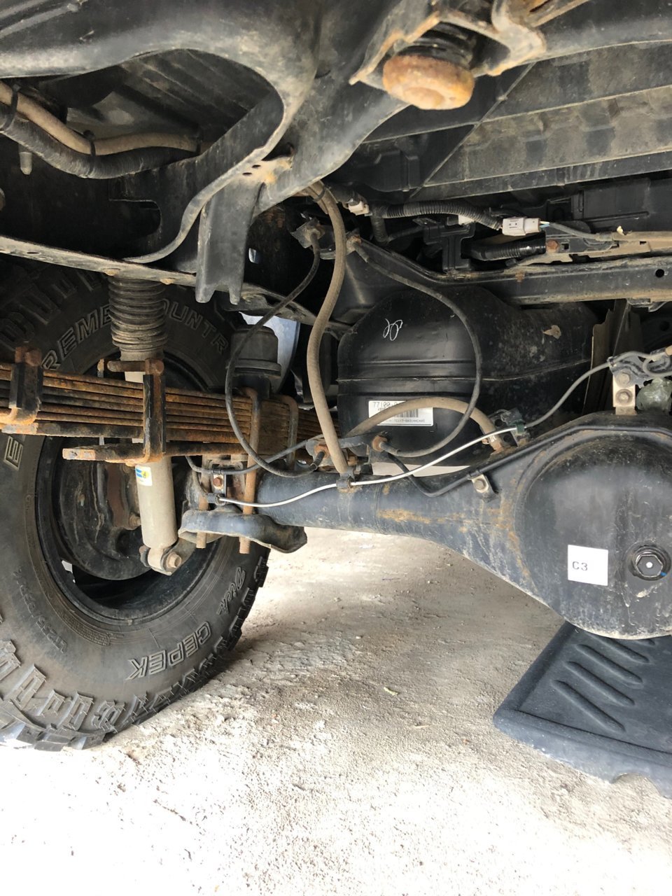

    I went from a medium Dakar pack to HD's with the exact setup OP is going towards... Cap, steel HC rear with a swing out, dual jerry cans and a 35" spare.. after a year the HD leafs looked like a W (~~) and performed like dog shit. I ditched all of the setup and have a tray now but went with some Deaver stage II's and am really happy with them. Buy once cry once, and of course, YMMV.

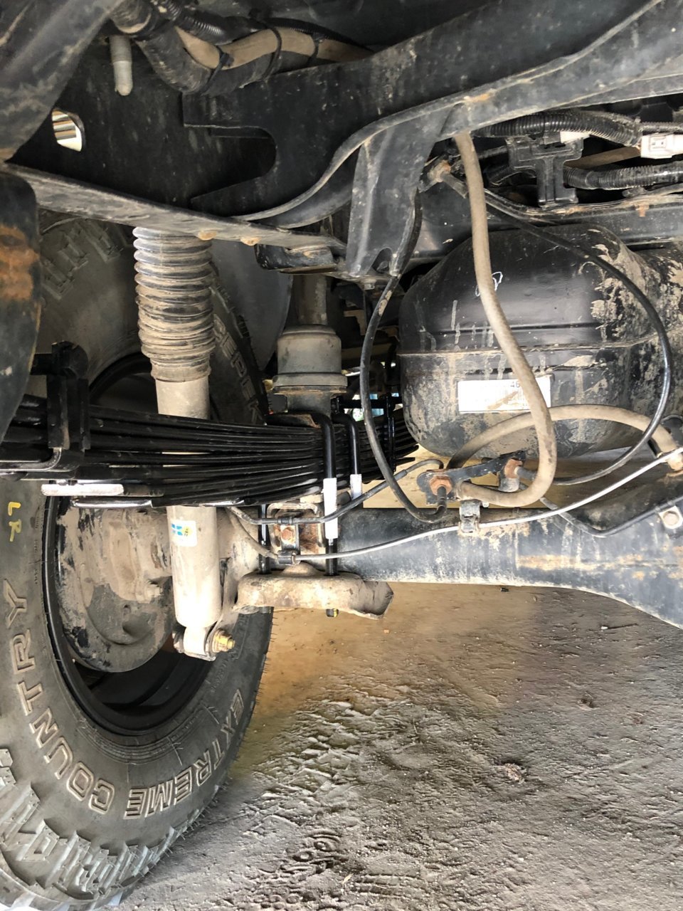

    @tacotruck93

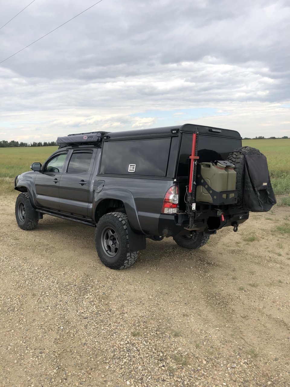

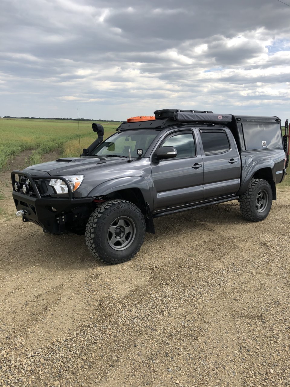

    Dobinsons….likely 111-R or 112-R if you have lots of weight. My old setup was Dakar leaf pack with an aal for 8 total. They looked like a “w” and didn’t hold my weight well. I switched to the Dobinsons 112-R with their aal for 8 total. I probably didn’t need the aal since they handle the weight better than the Dakars but I didn’t want to have to add a leaf after. My truck fully loaded still has a bit of rake which is good for me. Plus, if I ever add extra weight it won’t be an issue. Right now I’m 7k+ loaded. @Crikeymike is the go to for Dobinsons.
    Truck fully loaded with Dobinsons
    Dakars 80% loaded. Fully loaded I couldn’t fit the tip of my finger between the frame and bump stop.
    Dobinsons fully loaded
