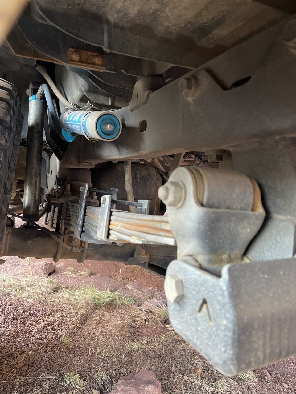

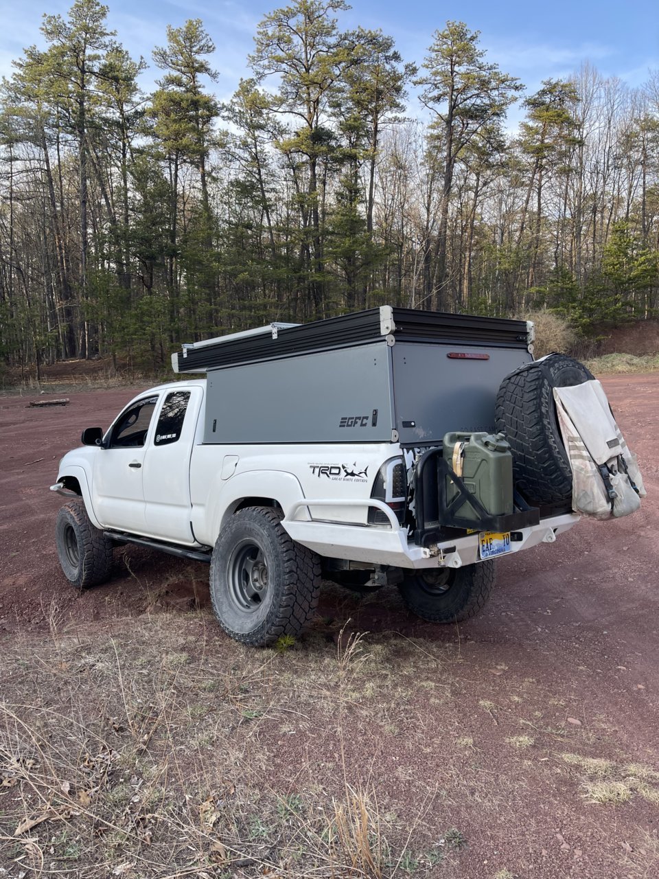

    My OME HD + AAL are in a W shape now. Im right at 650-700lbs constant weight with GFC, steel HC bumper, dual jerry cans, and a 35" spare.
    I have Deaver Stage 3 waiting to go on.
    The OME weren't horrible in the few years that I've owned them.
    Pic is full stuff + camping gear:

    Awesome, I hope those stage III's work for you! The II's for me have been fantastic. Your truck looks great!

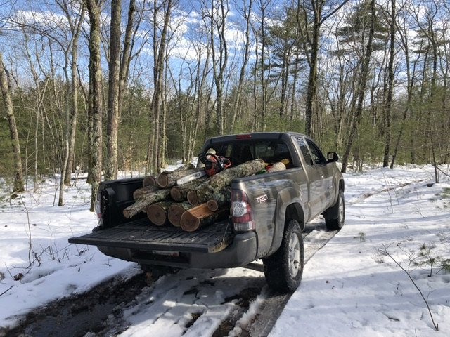

    I had some general spring HD leafs put on. Works good for what I do which is load her up with firewood and haul it out of the trails. OME 884/5100 in front and a full bed of green hardwood sits me level. Pic wasn’t quite a full load but it was all green white oak which is heavy as heck. A freighted load of rock maple leveled me. Works great and price was like $5-600
