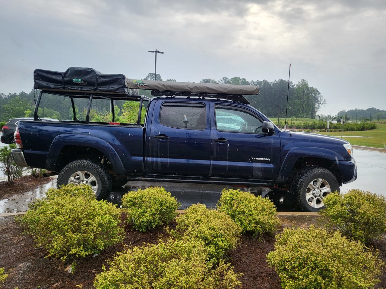

    I am running the Dobinsons HD leafs. No squeaks or problems at all.
    This was with a Decked, camper shell, and full skids/sliders with 255/70/17
    This is with bedrack/RTT, skids/sliders, 33/10.5/17 with matching spare under the bed and empty bed

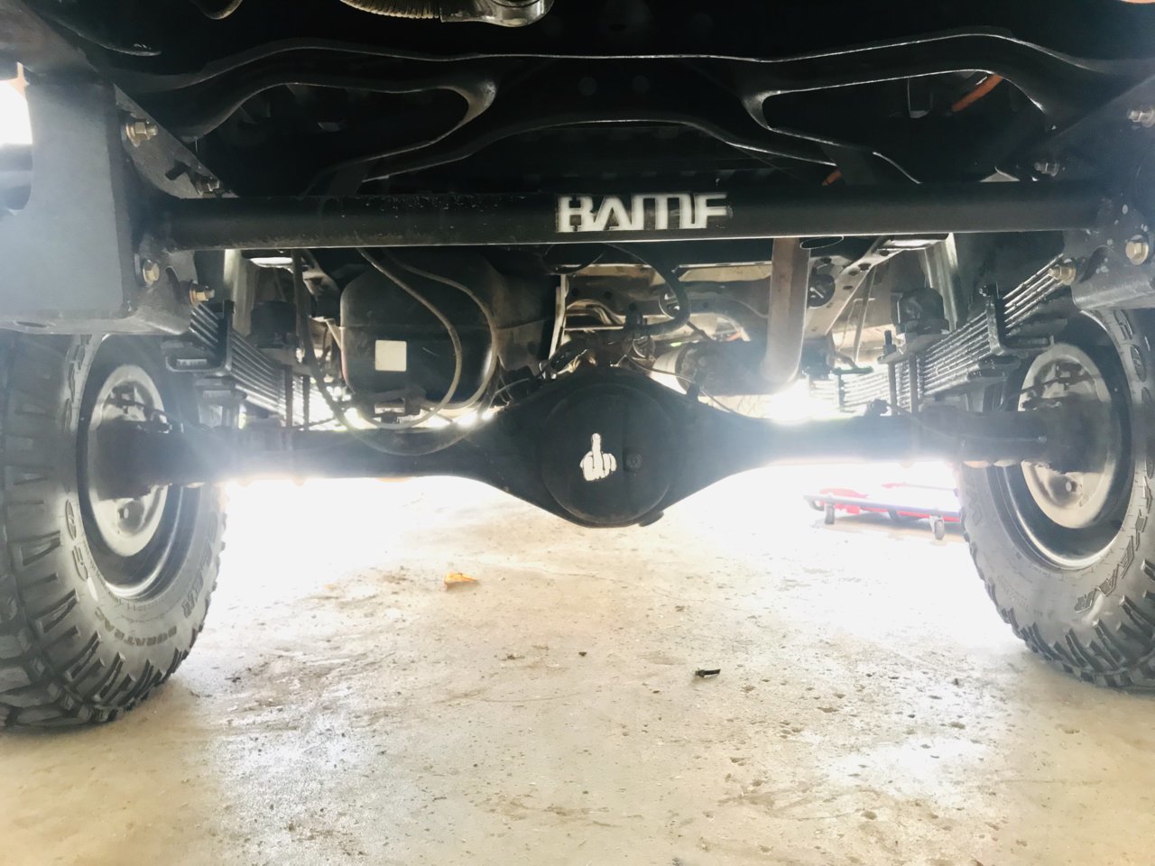

    I have deaver stage 3's with the BAMF shackles and hangers with a cross member

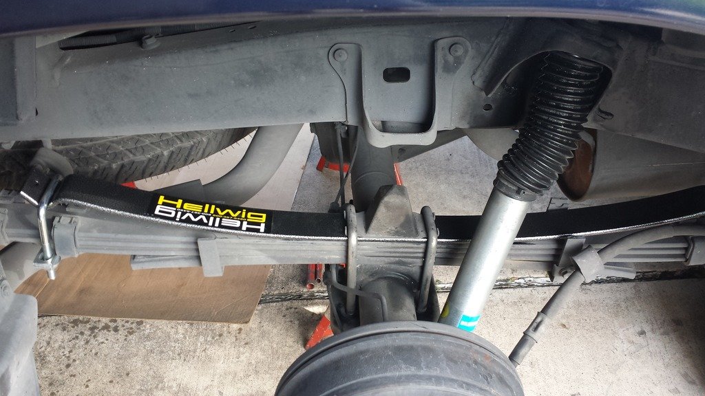

    Since you already have sag with a new leaf pack, have you thought of helpers?I invested in these for about a $100 and they are great. They only took about 2 hours to install..and you maintain factory ride until you have a heavy load. Completely adjustable, you just tighten the u bolts that come with the helper...I got these to prevent flat springs and they work. I have had them for close to 9 years with no issues and carried 1000lb loads here and there with no problems. I know Sumos are a much popular option, but that isn't going to help your flat spring/sag issue. No squeeks either.
    http://www.sdtrucksprings.com/hellwig-981-ez-990-helper-springs-toyota-tacoma
    Good Luck
