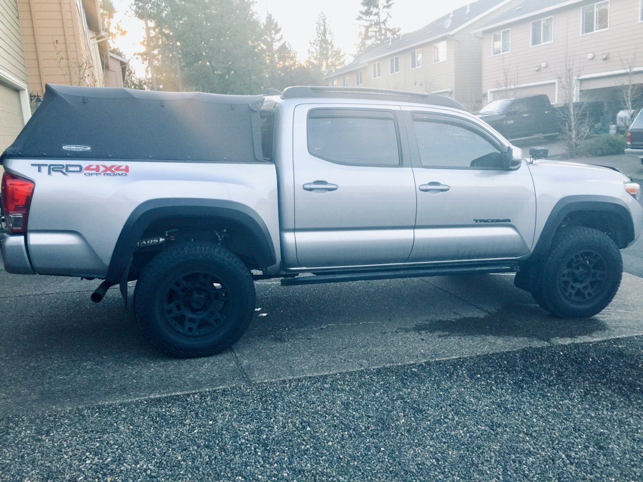

    I filled up my large cooler with water and additional 60lbs of wood and I didn’t notice too much change. Maybe the shocks are stiffening up the ride as well.
    I think I may just pull the third leaf and see how it goes.

    Nice truck. Any plans black vinyl on your wheels?
