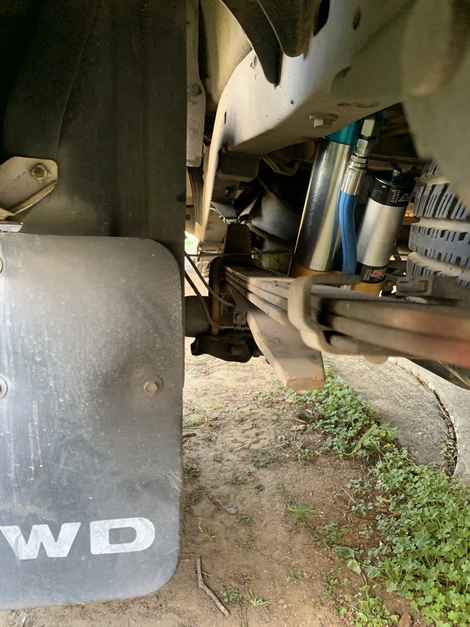

    That's correct, I ran a 1" lift shackle on my stock springs and ran with 5100s. Gave me roughly an inch of lift, which because my springs were worn, probably just returned them to stock height, lol. The lift shackle doesn't affect the ride at all (vs. an add-a-leaf). I mean I guess they technically do, but nothing noticeable.
    Although for a 1.5" lift, The Deaver J59s are the bees knees. I'm currently running a combo of the J59s and my lift shackle from before for ~2.5". You pay for that, though. You're looking at like 2x the cost for the Deavers. If you want a decent "back to stock" ride, the Generals and the shackle lift are going to be much more economical.

    I have the Deaver J59s and Bilstein 5100s combo in rear, typically with no weight, and they ride excellent and provided about 1.5" of lift after settling. My truck was about an inch higher in rear than front stock, so with the Deavers lifting the rear 1.5" and Kings up front lifting 2.5", I got a level ride. I also added Wheelers Superbumps.

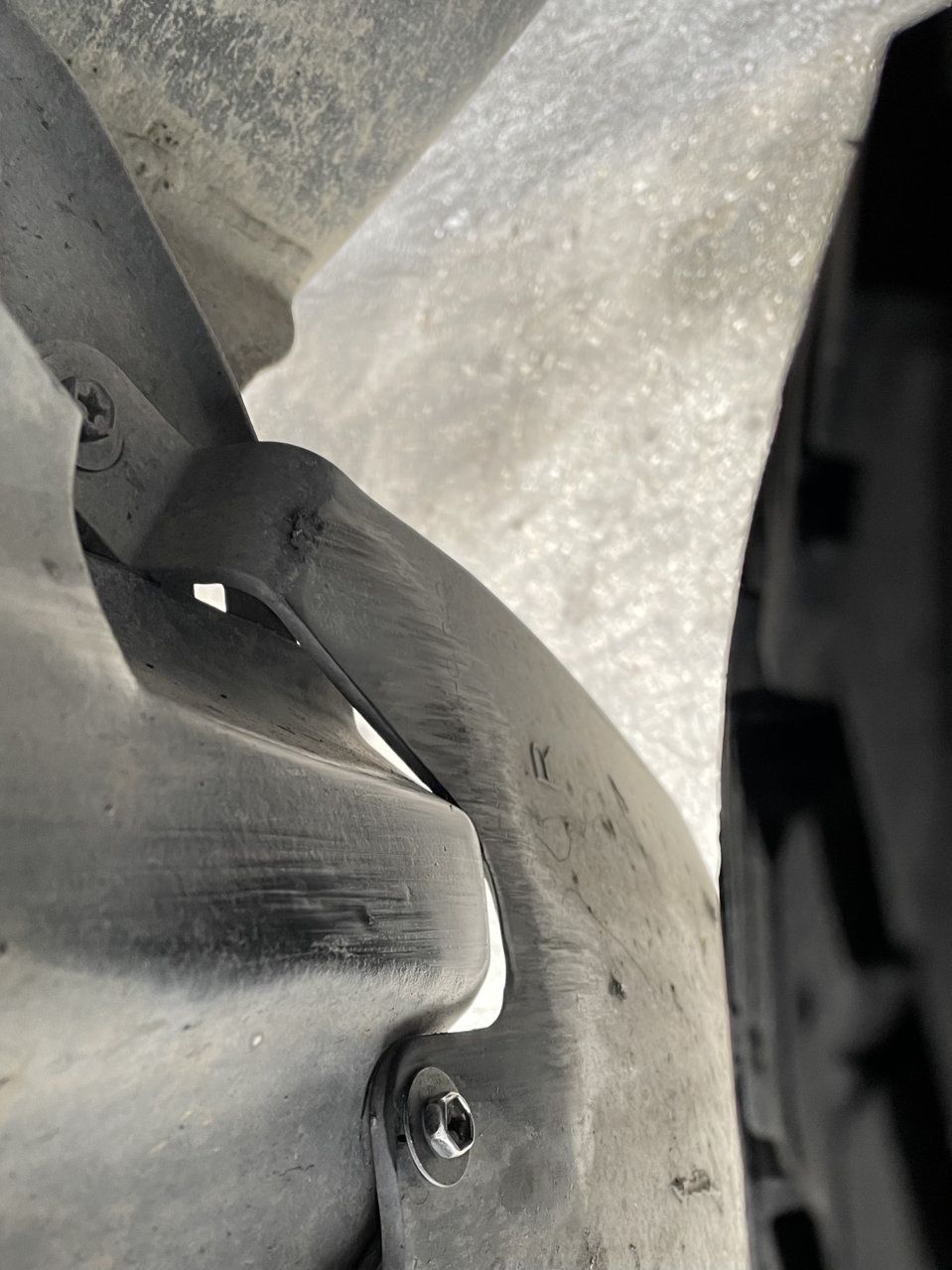

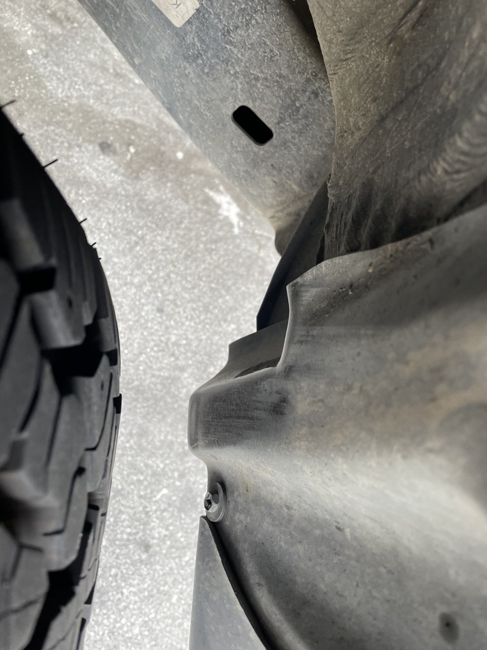

    Yes they the 17” TRD Pros with 265/70-17 General Grabbers...
    It’s rubbing on the plastic on the inner fender but only runs when I turn the wheel a lot or if I try going into a driveway too fast with the wheel turned...
    Pass side
    Driver side

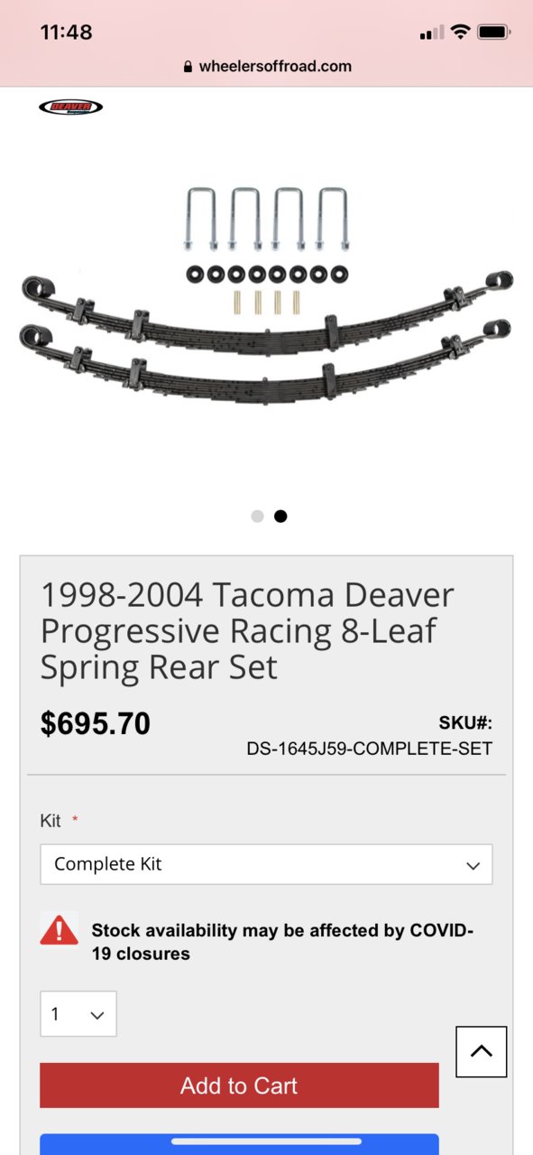

    Yeah that's where I am ordering from but for some reason its $695.70 if you buy it as the "kit" but if you add "just the springs" and then the Energy bushings and u bolts into the cart separately it only comes to $648.76, so you save $50 by adding the parts into the cart yourself... I just need to know what the u bolt length is, I have everything else in the cart ready to order...

    just fyi a lift up front won't solve your rubbing issues, I mean it might while you're driving around town, but any time the suspension cycles up/down it will still rub. If you do any offroading you'll notice fast.
    Is the tire rubbing the pinch weld on the cab or is it rubbing the frame when turning?
    Those TRD wheels are known to cause rubbing issues on 1st gens because the spacing on them isn't ideal for our trucks
    Usually to avoid rub you have to flatten or cut the pinch weld back. More caster via the lower arms helps too but there's only so much of that you can achieve with stock suspension

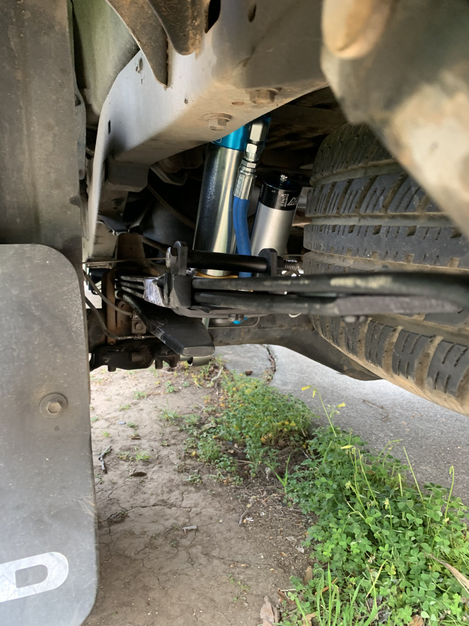

    I have a Leer cap on my v6 dc 4x4. I installed the Wheeler's 3(?) added leaf spring kit. However, I kept the overload spring. About 1-1/2" lift. Maybe a touch more. I've been very happy with ride loaded or unloaded. At some point it's still a bouncy pickup. As far as rubbing, I have the 4Runner 5-star rims and have 235/85/16 BFG KO2's. They don't rub at all. They are a bit squishy on freeway onramps. Load range E so they handle the weight. I use OME 881's on Bilstein 5100 at the lowest setting. 5100's out back as well. If I found myself carrying more weight regularly, I'd try the airbag route first.

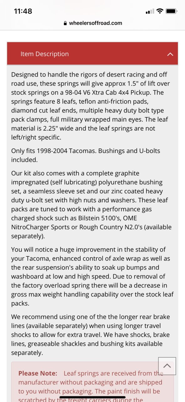

  19. May 12, 2021 at 12:18 AM
    #19
    MetalMan66
    MetalMan66 [OP] Member
    Apr 25, 2021
    #363794
    22
    2004 PreRunner
    I'm not going to buy the "kit" because it's $50 more buying it that way than just buying the parts individually for some reason. Not sure why that is you'd think it would be the same but if you put the items in your cart by themselves it comes out to be $50 cheaper and that's half of one of my shocks, LOL

    It's a prerunner and I don't off road at all. As long as it doesn't rub going in and out of my driveway I'll be good... it doesn't rub at all when normally driving unless I do a u turn or backing out of the driveway and turning the wheel a lot...
    It does rub the frame but that's only lock to lock. Most the the rubbing is on the plastic behind the wheel, I posted pics above...
