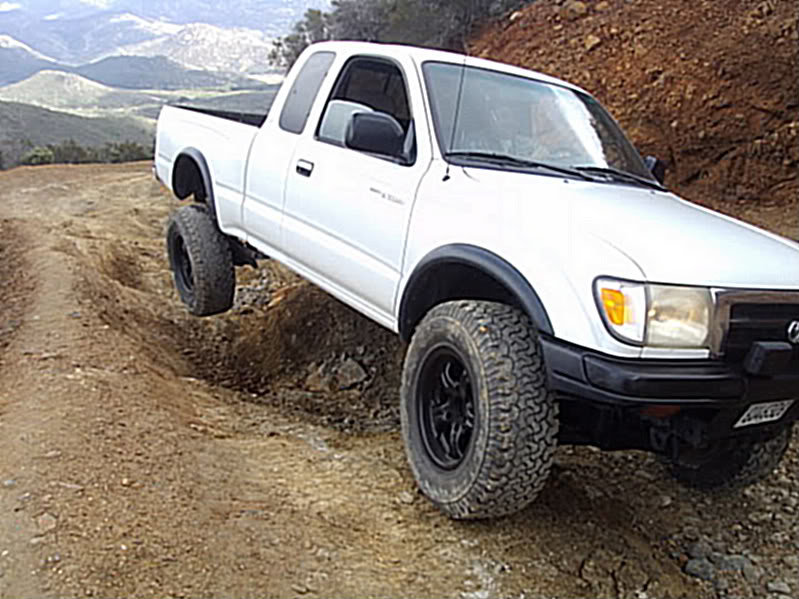

    Not a great pic but this is member's (taco_me_Elmo) 1st gen. I did right before this last weekends desert run to Superstition mnts.
    I added 2 cut & groomed Chevy 1 ton S-10 leafs per side, these were added to his stock 3 leaf springs, dumping the overload. He gained 3" of lift & major improvement in on/off road ride......

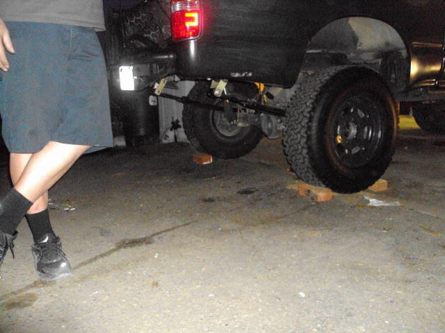

    Matt (Recklesstaco) has been running some of my rebuilts for about a year now with no issues.....
    this was this past weekend....
