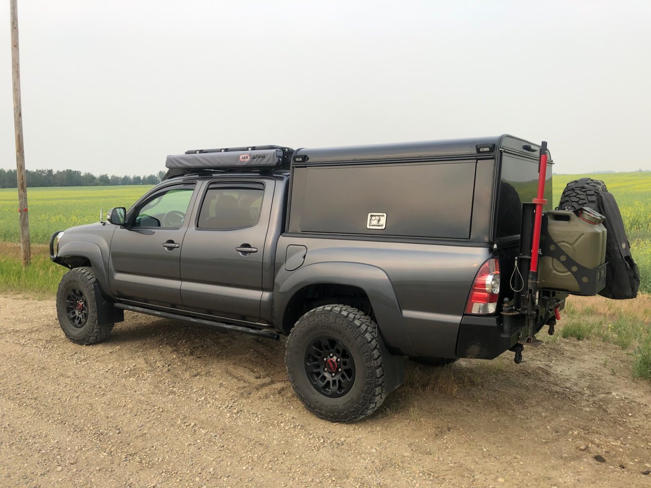

    Regarding the thread, I switched to Icon RXTs a little over a year ago. Couldn't be happier. Started on Option 1 when the truck was mostly stock. Upgraded to Option 2 when I realized 1 was too soft for my RTT and bed rack when mounted. Now i'm on Option 3 as I've added a rear plate bumper with swingouts and carry my spare tire all the time.
    The ride is perfectly manageable when i just have the bedrack on with no tent or spare tire. Ride is great when I have the tent on and a full camping load in the bed. Very happy with my purchase and the ability to change out the springs based on weight. I just leave it on Option 3 all the time now.
