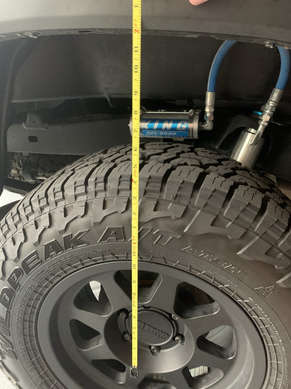

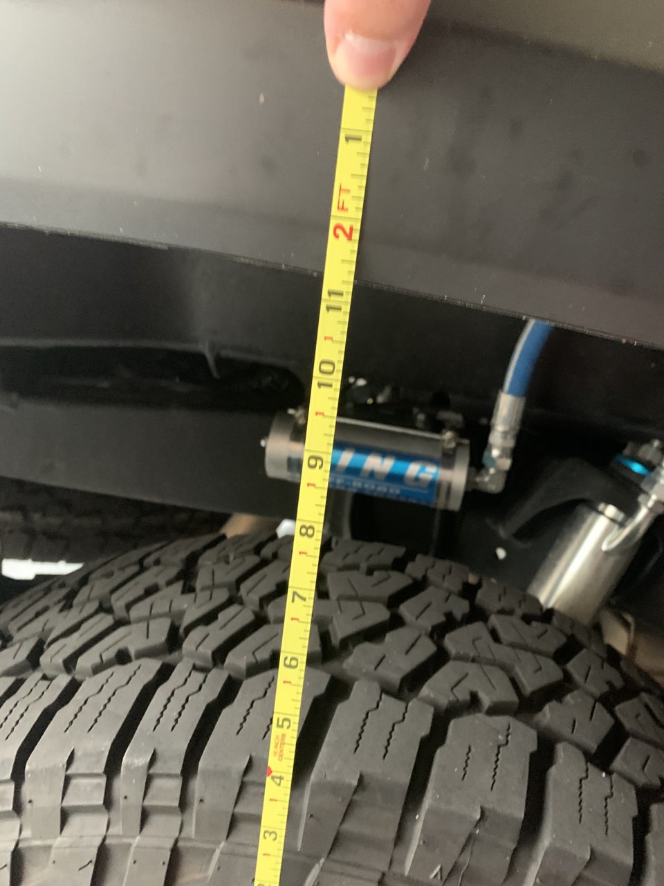

    I’m not sure what the first measurement was but right now they are about 23” center of hub to fender.

    the second photo I think I missed the center of the hub on.
    keep in mind when I say I don’t haul anything I mean it... the longest I’ve done is about a 100 lb bench for 20 miles or 200 lbs of lumber for about 5 miles. Other than that, nothing.

    That’s 1” of lift from stock 22”
    Fronts sit at 21” stock
