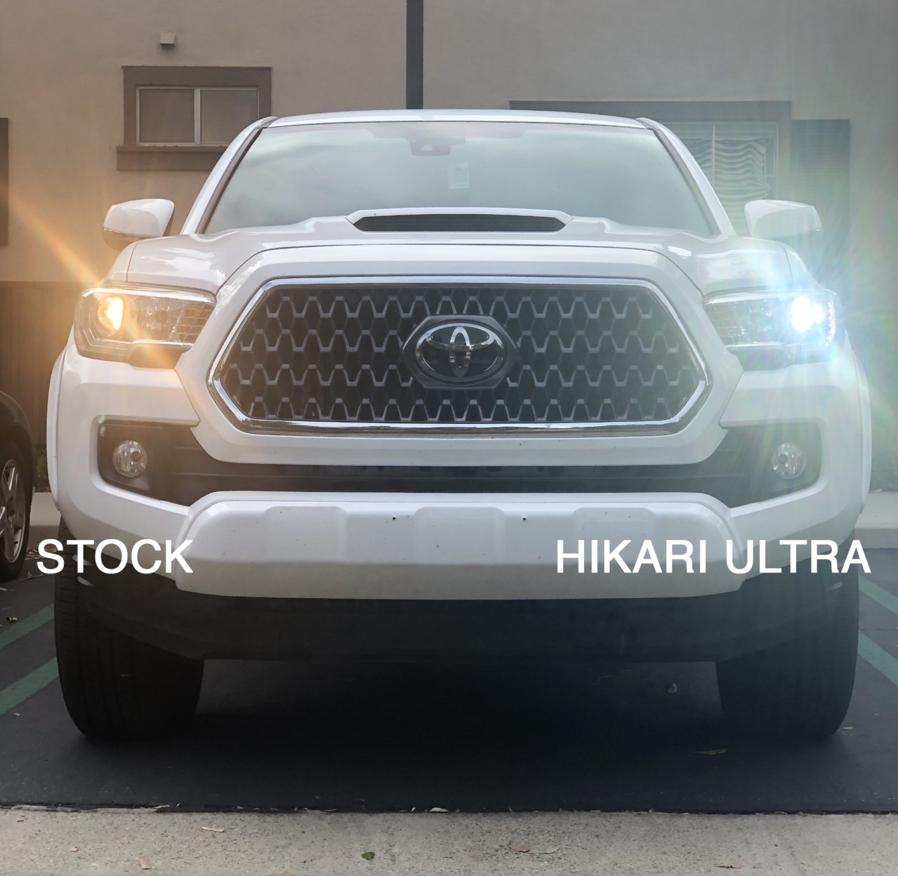

    Just picked up a set of Hikari Ultra's and really like them on my low beams. So much so, I went ahead and bought 2 more sets, Hikari 2020 LED's for my fogs and high beams that's supposed to be the bee's knees. I'm going to see how the 2020 versions do and will put the best 2 of the 3 sets on my low beams and fogs while my high beams will be the lesser of the 3. Great value for the money in my opinion. I'm a professional photographer and like to think I have a good eye, and happily will say these appear to be an improvement over stock.

    The ‘newer’ Hikaris are not well designed like the Ultras. They will lack focus, which is everything in a headlight. I would not recommend them. See the Hikari review in the link above as to why the Ultras perform so well, and you’ll realize the ‘new’ ones lack the critical design features.

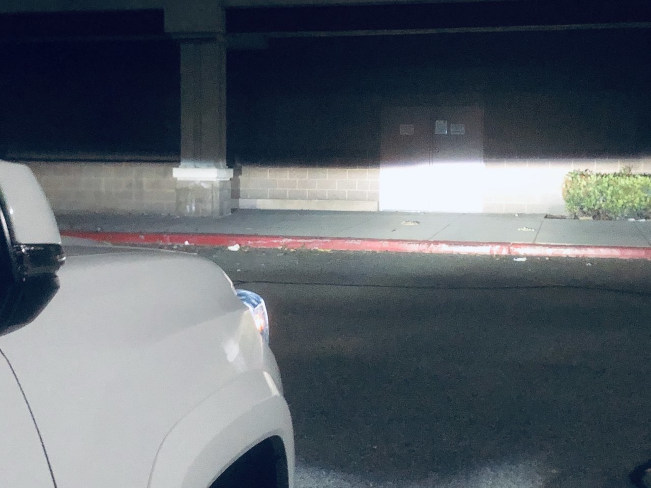

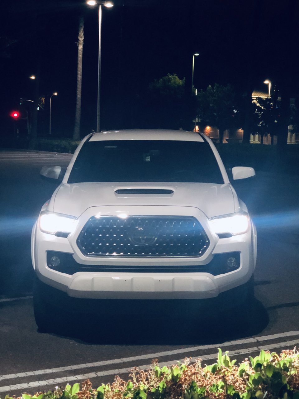

    Got all 3 Hikari Ultra LED's on my 2019.
    Pic #1 = Low Beams + Fogs
    Pic #2 = Low Beams + High Beams
    Pic #3 = Low Beams only

    Note that drop in LEDs are not recommended in the reflector fogs as they produce illegal and blinding levels of glare. This isn’t an issue I. The projector headlight due to the projector light shield. Instead a replacement SAE assembly designed for the LED light source should be used, which has appropriate cut offs, is street legal, and higher output. All the SAE Tacoma fogs are covered in the thread below. I highly recommend the Diode Dynamics SS3s linked at the top:

    Correct, not recommended in fogs for road use since they are not projector lens, but for off-road these will be great!
